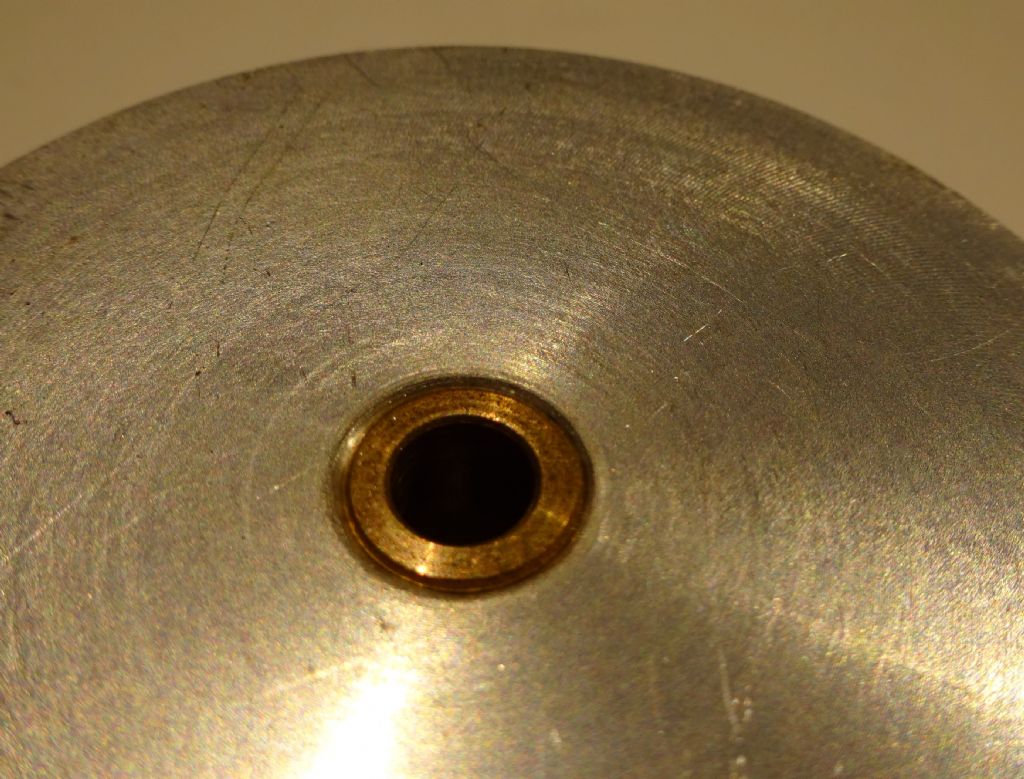

      Original cast iron bearing 12mm o/d by 25mm long by 6mm bore wore down so replaced with Bronze
      Lasted three weeks so made a new one in cast iron as was originally.
      Three weeks later that needs replacing.
      Shaft is mild steel 6mm o/d and smooth and concentric.
      Holes in bearings were reamed 6mm and pulley spun nicely but for some reason bearings just do not last.
      Lathe gets about 2 hours use per week.
      Going wrong somewhere – advice please.
      Thanks
      BB

          Have you thought of replacing with rolling bearings? Arc have some nice low-profile needle roller bearings that are quite easy to fit.

            At 12mm o/d and 6mm bore, it should be practical to replace the plain bushes with ball bearings. [use two pairs]

              Strange, My one is still on its original bearings and shows no wear and I can't say I ever remember lubricating it there. Does not get used much now but got heavily used when it was my only lathe.
              Have you got the right length belts on it as too small a belt may be putting undue loads onto the shaft

                Using the orange poly belts as sold on ebay for the unimat 3
                They do not seem over tight – that was my first thought.
                As suggested I will go with the bearing suggestions.
                Michael – many thanks for the link – will get ordered.

                  Just whipped my pulley off (original Austrian machine) and the bearings are Oilite ones so may be worth getting a couple of those and hope the other metals have not worn your shaft.
                  EDIT, these are 10mm OD and there are two of them probably about 8mm wide so either your far eastern one had a different spec or  aprevious owner has been "improving" it
