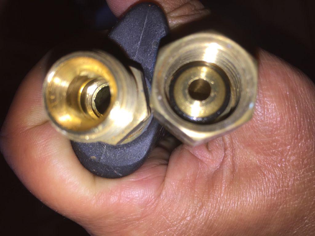

        I want to make an adaptor to connect a gas torch which is designed for use with disposable gas cannisters ( 7/16 x 28 UNEF female thread) to a standard propane cylinder which has a 3/8 BSP union on the end of the hose. I can do the UNEF end OK, but I'm worried about the BSP end: here is a pic of the fitting alongside a torch which it fits:
        What I need to replicate is the 'receiver' on the left. It seems that the geometry of the internal cone must be quite critical to ensure a gas tight seal with the O ring on the right. So to my question – is this a standard fitting for which there are specs somewhere? I've drawn a blank so far, perhaps because I don't know the right terms.
        Thanks for any pointers, Robin

          Assuming we're talking about the internal chamfer at the top of the item on the left it doesn't look critical to me. Provided you've got the same sort of angle (looks about 45 degrees) and you've got the same internal bore I'd have thought it would be fine. Presumably the connection is after the regulator on the propane bottle, so quite low pressure.

              The only thing i could find was a 3/8 flare fitting that has a cone angle of 90 deg included so maybe chuck up some scrap alloy and cut a 45 deg chamfer then use it to check the angle by putting some blue or sharpie on the seat and lap them together , if it smears most of the ink on the seat i think it will be close enough .

                To the best of my knowledge the receiving taper is 60 deg included angle. I've used standard (steel) hydraulic adaptors to cobble together gas lines using this style of fitting. The old fashioned ones didn't have an O ring, they just relied on a metal to metal seal, and the male part was radiused, so I guess the angle of the socket they fitted to didn't matter much. With the new "leak proof" fittings with an O ring, make the receiving taper 60 deg then ink the O ring. You'll soon see if it is sealing on the O ring or on the metal. Don't forget to clean the O ring before passing gas through the fitting.
                And Les is quite right, the flammable gas connection should normally be left hand thread. The external hexagon usually has a groove cut in it around the periphery to tell you to undo it the other way (the other right hand). Standard agricultural (hydraulic) fittings are right hand so probably no use except as a pattern for the taper.

                  Thanks for suggestions – experiments along the lines suggested using micrometer blue (I always forget how handy the stuff can be!) reveal that the female 'cone' is in fact slightly concave, so no chance of me replicating it exactly without going to silly lengths. I think the dimensions must be quite critical – the O ring on the male part has to seal before the carrier bottoms out in the cone, but not squash too much.
                  It'll be far easier just to go with good old-fashioned serrated tails, pressure tubing and clips like wot we used in the Chemistry labs.

                    Yes, I recall seeing a spherical face to the connection for my blowlamp to the regulator on the Propane cylinder.
                    Even if the faces are not an exact match (producing a long leakage path) the line contact from an inexact match would produce such pressure that the two metals deform slightly to produce a seal. And Brass is relatively soft.

                        The taper on the torch 'can' or could be used with olives or more in the case of high pressure air a conical stud goes in to that taper tightened by a floating nut to pull the two assemblies together.
                        On the right piccy looks like an o ring set below a shallow conical stud like thing, may seal on the left piccy taper at the start only or on the thin front face, just make the thread fractionally longer so it dont bottom out. Just test for leak, you will feel an o ring compress.
                        If you can remove or slide the female right piccy thread down to expose the o ring you can then test for fitment. You could even have the o ring seal up on a recessed shoulder allowing clearance on the bore for the conical stud.

                                I think you will find that on the taper fittings that the male and female angles are slightly different to ensure a line seat type of seal which is far more reliable that trying to match in (blue) the tapers.
