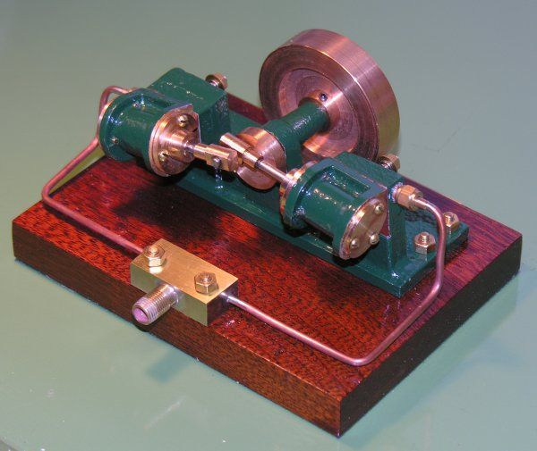

                      Even more simply one can use a bicycle pump for a quick demonstration. The speed is a bit erratic when pumping, but it works!
                      I used a schraeder valve body for the air connector on my Reeves Master HO. So the model is easily connected to a compressor, or a bike pump.

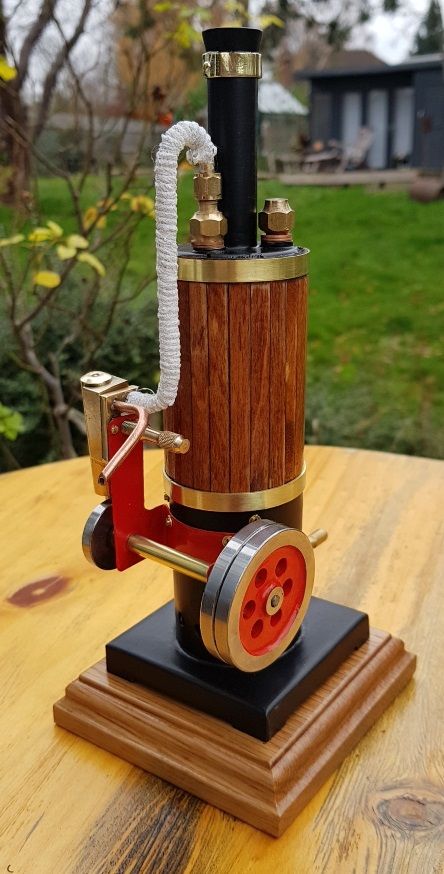

                                I'm not sure where you are based, but you could do a lot worse than to sign up for the Society of Model & Experimental Engineers' 'Polly' course, starting in May (in South London).
                                You will end up marvellous little vertical boiler & wobbler engine, plus get a great grounding in a wide range of model engineering techniques.
                                The ability to ask questions & get feedback on on you progress – plus getting your boiler properly pressure tested – is invaluable. You can't get that from books & videos
                                P.
                                Full disclosure: I built this on the course last year…

                                  Thanks Paul that looks stunning.
