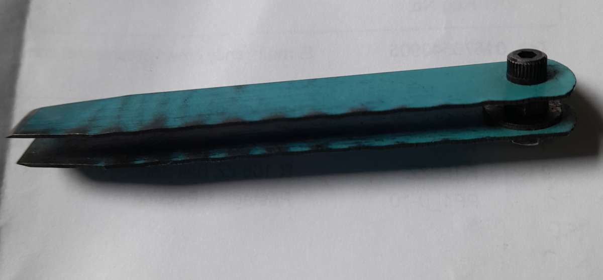

            I usually make my own from broken/ worn out HSS hacksaw blades, use the ends with the holes in bolt together with a spcer between and grind to whatever shape you want.

            Andrew Crow
              @andrewcrow91475
              Not sure this will work, inserting photos is not my thing😅
              20250505_131858

                Andy Crow, that’s a fine idea – thanks very much, and especially for taking the trouble to upload the picture!

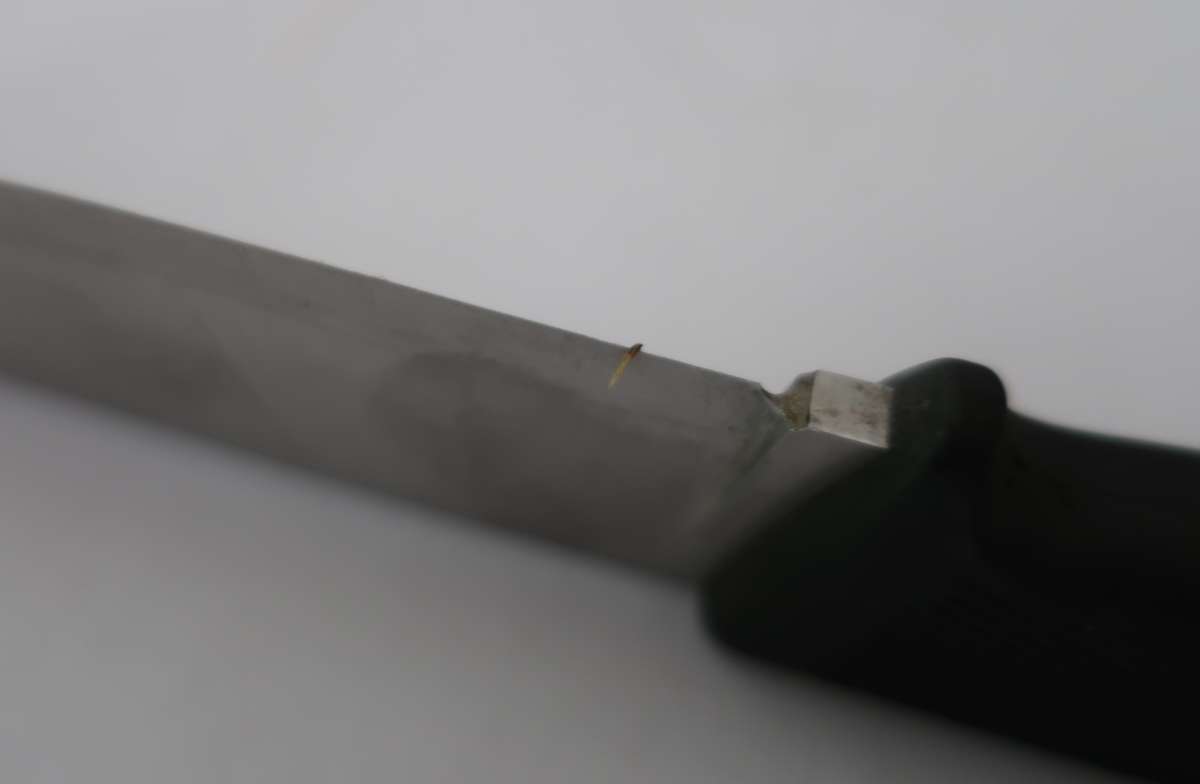

                          Hi Diogenes,
                          I used to work in a fibreglass factory and would quite often get fibres embedded in my hand. I found the most effective way of getting them out was to get a scalpel positioned at 90 degrees to my hand and drag it across the embedded fibre. You may need to do it a few times. Press firmly but not too hard and ensure you only drag across the blade – not along it. Works for metal splinters as well. I suppose a razor blade would work as well.

                          Diogenes
                            @diogenes
                            Take a bow, Alan.. ..got it with my work knife – and yes it is, very..
                            IMG_2623
