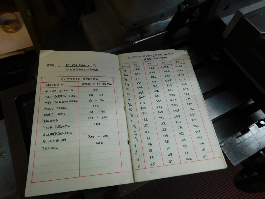

                          William / Derek – when I began machining at home I had absolutely no concept of cutting speeds or feeds. I think I may have mentioned before I watched with rapidly increasing alarm as the tool began to glow red hot when trying to machine a Stuart Compound cylinder block. This was circa 1972/3. Trying to cut a thread on silver steel was also an eye opening experience!
                          Around 1980 I trained as a milling machinist and the first thing I learnt about was the cutting speeds of various metals – it really was a 'light going on moment'. No 'charts' were provided but a basic list of average cutting speeds to work from.
                          Though I have several companies reference booklets collected at work over the years they are never referred to – I still work either side of the parameters of that list with a simple calculation
                          RPM = Cutting Speed x 4 / Diameter of Cutter which is a simplification of Cutting Speed x 12/Diameter of Cutter x Pi
                          The list is based on using HSS tooling and works either way from Mild Steel which has a basic speed of 100 ft per min. eg a 1/2" cutter on MS is average 800 rpm.
                          That's a ball park figure from which to work either side of depending on the actual steel being machined and machine capabilities.
                          Here's an image from the little pocket book I wrote down in 1980 – I still have it and it still sees occasional use to this day
                          The only time I have ever had need to adhere to manufacturers specified speeds and feed information was when using carbides tooling on large machines and on a CNC machining centre – to me, for ME home use, these simply mislead the average guy at home with limited experience to call on.
                          The above has served me well for over 40 odd years. It's basic but it works – hope it's of use to you too
