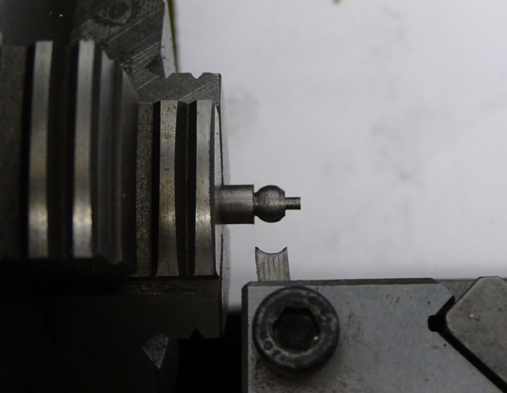

                              Don't know if it really needs any jigs for a second op.
                              -Face stock and form one of the 1.6mm spigots and thread
                              Form tool 4mm wide to shape shere
                              Remove from lathe and holding by rest of the stock drill and tap M2 hole
                              Back into lathe, cut other 1.6mm spigot with parting tool then part off
                              Thread the remaining spigot M1.6 by hand, easier to hole diestock still and rotate the part by hand, M1.6 onto brass does not need much effort. Or could put a M2 screw into the cross hole to give a bit more to get hold of.
                              Edited By JasonB on 10/10/2017 09:41:49

                                    The ball will be easy to do with a form tool, just like this bigger one.
                                    Put the M2 hole in while still on the parent stock and it will be easy to hold so Hole will be perpendicular
                                    J

                                          Emgee, If you look at my post @9.40 I suggested doing the ball before cutting the 1.6mm dia nearer the chuck. This woul dleave the ball supported on a 3mm dia shaft which I think would be OK. If not simple female ctr on the 1.6mm dia would help.
                                          I did not use end support when I did the 9/16" dia ones in the photos as I did not want a hole where the valve spout was going.
                                          James, it was mentioned above about making the form tool by drilling a hole in some gauge plate, this pic shows such a hole and my marking out for the rest of the shape, may make it clearer for you to see how the tool is knocked up.

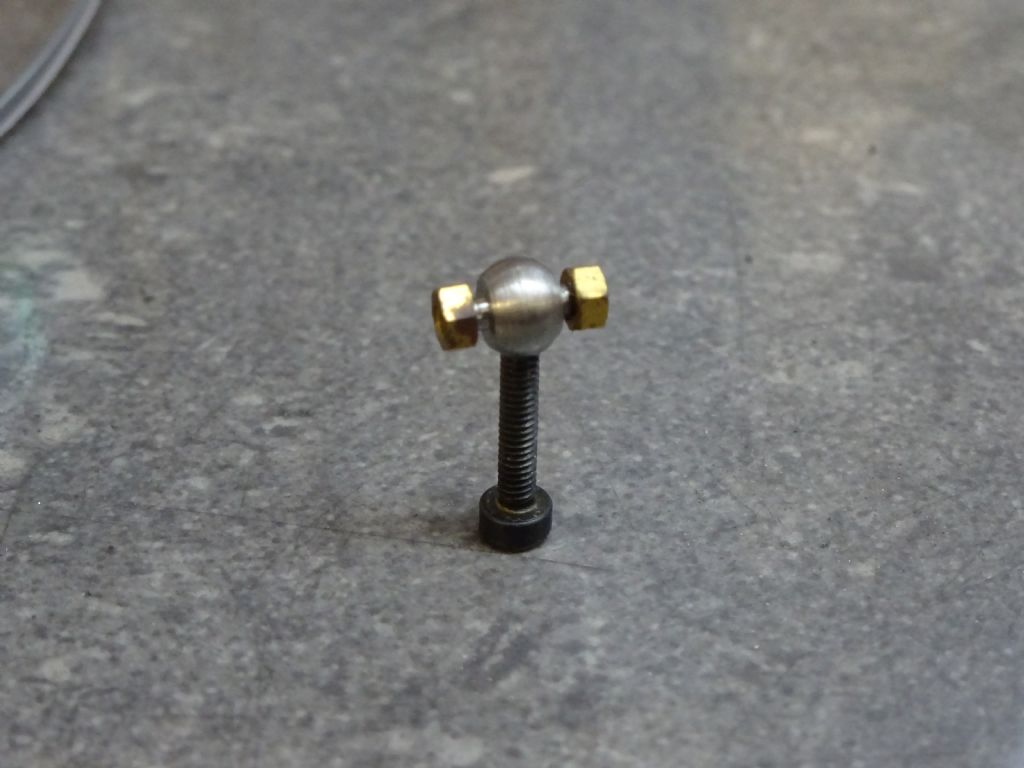

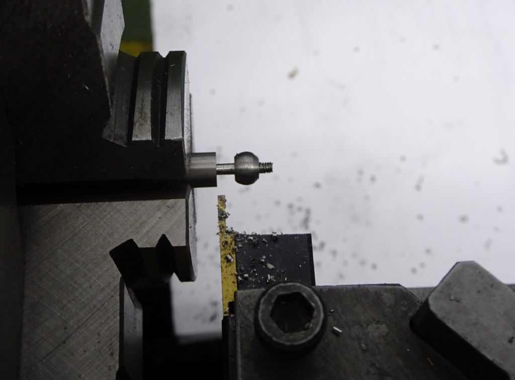

                                                    As Wednesday is shed night and curiosity had got the better of me I thought I would see if the machining sequence I posted earlier would work, nothing too exact but enough to prove the method also as Andrew had got me thinking about how a form tool would work on stainless decided to use that rather than easy brass.
                                                    Took a 4mm Sq HSS tool blank and tickled the end with a Dremel chain saw grinding bit and offered up the shank of a 5mm drill to eyeball the profile, not top rake.
                                                    Put a bit of 5mm 303 stainless in the 3-jaw as that was on the lathe, turned the 1.6mm dia spigot and then went straight in with the form tool, dry, about 300rpm, mounted at a slight angle means no side clearance needed and the profile was a bit wonky anyway so best not mounted at right angles.

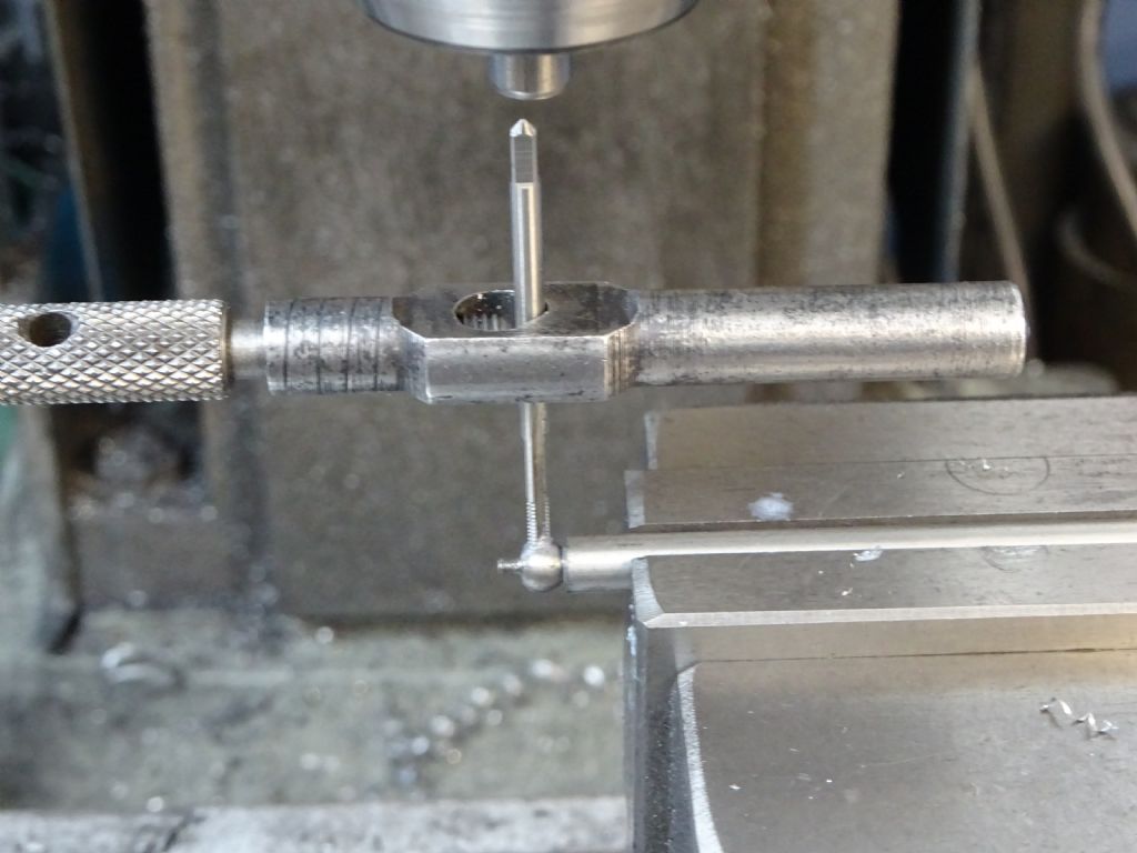

                                                    Threaded the end and then over to the mill to drill and tap M2, should have spent a bit more time centering up and spotted deeper as drill wandered a bit but it will do for this purpose.
                                                    back in the lathe and used a parting tool to form the other 1.6mm dia and then parted off, took a bit off the side of the ball but hay ho.

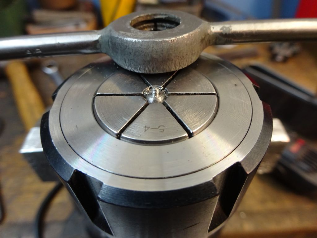

                                                    held in an ER block to thread the other side
                                                    Job done but I did resort to R/H threads both sides as I don't have a L/H M1.6 die. Easy to thread and tap, easy to form the ball. If it were a paying job a bit more time getting the form tool right, drilling centrally and using correct threads and they could be made quite easily.
