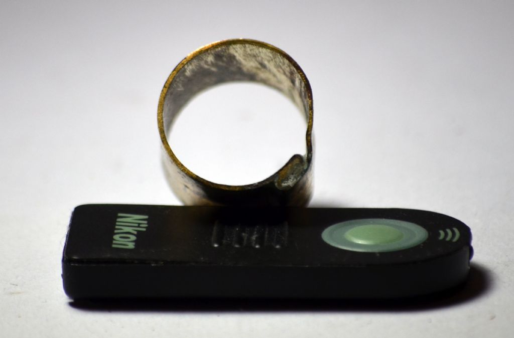

        I'm now looking at doing boilers for my growing collection of wobblers.
        I have Tubal Cain's engine books vol 1 and 2 and have been practising making tubes and silver soldering etc ready to make the boiler from Polly.
        Is there any way of getting the seam inside the tube?
        I would like to clad in wood so could do with a smoother joint. Or should I take the easy route and use a pipe?
        If I used a 54mm pipe 1.2mm thick what thickness end plate would you recommend?

        #396376
        Ian S C
          @iansc
          I'v made 3 or 4 little pot boilers, i flattened out a piece of the tube used for the boiler, then formed a flange on that, and silver soldered it into the boiler with a single stay through the centre made of 1/8th inch bronze brazing wire. It all started with the local High School having a night class with a little steam engine as the project (Mamod style).
          Ian S C

            Keith Hale
              @keithhale68713
              Or…
              Form the tube from sheet and silver solder a strap inside and along the seam. Use a strap width of 6x it’s thickness.
              Easier to use seamless tube though!
              Keith.

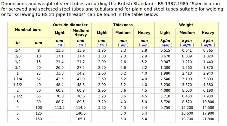

                          #396713
                            Posted by Paul Lousick on 15/02/2019 21:19:41:
                            I would recommend using tube for your boilers and not pipe. Pipe has a much heavier wall thickness and is measured by its nominal bore and not its outside diameter. Tube and Pipe are not the same. Tube is measured by its outside diameter.
                            Paul.
                            Paul's description is spot on for the USA, but is it true this side of the Atlantic? Those Americans might be more logical than us! In the UK I think:
                            • A pipe is just a type of tube.
                            • Pipes and tubes can be both used to transfer fluids and that makes no difference to what you call them.
                            • Although pipes are rarely structural and tubes are often structural, both can do either. Again, it doesn't decide what they're called.
                            • In the UK the technical difference between a pipe and a tube is that pipes are always round. Tubes can be of any cross-section, though they are mainly round.
                            British English provides many exceptions. The downpipes from my gutters are all box section, but they aren't called tubes. My junior school's climbing frame was made of steel water pipe and pipe connectors. In a Chemical Lab the thick-walled pipe used to connect burners and glasswear is called rubber tube. Pipes sort of imply bulk transfer, but then we have tube trains. Guns have barrels, but an artillery barrel will contain at least one tube. Electrical conduit is often just called 'conduit', but it's sometimes sold as 'conduit pipe' or 'conduit tube'.
                            I believe in the UK the terms 'pipe' and 'tube' are either interchangeable, or when one is preferred, it's been named informally rather than logically. For a non-standard use, you have to specify O/D, I/D and/or wall thickness to get the right size. Am I wrong?

                                M'lord, may I present some counter-examples to the jury.
                                Exhibit A – steel tubes specified by bore, and not called pipes:
                                Also, Exhibit B, BS EN 1220 'Plastics rainwater piping systems…' which measures pipe by O/D in mm, and doesn't refer to tubes.
                                That's two British Standards up the spout.
                                And to show the USA aren't completely innocent, their 4" Schedule 80 pipe is actually 4.5" O/D and 3.826" I/D
                                No wonder I'm dazed and confused!
