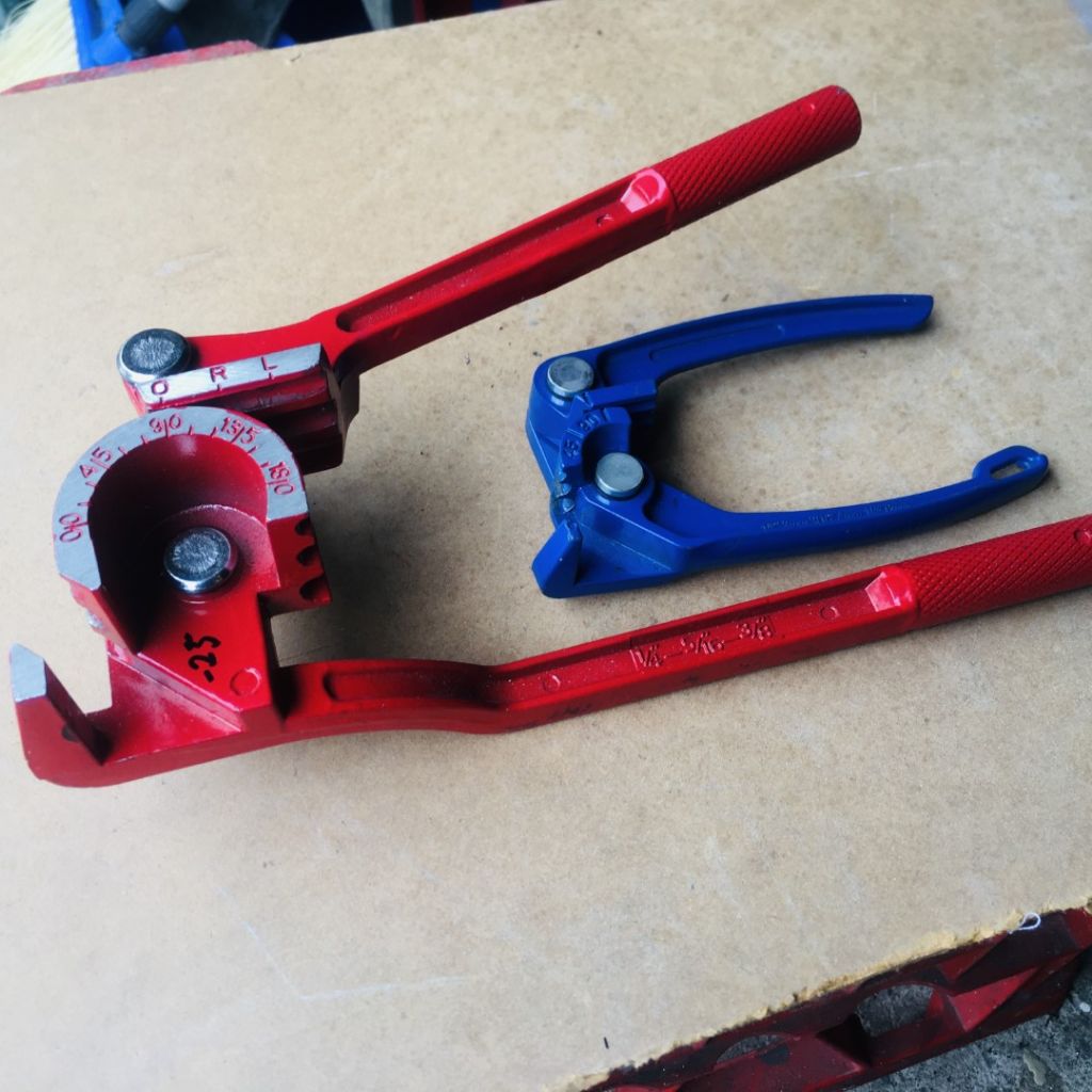

                  These are cheap benders from eBay and they work OK on copper tube. Important to anneal the tube before bending or it will kink and not produce a smooth bend.
                  The large bender is for 1/4", 5/16" & 3/8" OD tube with a bend radius to the centre of the tube of approx 1". Bend angle = 180 deg because of the offset handles.
                  The smaller bender is for 1/8", 3/16" & 1/4" OD tube with a bend radius to the centre of the tube of approx 5/8". Bend angle = 90 deg.

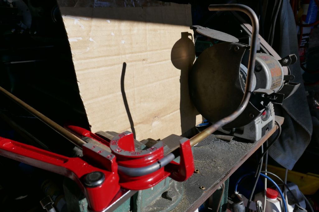

                      As Fizzy said, practice first to perfect the technique and to determine how much the tube stretches. Bending is one of the least accurate engineering processes. Shown here bending 5/16" tube with the fixed handle mounted in a vice.
                      p1010341.jpgheld i

                                            I have now augmented this by buying a pull-round bender like the blue one in Paul Lousick's photo (thank you Blackgates) for the 1/4" and below tubes, and a quick test on some off-cuts gave very pleasing results. I have not measured the ratio but it looks about 3:1 bend radius to tube diameter, which I have seen published as a safe minimum.
