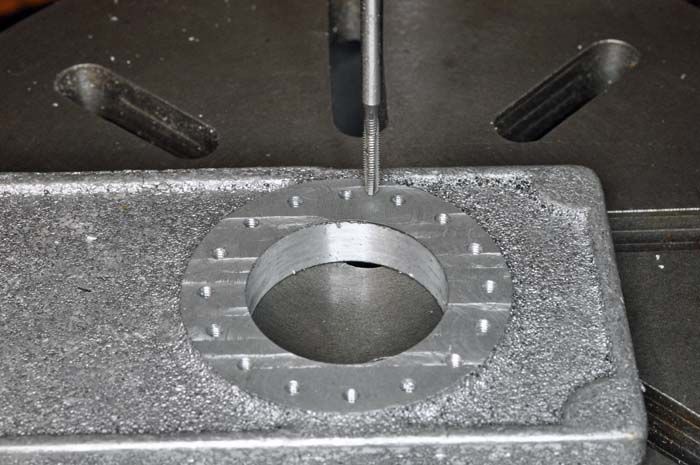

      Looking for an 8BA tap, I noticed that the only two I have are both broken with the end touched up. That's odd I thought the hole looks rather small. Checked and, yes number 50 is the drill Tubal Cain recommends in his Model Engineer's Handbook.
      It seemed to be rather tight, even in CI, even allowing for the re-worked end of the tap. looked closely at the table – why is there a much smaller gap between tapping drills for 8 and 9 BA than 7 and 8?
      Just looked in the Handbook and the size he recommends for 8BA is Number 50 or 1.85mm.
      But 1.85mm is number 49, number 50 is 1.78mm. Only 4% smaller, but presumably enough to explain why I break more 8BA taps than any other size
      So, never take anything for granted, even when it comes from the top!
      Hopefully the last seven 8BA holes will tap a bit easier.

                              Well No. 49 worked much better, so I'm amending my copy of TC's handbook and laminated card in my workshop.

                                          Machinery's Screw Thread Book has for 8BA:
                                          1.70 (96%), 1.75 (87%), 1.80 (77%)
                                          No 50 is about half way between 1.8 and 1.75
                                          I have always taken the view that a deep thread can get away with a smaller %age engagement, although I remember reading somewhere that the first three threads do all the work …
                                          Cheers, Tim

                                                    Perhaps I should have been clearer- Tubal Cain championed using ~60% engagement and his table gives drill sizes for that.
                                                    Unfortunately although the size in mm for 8VBA is correct, he gives the wrong number drill.
