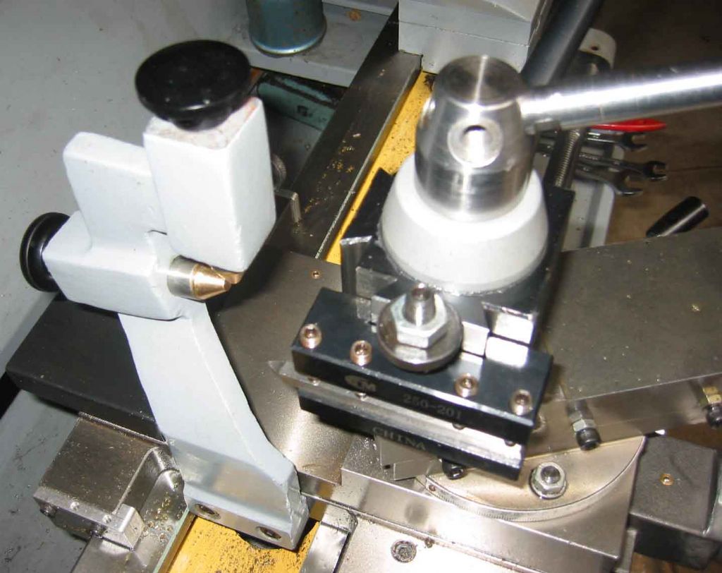

      Hope someone can help.
      I have “upgraded” to an asian lathe which came with fixed & travelling steadies. My next project needs leadscrews, which obviously require the travelling steady. My problem is, how do I line up the cutting tool with the fingers?
      Harold Halls excellent article simply says “use the compound slide”.
      When I rotate the compound to the 29.5 deg angle this is not an option. Even worse, I have replaced the 4way toolpost with a quickchange one, This results in the steady fingers being about 50mm behind the tool.
      I am about to make a new steady, have I missed something?

              I found a page which shows what the compound slide arrangement should look like – scroll down to about the 6th to 8th pictures:
              #65229
              Geoff Causon
                @geoffcauson89285

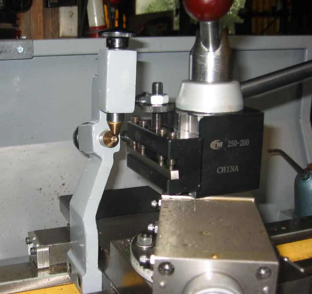

                Thanks for your help. Photos’ attached will explain better.
                I tried swinging the compound to the left as Steve suggested & the tool lines up perfectly at 30 deg & is 6mm ahead of the fingers at 15 deg.
                I have never cut a thread backwards before but it should work ok. In fact, it means I can run the tool off the part at the tailstock end. This will be good for my heart rate as disengaging the half nuts before crashing into the shoulder at the headstock end is always exciting.
                I guess if I want to use the steady for parallel turning I can swing the compound to line up the tool. It would not be possible to have the fingers lead the tool, but I doubt I would ever need that.
                Re: 29.5 deg;
                We both mean the same thing. My 29.5 deg is after swinging the compound 90 deg, then back 29.5. ( or now an extra 29.5)

                  it is more normal to set the angle of the top slide the other side of the 90 degree mark to allow a forward feed of the tool. Your toolpost could be rotated and effectively reversed.
                  Also would it not be possible to insert a spacer block between the steady and the body of the slide to move it further forward
                  Just a couple of observations

                    If you are going to parallel turn with a travelling steady then the fingers must lead the tool for the following reasons.
                    a. It is almost impossible to set the fingers to trail the tool
                    b. If set to line up with the tool the burr thrown up by the tool will tear the fingers to pieces and make them useless. The same applies to screwcutting.
                    I think Terry’s idea of a spacer is the most practical.

                      Terry, in Geoff’s pictures he seems to have shown the compound offset in both directions! But if, as he says, he is cutting reverse threads then wouldn’t the unconventional offset be the correct one in terms of advancing (or is it retarding?) the cut?
                      As well as the things Dusty mentions, the other problem with using a steady in line with the cut is that to all intents and purposes, the steady doesn’t steady the work any more, because it is at that point that the work’s diameter is changing – and the steady loses contact with it.

                              Hi Geoff, I think I’d do what Terry suggests and try a spacer to pack your steady forward. That way you wont have to much more expense. Shouldn’t take to much to make, but you may need longer screws of course.

                                Hi Geoff, also if it is setup like your secound picture and run towards the tail stock, like Kwil says you will have a lefthand thread, unless you turn your tool upside down and reverse the direction of the spindle.

                                      Hi Terry and Steve, in Geoff’s post with the photos, part of what he says; “I can run the tool off the part at the tailstock end” that’s why I think he may go from left to right, because he goes on to say about it being good for his heart, because he sounds anxious about disengaging moving towards the headstock.
                                      I wonder if Geoff realises he will cut a LH thread going towards the tailstock with the spindle in the foward direction.

                                        Embarassingly, I was so focused on the LH part I missed what you all saw. With the compound angled to the left I can only make LH threads but I also need RH parts.
                                        I guess I am back where I started.
                                        The problem seems to be the large offset toward the tailstock on the steady casting, as all the pictures I see of steadies show approximately “straight” castings.
                                        I can use the existing steady for the LH parts, & will need to make a “straighter” body for the RH parts.
                                        Obviously, summarising the collective wisdom above, the new steady also needs to let the fingers lead the tool if turning parallel. It almost needs to be adjustable .
                                        Thanks everyone for your help.
