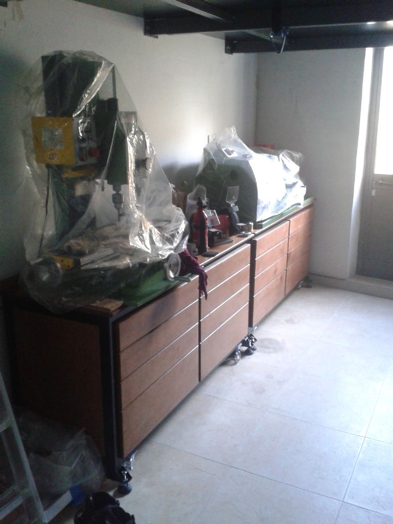

                                                  Well back from my caravanning break and after some thought I am going to do the following.O rdered a 2 ton rated Chinese block and tackle of Amazon. Better than eBay I got 30% off .
                                                  Paid for a carrier and it is due Wednesday or Thursday. Freebie carriage was Friday or Monday.
                                                  I have a scaffold tower which I can erect two stages high around it. Four scaffold planks doubled up with a gorilla bar across for the hook will enable me to lift it off the pallet and slide my trolley underneath. I can then move it to the rear of the house and the workshop. Once in the workshop I will decide on whether to dismantle or not.
                                                  Main problem is although I can lift it high enough in front of the bench I then have to move it forwards a couple of feet to get it on the bench. Taking the bench out first and refitting the bench afterwoods under the hoisted mill is an option but would be difficult because of space

                                                    Well weather looked hopefully today so I unpacked the pallet so I could have a look. Managed to remove the head on my own quite easily. Took the x-axis table off and the y-axis just left with the column and base. To heavy on it's own but reinforcements are coming after tea tonght. Once it's in the workshop I can decrease while I'm waiting for the hoist to arrive and reassemble over the weekend…
                                                    Incidentally now it's unpacked I can measure the distance from the top of the mill to the roof and it's 30mm

                                                      That's tight! Good job it wasn't any closer or you'd be having real fun and games!
                                                      Is it that near the ceiling because it's going on a bench? I've got mine on a Warco cabinet which is only 730mm high. If the mill was at workbench height I'd have trouble reaching the Z wheel to raise and lower the head. Barefoot I'm just under 6' tall. I mention it just in case. Very frustrating to huff and puff heavy equipment into position only to find you have to move it again. Don't ask me how I know…
