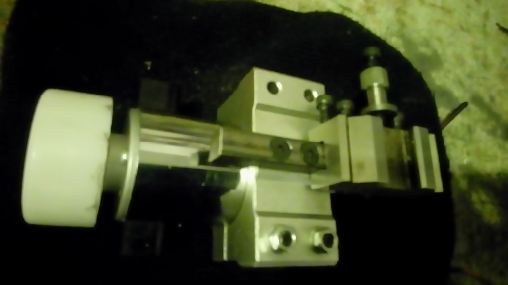

        john halfpenny
          @johnhalfpenny52803
          You could make a simple holder for a Dremel, like this:

            Nick Wheeler
              @nickwheeler
              I bought a very similar tool to David, and fitted it to the vertical slide:
              which allows all sorts of adjustments, even with the motor turning. But it is a bit off a nuisance to set up, so it spends most of its time in a QCTP holder:
              which I did by bolting a piece of 1/2" square bar to the clamp supplied. That slides in the slot in the holder, and the whole thing is ready to use just like any other tool.
              I mainly use it for the fluted knobs I prefer over knurled ones:
              but it also drills cross holes and off centre ones in the face of parts with no extra setting up or measuring. I do need a better way of headstock dividing than blocking the chuck jaws; an electronic dividing attachment off the spindle gear is the plan. That will make partial slots easy
