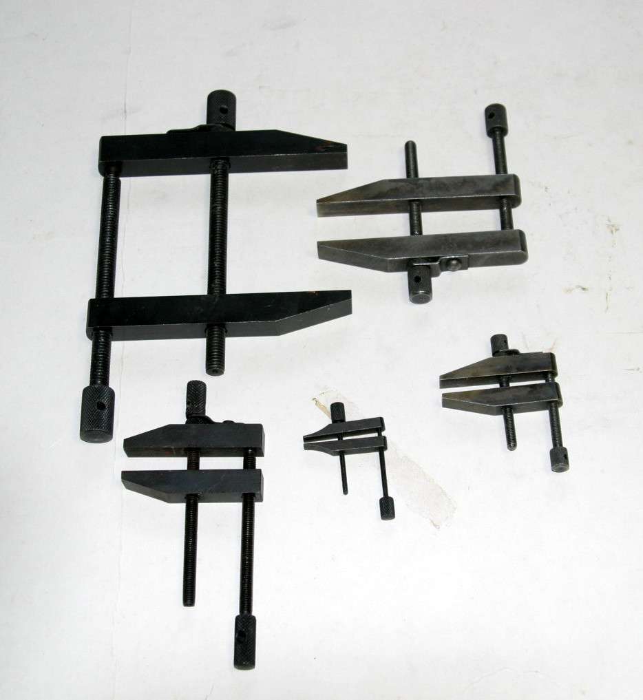

            As a retired toolmaker I have three diferent sizes of toolmakers clamps. They are invaluable holding parts to angle plates, Clamping flat plates for drilling and other holding jobs.
            20190327_122748
            David

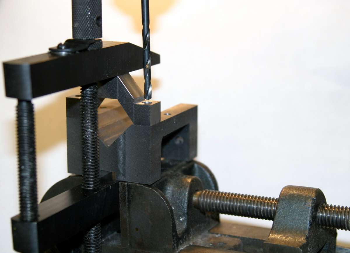

                            I’m with Andrew, I have close to 20, from 1″ to 6″ and I don’t know how I would get along without them. They get used all the time for clamping for drilling, or to angle plates, extra security while milling some jobs, holding items on the surface plate for marking out or measuring. I find the uses are endless.
                            JohnClamps

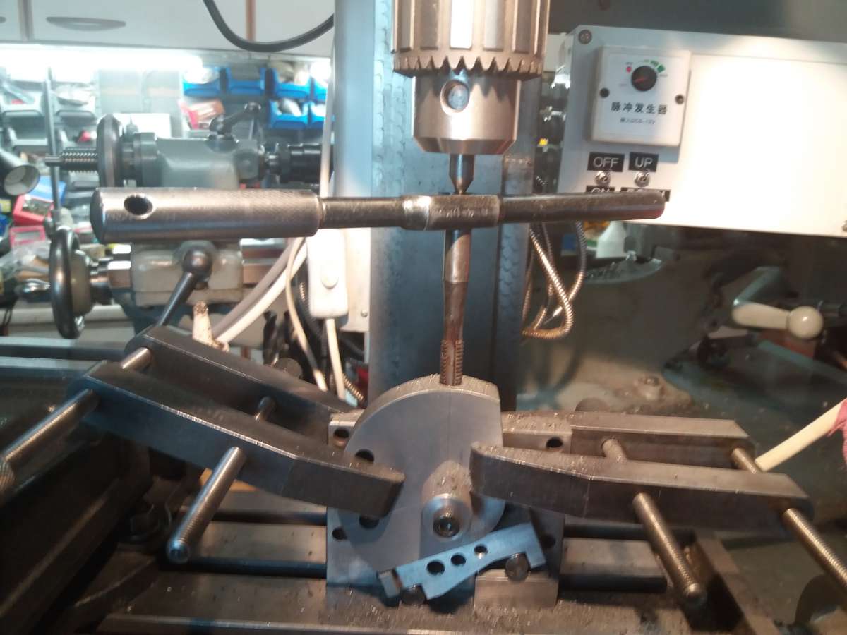

                                          Here’s a use of toolmakers clamps to securely hold two awkward shaped pieces in the correct registration for spotting through tapping holes into the lower piece. As an added bonus the square parallel lower jaw makes a convenient way to hold the assembly square in the drill press vice. If you first clamp the lower jaw in the vice slightly proud of the jaws, then positioning the two pieces correctly and clamping them is easy as the vice acts as a third hand. Once clamped in position the vice can be loosened and the whole assembly can be dropped down so the lower piece is sitting squarely on the vice jaw tops.
                                          Clamp

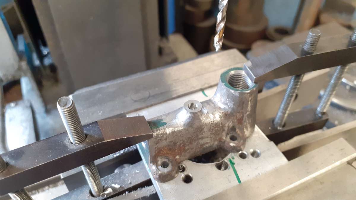

                                              Other advantage of toolmakers clamps over G-clamps is that they are relatively flat at the business end and won’t get in the way of a chuck.
                                              They can also grip right on their ends where as a G clap needs most of its end on teh work surface particularly the swivel end.
                                              Good example of both here holding this 50mm long casting so that the 4 holes in the feet can be drilled. G-clamps would stick up and hinder the chuck and also need to overlap the par a lot more.
                                              20230501_144726
