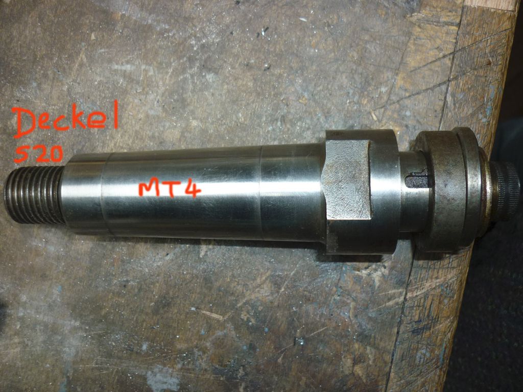

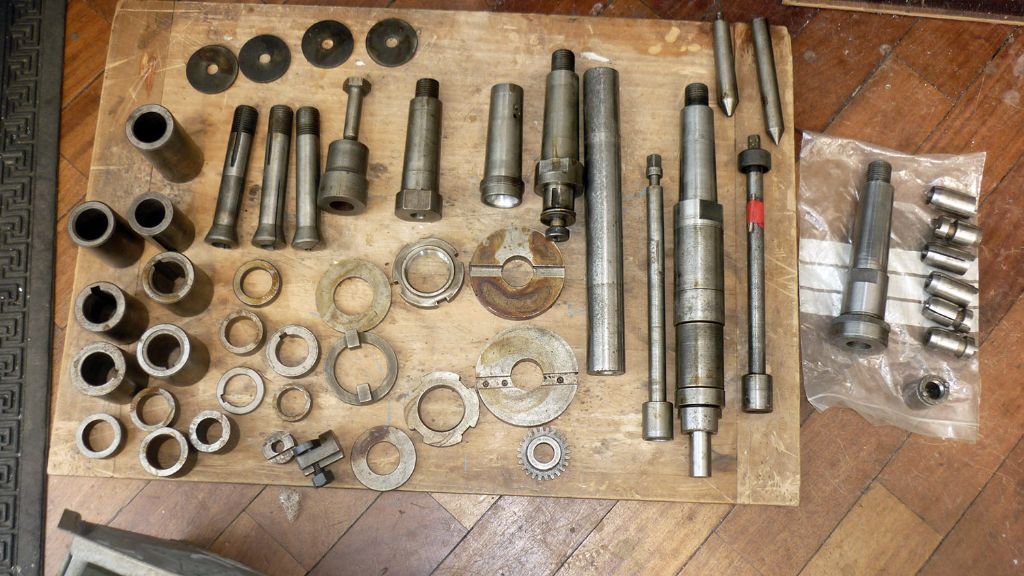

      Last year i refurbished a Alexander Toolmaker mill with MT$ spindle but haven`t had much spare time since ,but im looking for some sort of facemill .
      I didnt get much tooling with the mill ,a Clarkson autolock and 4 collets (up to 5/8" ) , 3 dedicated s20 collets 1/4.3/8 and 1/2" with spindle adapter. I  have also  ordered a  s20/ER 32  collet holder from german ebay only cause i have a full set of collets already.
      I did get this in the photo which looks like a slitting saw /shell mill arbor.
      What could i fit on the end of this or am i limited to old imperial HSS shell mills?
      Im really looking for something of around 3 " or around 80mm which will give a good finish on soft steels and occasionally aluminium. I am thoroughly confused by the vast array of tc facemill and inserts . I will also occasionally be milling very hard woods which i assume a hss shell mill would be better than carbide.
      Any suggestions !

      This is all the tooling i got with the mill.

          Do you have an overarm for the horizontal function ? if so you need sde and face or face cutters with bore size to match the horizontal arbor in the picture, many cutter outside diameters are available, most need a lot of power if taking heavy cuts.

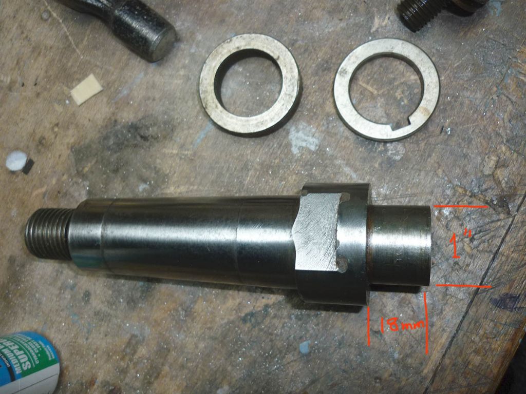

            Emgee, yes i have the overarm but im specifically interesting in the vertical milling at the moment as this is all ive done ,although on benchtop mills (chinese x2 variety and a tiny proxxon) . I need to fit a new bronze bush to the overarm bracket as its too worn to use.
            But to use a face mill do i need to buy another arbor with the two locating prongs , most appear to be metric sizes like 22mm or 27mm etc… location diameters . I just need any advice on the types with carbide inserts ,dont really want to but one cheap on ebay to find out later that the inserts cost an arm and a leg.

              For an insert type face mill I suggest one of two types: one using SE?? inserts and having a 45 deg. lead angle and/or one using APKT inserts having a 90 deg. lead angle. Inserts for both styles are available for steel or polished for aluminum. Both styles are pretty common and the inserts are reasonably priced. I recently purchased some APKT 1604 inserts from Banggood that were designed for aluminum. The finish they produced was beautiful. I got some SE?? inserts from Banggood designed for aluminum but have not tried them yet. ?? means I can't recall the last two letters of the insert code.
              The arbor shown in your first photo appears to be a standard milling arbor that was shortened. It is suitable for slitting saws or narrow plain milling cutters.
              I don't know if shell mill arbors are available to fit your spindle. If not, you could consider straight shank shell mill arbors held in a collet. You might also0 be able to modify the arbor shown in the first photo to add drive keys for a face mill.
