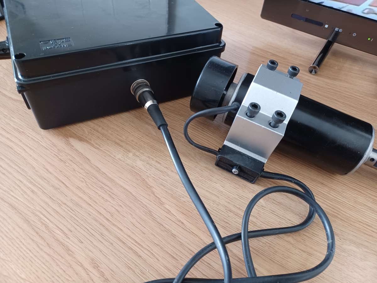

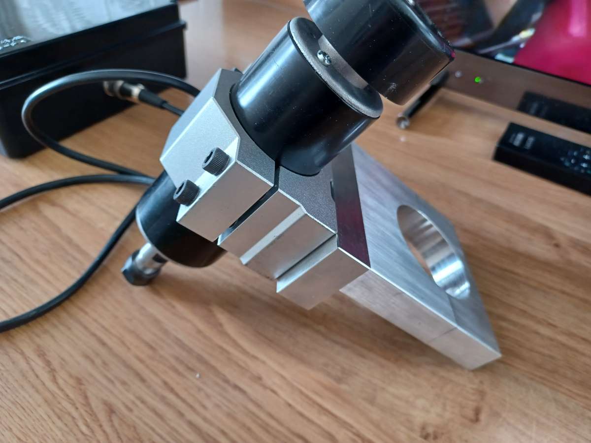

                                I wanted a grinding spindle for grinding the jaws on chuck which was well out of true and could be used for engraving as well and found that I could buy a high speed spindle which will do what I needed for a lot less than making one from scratch. It was easy to use the bracket which comes with the spindle and also made a bracket to fit the spindle to my mill.
                                20220717_12230320220717_122022
                                there is a video of grinding the chuck here      https://youtu.be/2VKR45MYVEwre.
                                david
                                    I’m pleased that you’re happy with it, and very pleased to see that you have fitted an earth lead in the video – the power supplies that come with these spindles aren’t isolated from the mains.
                                    Those spindles are just glorified motors though, running on ‘skateboard’ bearings in rubber cups, with wave washer preload. They aren’t very rigid at all.
                                    I know because I struggled with one and tried to improve it. I eventually gave up and built a separate spindle, using the ‘ebay special’ as a drive motor:
                                    (Some background here and here )
