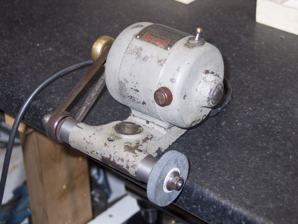

          I recently bought a little Dumore "Tom Thumb" toolpost grinder for less than the price of those castings ( I was watching those as well just out of curiosity). I have not used the Dumore in anger yet as it needed the motor re-wiring with a new mains cable and the spindle had been bent slightly at some stage in its life.
          Having made and fitted a replacement spindle with new bearings installed I ran it up tonight and it seems OK now.
          Tomorrow I will test it on the Myford lathe, I have high expectations of it as they are supposed to be the best you can get in the small sizes.

            Can you post a photo Phill

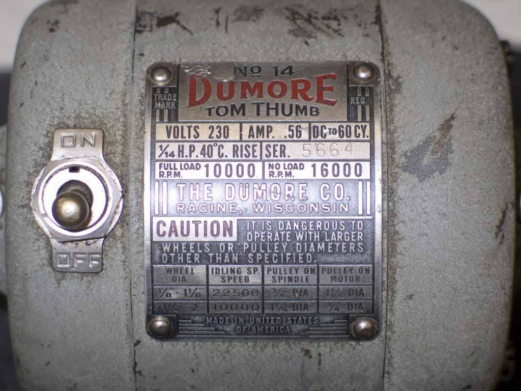

                    Here you go.
                    I am in the process of making some guards for it, they were not considered to be a requirement on the original grinder so I have machined some registers on the spindle casting to allow them to be clamped in place.
                    It would "probably" be OK as it was but I get very nervous standing over grinding wheels spinning at 10000 rpm plus.
                    To give an idea of size, the grinding wheel is 2" diameter, the spindle can also be fitted with a 1/8" collet to allow mounted points to be used for internal grinding.
