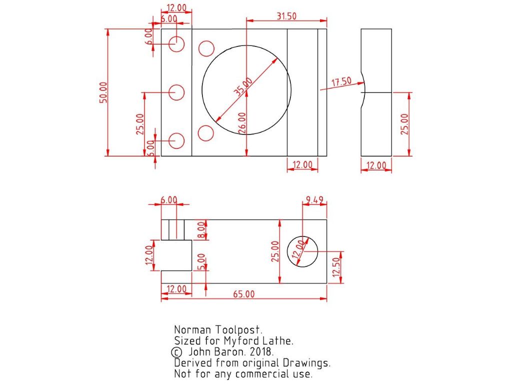

                      The plan for the Norman Patent tool post is here in my pictures.norman-001.jpeg

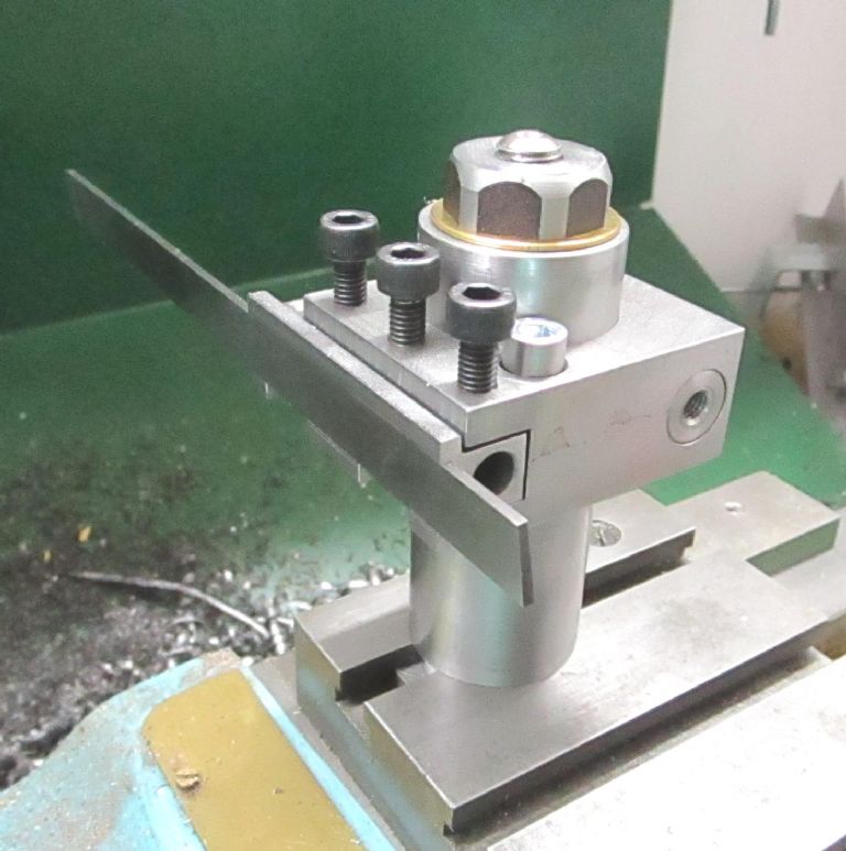

                                Hi Dave, Guys,
                                I don't fully agree about loss of rigidity ! I feel that my Norman Patent tool post is at least as rigid as the four way that I used to use. As far as resharpening is concerned I agree that it will move the tool height, but I tend to just touch up the tool using a stone and carry on with no detectable tool height change !
                                This is mine mounted on my Myford S7. Notice that the overhang is at least 3/4" less than the four way.

                                  I too am a fan of this style of tool post and for years used a simpler version to the design by L C Mason.
                                  Whilst I accept that the adjustment screw may add a little to the stiffness of this design, I am puzzled by your point about overhang compared with a four way which often sits directly on the topslide (ie nil overhang)?

                                    The overhang I referred to is the distance from the centre of the post to the middle of the lathe tool. Whilst I agree that the adjusting screw will provide some stability, but since its behind the tip of the tool on mine, it really should be on the front.
                                    I've made a rear post that also uses the same tool holder as the front does. It currently supports a 2 mm thick parting blade. Following some comments about breaking out the rear top slide slot, I made a 25 mm thick collar that fits at the bottom of the post and adds four square inches of support.
                                    Unfortunately I don't have a picture with the collar fitted.

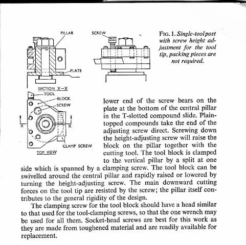

                                      Anyone thinking of making something along these lines might be interested in the following extract from the late C T Bower:

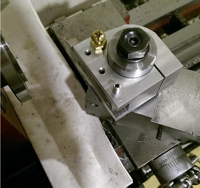

                                        Here's mine (with an oddball length screw).

                                          I really should go and alter the drawing to move the adjusting screw to the other side, however the original does show the adjusting screw where it is. Unfortunatley I no longer have access to the original patent document, which showed a broached square hole for the tool bit. I modified the drawing to show a slot sized to support a 1/2" inch tool.

                                            I've been and modified the drawing by adding a second adjusting screw position at the front of the tool block.
                                            Either position can be used. Drill 5 mm and thread M6. Counter bore to suit cap screw head as required.
