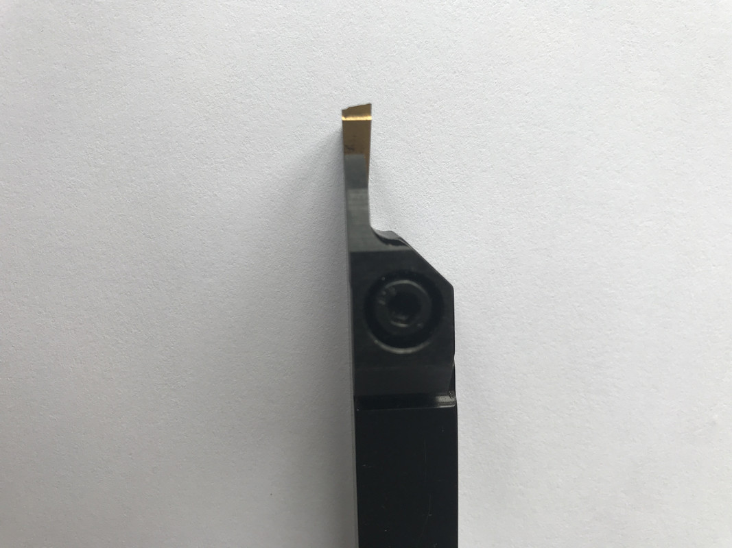

      Help please….as you can see (hopefully!) I've trashed the end of my cutter.
      I'd like to order a replacement, but despite searching, I can't find a match. It was bought as part of a set, and original retailers (Chester) say they can only supply a set of inserts for the complete set?
      Anyone have any idea what this is please?
      Cheers!

                    The section of the insert is a bit wierd, the bottom is somewhat like the underside of a ships hull…if that makes sense…??

                        I'm glad I re-checked this thread before I continued to duplicate what you've just done.
                        It looks like This Is The Tool Set
                        Sometimes scrolling through ebay items works, just to see if you can recognise something
                        These are similar, but look like they are intended to go in a horizontal position, unlike yours which slope upwards

                          Yes Bill (peak4) that's the one! I only need the insert for the parting tool, I have plenty of the others. Unfortunately Chester say they can't supply the parting insert on it's own, as it's only avaiable as part of a the set.

                            If you can find the code for the insert, it will help. You can search for the insert code, and probably pick up a lot of sources and manufacturers. If you succeed, you would be safest buying from a supplier based in your country, should any problems arise.
                            Warco do not appear to sell anything similar.
                            Take a look at Arc Euro Trade site. They sell GTN inserts in 2.2 and 3 mm widths, which might be suitable.
                            Their MGMN inserts are double ended and are either TiN or AlTiN coated, but only come in 2 mm widths. They might be too long for your holder. (These are used in the MGEH holders )

                              The eBay link by peak4 is for a double-ended insert. This will not fit.
                              GTN inserts will not fit.
                              MGMN inserts will not fit as they are again double-ended.
                              Have a look at:
                              https://www.rdgtools.co.uk/acatalog/9PC-Turning—Boring—Parting-and-Grooving-Tool-Set-12mm-Shank-435344.html
                              I think the parting tool is the same. The photo is a bit small. Check the other shank sizes in the same range to see if anything more visible is shown.
                              If you can establish identity, the insert code is given on that page – it is not SCMT or WCMT. The two JCL15 references with I and E are, I guess, the internal and external screwcutting inserts. By a process of elimination, that leaves CK3.
                              Please ask someone else to critique this analysis before committing your cash.
                              See also: https://www.model-engineer.co.uk/forums/postings.asp?th=76422
                                Edited By DC31k on 30/12/2020 13:51:29
                                I appreciate the ones I linked to were incorrect, just using it as an encyclopedia>
                                Yes you're spot on with CK3s I found them and spotted your reply when I came to report back
                                The tricky bit might be finding someone with them in stock RGD seem not to, though I guess they will be available direct from China.

                                        Paulimot has them in Germany. Should be available by post CK3

                                            Just ordered 4 from Paulimot.
                                            4 euros each, happy with that.
