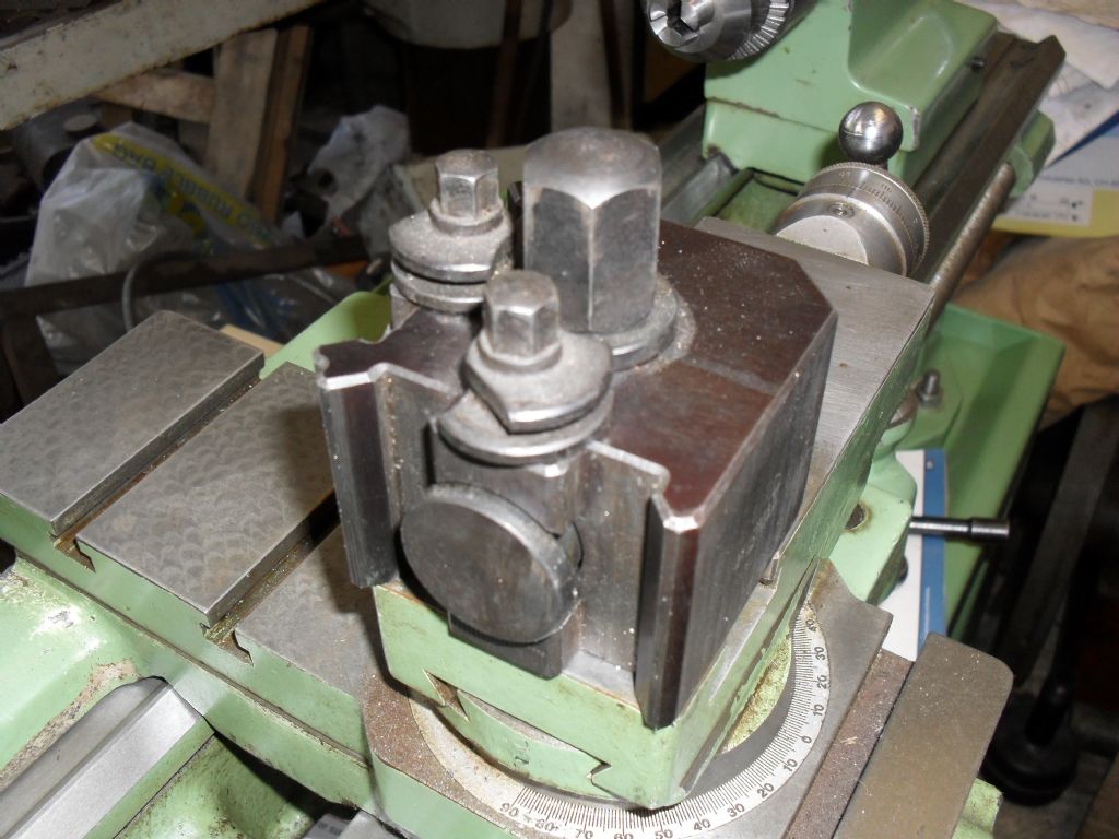

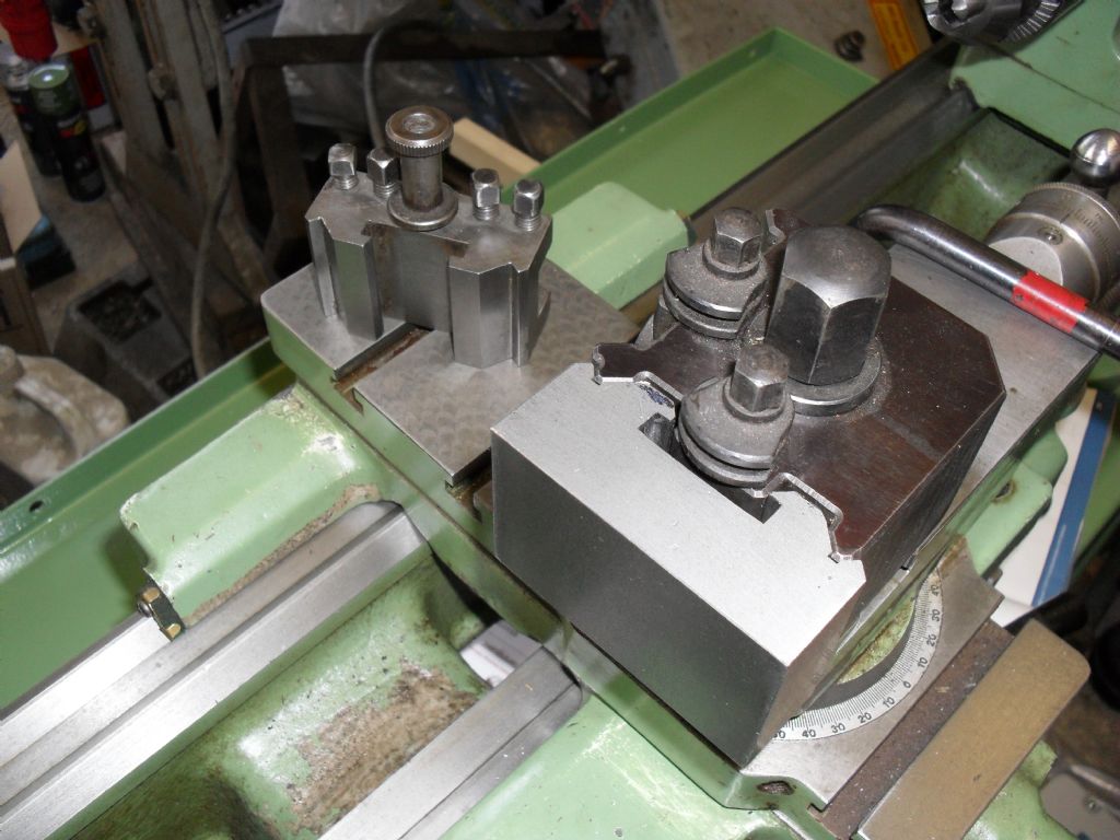

                            RICHARD GREEN 2
                              @richardgreen2
                              A while back I bought a "Rapid Original" QCTP for my Boxford ME10, it came with one tool holder,
                              My plan was to make a nice set of 4 tool holders to fit it, and put the whole process on the ME website,
                              This is where I'm up to at the moment,
                              Richard.
