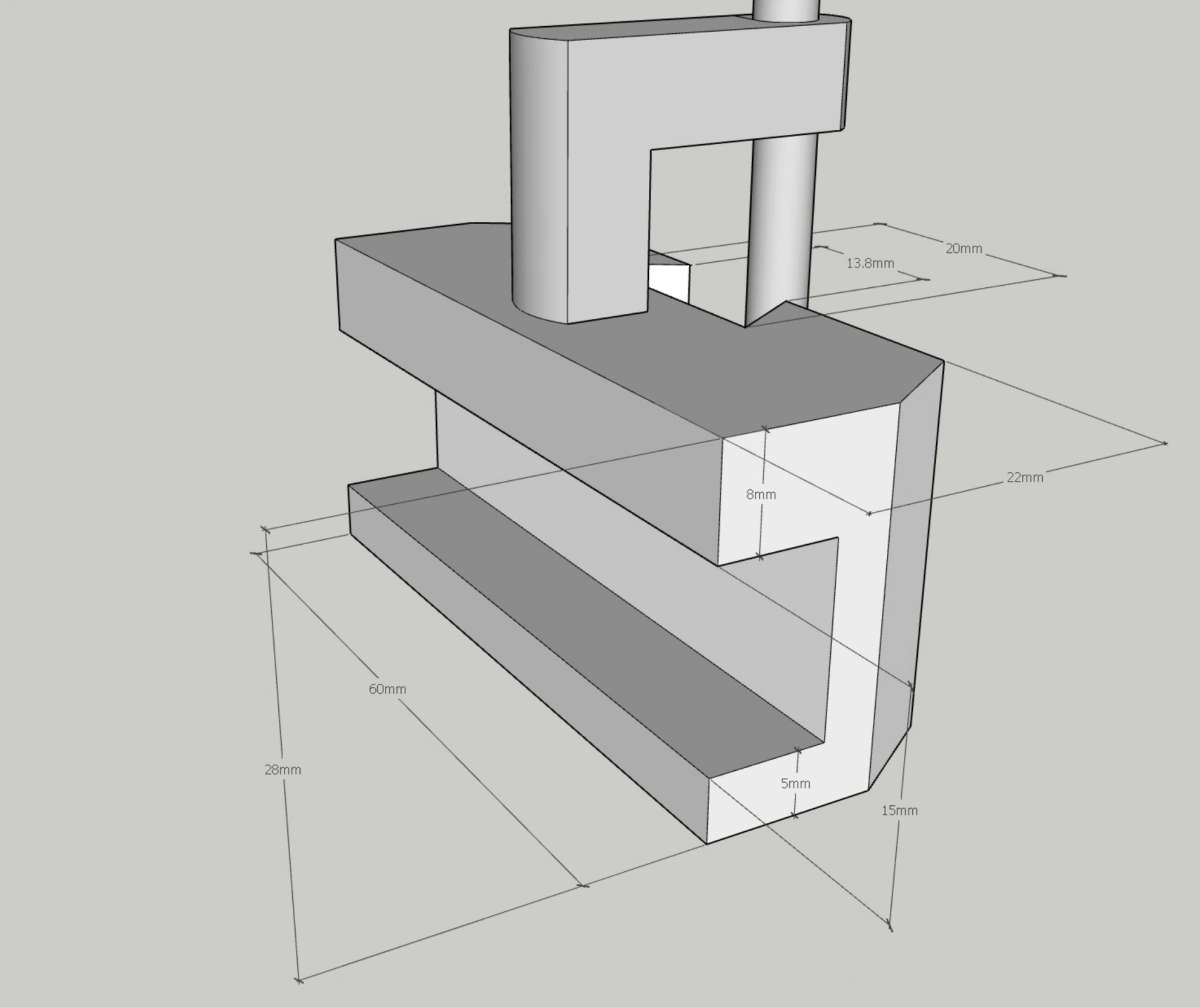

      Hi all,
      I’m trying to track down a supplier of this tool holder:
      I’ve tried ArcEuroTrade who have nothing that matches.
      Can anyone direct me to any alternate suppliers?
      Screenshot 2025-04-02 092655
      #791546
      Tony Pratt 1
        @tonypratt1
        RDG show something similar on their site but out of stock and no sizes but quotes ‘C2 C3 mini lathes’
        Tony
        #791549
          Looks a lot like the SC-4 one that ARC do as that is 60mm long, maybe some of the other sizes differ?
          Emco used a similar design on some of their lathes which may well be what the Sieg is “insired” by. Do you have the toolpost or lathe and if so is there a make on it? At that size probably the one for the Compact8

            #791566
              Just seen that you have an SC4 lathe so my bets are that the ARC one I linked to will be the best bet. Did ARC say they had nothing that matched or did you not see that one?

                Hi all,
                Many thanks for your help on this.
                The linked tool holder from ARC is apears identical to the ones I have..
                I’m not too sure why they responded the way they did…
                I have a related question regarding mounting a parting blade in said holder.
                The parting blade in question is wedge shaped in section with the thicker side being 1.4mm and the thinner side 0.8mm.  The height of the blade is 9.65mm.  Mounting this blade in to the tool holder directly seems impossible.
                Is there a sub-holder for this kind of blade that then is mounted in the tool holder?

                    I think the holder requires the blade top edge be angled sideways rather than flat
                    #791630
                      You can get holders for that type of blade, imagine a tee shape in its side and a recess for the cutter in what was the top. Split centrally so the toolpost clamps squash it down which grips the tool. Recess is usually angled on the good ones. Others are again the tee on its side but use a separate clamping plate to grip the parting blade. Downside is they add to the tool overhang off the sid eof the post

                        Many thanks for all you help on this.
                        Late this afternoon I had a call from Arc who clarified what I was looking for was actually the SC-4 one mentioned above.
                        Also they pointed me at a suitable parting off block:
                        https://www.arceurotrade.co.uk/Catalogue/Cutting-Tools/Lathe-Turning-Tools/Parting-Off-Blocks-with-M42-HSS-Co-Blade
                        Best wishes to all.
