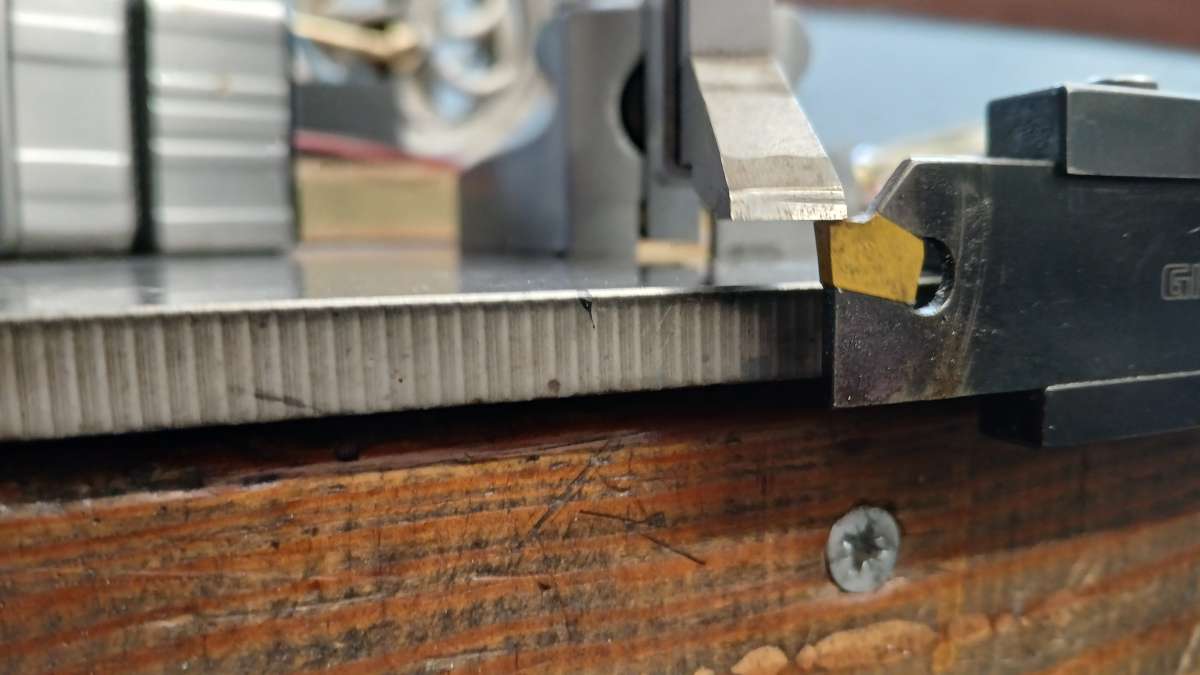

                              Just measured my 10mm Glanze one and the cutting edge sits 0.220″ above the bottom of the 10mm section.
                              20250115_121512

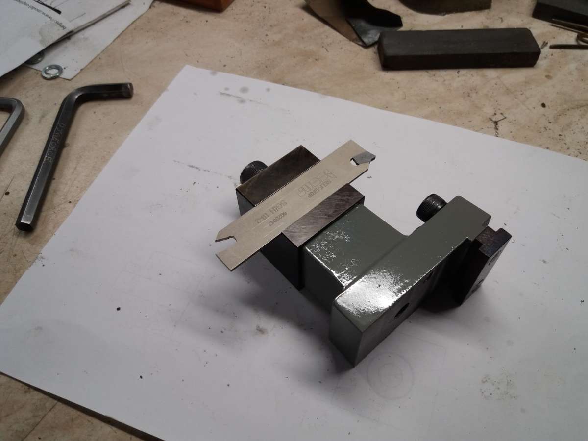

                                        David George 1
                                          @davidgeorge1
                                          This is my rear tool post parting holder and tool
                                          20190316_164659
                                          It is solid and I can easily extend and reduce length of cutting tool to part off I have parted over 3 inch steel and ally with no problem. If you want any further ifo drawings etc just ask.
                                          David

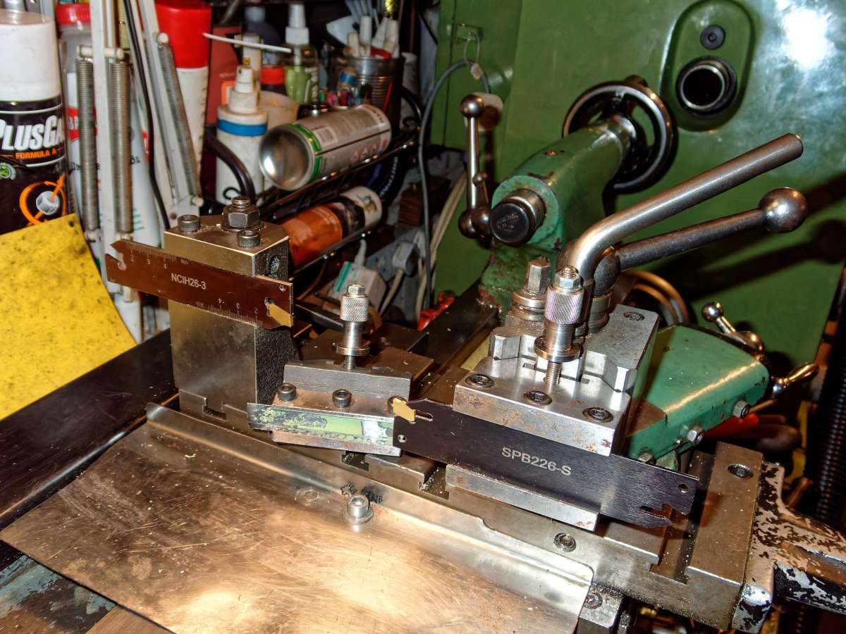

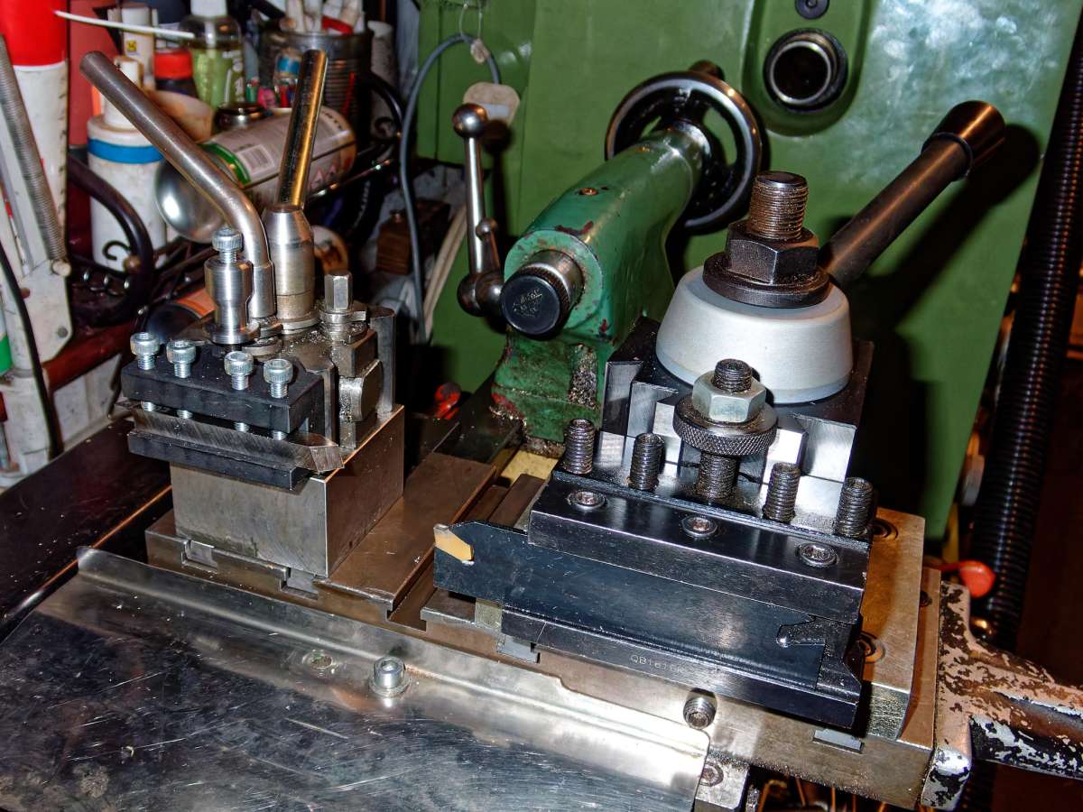

                                              A couple more ideas to chuck in the pot from my own workshop, seen here on a Warco 720, which is a Super 7 clone.
                                              I appreciate that none answer the question in the opening post, but might come in useful for others.
                                              Firstly left to right
                                              Rear blade parting toolholder; Solid lump of cast iron, so should be easy to replicate with a 3mm insert.
                                              I don’t know the original source, as I picked it up second hand, but they were readily available new a good few years; I can’t find a current supplier though.
                                              Centre is a Dickson style holder, designed for ½” HSS parting blades, here sporting an all-hard hand hacksaw blade segment, to make a very thin parting blade.
                                              Right on a normal Dickson style toolpost, is a specifically designed blade holder, with a 2mm insert.
                                              It works OK, but only with great care as there’s lots of overhang.
                                              T1150025_DxO-Facebook-s
                                              Next, the other two setups I have; There is another rear toolpost similar to David’s but not as well made, so I rarely use it.
                                              Left is a spare Indian (?) Dickson style, mounted on a riser block, shown here with an inverted screwcutting tool, but could obviously be used with a parting one. When I bought the Warco, it came with a spare toolpost, so it either gets used like this, or moved over to the genuine S7
                                              I also have a GH1330, which came with the 250 size wedge toolpost. I spotted a clearance sale one day, where a full toolpost with holders was cheaper than just a set of holders.
                                              On the right is that extra dovetail wedge toolpost, on a riser plate, replacing the whole Myford/Warco topslide.
                                              It makes for a pretty rigid setup, along the lines of a Gibraltar toolpost, but with changeable toolholders, though there is rather a lot of overhang with the parting blade one.
                                              The riser plate was carefully ground, so that the tool centre height is correct on both the GH1330 and the Myford clone. It looks odd in the photo, but that’s just parallax error, front and rear tools are on centre height.
                                              T1150026_DxO-Facebook-s

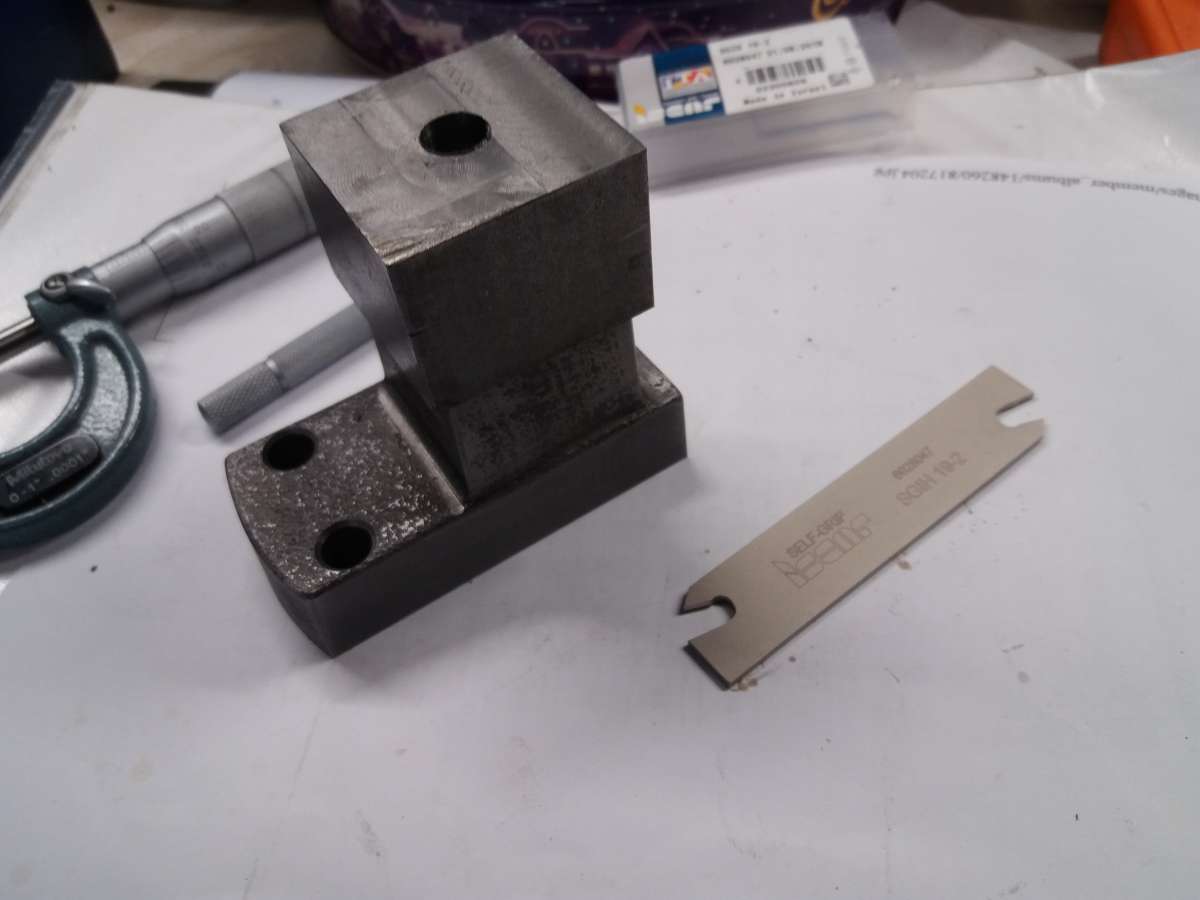

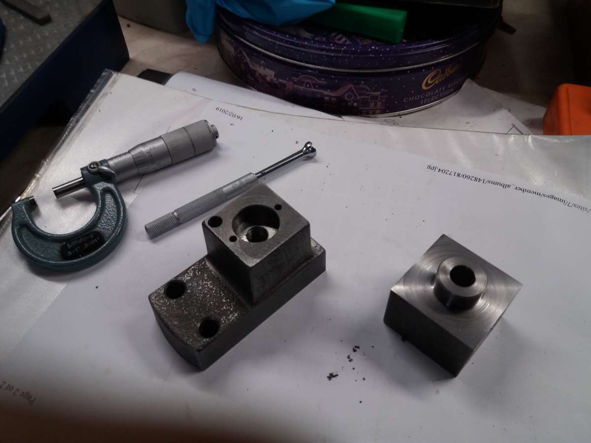

                                              David George 1
                                                @davidgeorge1
                                                The blade is clamped between two steel plates with a dovetail on each half which holds the blade. Just unclamp with the cap screw and slide the blade forwards and backwards to suit the job in hand. The blade can get very close to the chuck so helps the cut. no need to adjust height as it was cut to match centre height. Only used two tips in over 2 years of use on many diferant metals.
                                                20190309_09275620190309_092848
                                                David
