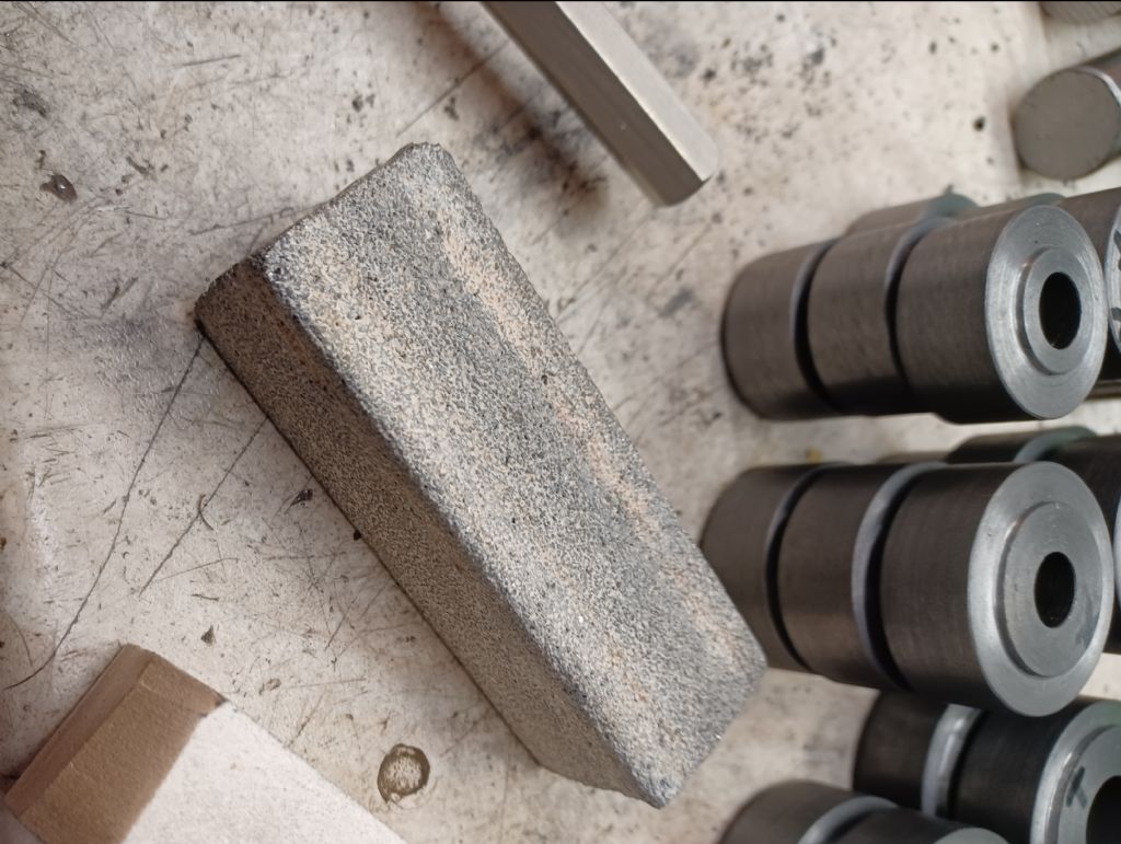

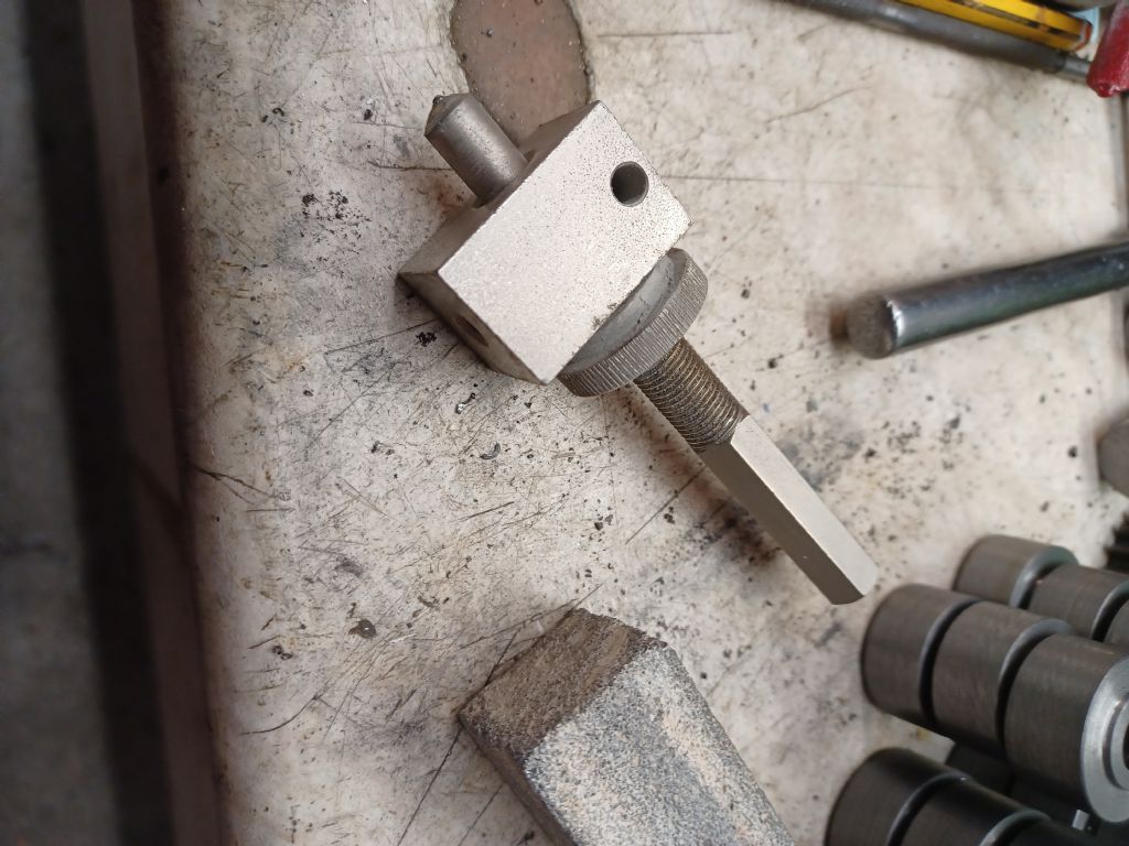

                                    David George 1
                                      @davidgeorge1
                                      When I dress a grinding wheel either for the off hand grinder my Diamond wheel grinder or cutter grinding wheel wheels I use one of these. A carborundum dressing stick, a diamond dressing stick, a chistle edged single point diamond on single point diamond holder with fine adjustment.
                                      This is used to rough dress any wheel carefuly Norton dressing stick.
                                      This is used to dress a diamond wheel to remove build-up and ckean up diamonds in face of wheel.
                                      This chistle edged diamond is good to shape a wheel edge ie undercut or radius etc.
                                      This is used to straight dress a face or side of a wheel to shape it can be held in a vice or magnetic stand or can be used on a off hand grinder to follow the edge of the toolrest to produce a straight face and put on small cuts. There are other dressing tools but these are the ones I use.
