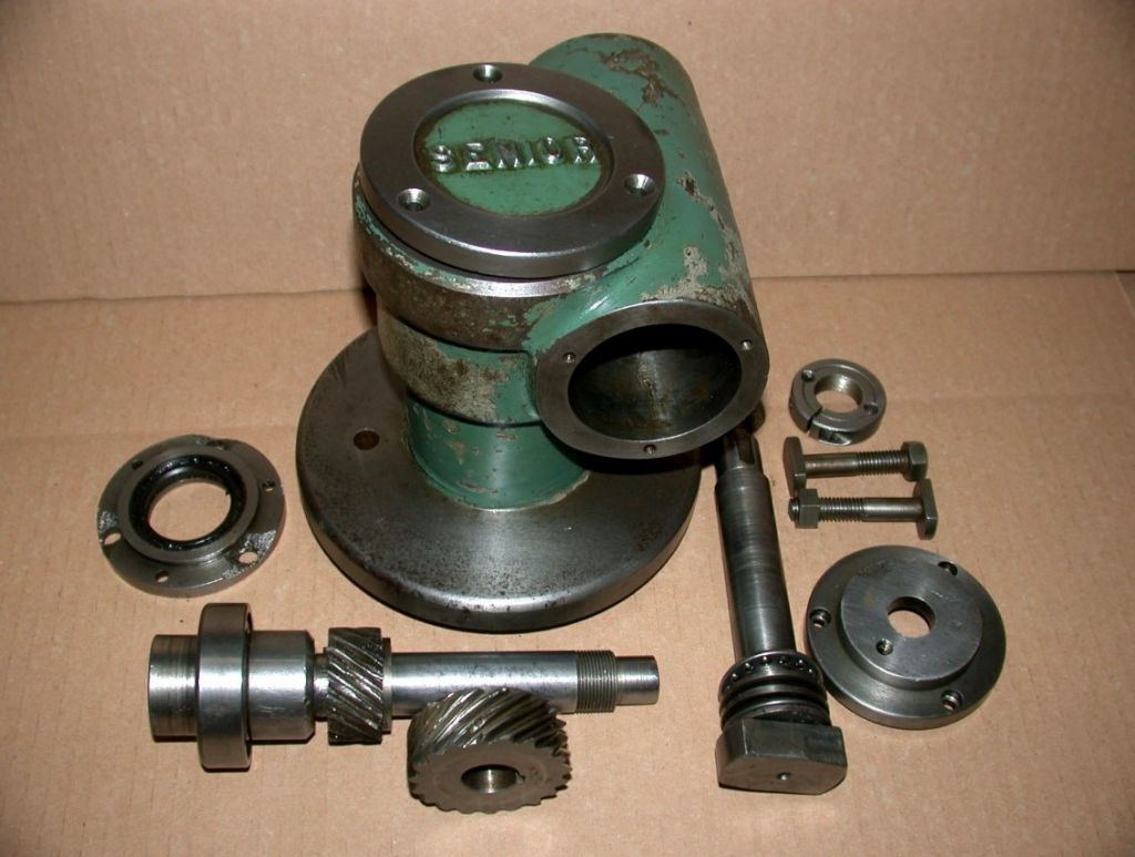

      a while back i bought a verticle head in bits (told all there)

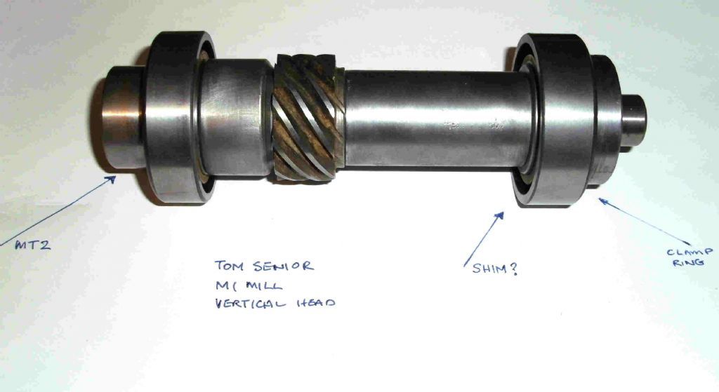

      i did find a picture from 2010
      i think i am missing a sleeve between the gear and the bearing but i can knock one up.
      does anyone have an exploded view or a picture of where the bearings and shims go as its a bag of bits?

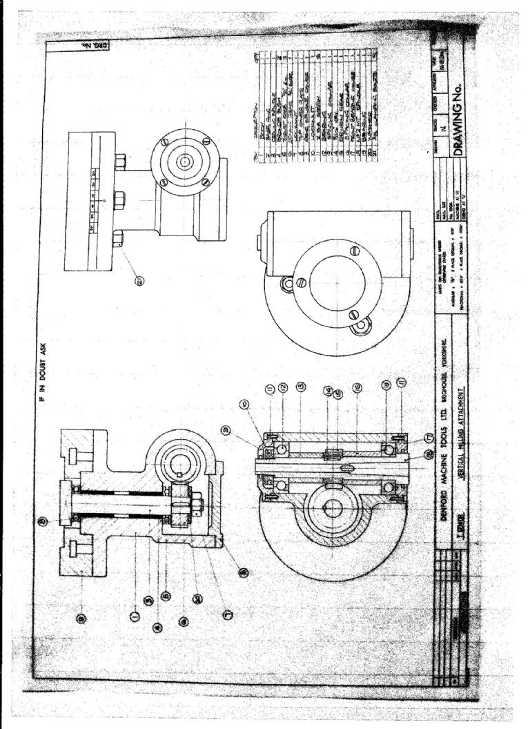

            Is this any good. I had to convert from a PDF to a JPG to manage to upload on here.
            Steve.

              I don't see any shims on the shaft, or anything marked under the end covers.
              It doesn't make sense exactly, since the central part seems like it should be clamped tightly using the missing tube and the outer races shimmed for the preload. Your spindle is different from the drawing, the gear is offset from the centre. I think the lower race outer is held tightly and the upper one moved to give the preload.

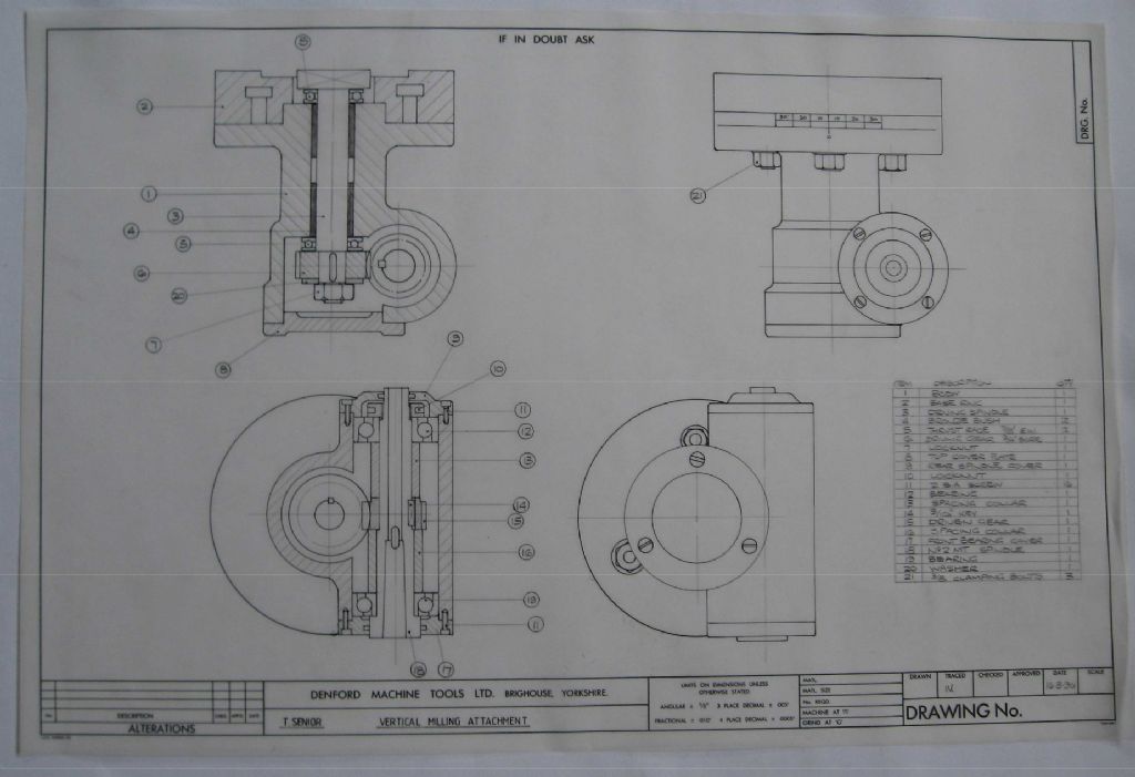

                The same picture as Steviegtr's hoping for better definition. I got this from the Denford forum, hope they don't mind. There is no sign of any shims for preloading.screenshot_2021-02-03 full page photo - ts vertical head pdf.jpg

                  Thanks for the reply if you look at the 2nd picture that I got of the net it says shim? but I do not have one in the bag

                    Thank you to StevieGTR and Old Mart I seem to be getting there I just need to find the seal size and make the tube that I have the drawing for now

                      Tom Senior seemed to make some changes to their designs from time to time which can be confusing. The drawing does not show the oil seal, for instance, and the position of the gear on the spindle varies. Do you know whether oil or grease is used in the head? If it is grease, then a common lithium high melting point would probably be ok. Moly grease is not recommended for ball and roller bearings, as it can make the surface of hardened rolling elements brittle. I used a double lip oil seal without the garter spring on the TS light vertical R8 conversion along with lithium grease and it overheated. The only solution was to completely remove the inner half of the seal, which was ok with grease and the outer lip keeps the swarf out of the bearings.

                            Thank you all for the replies the seal cam be seen in the end cap on the far left of the first picture on my original post

                              right i have all the parts to rebuild this now except the bolts to hold the 3 Caps on 2 of them have a counter bore and one is countersunk can anyone tel me the bolt sizes and threads please as there was non with it.

                                TS use BA for the smaller fittings, so you could try a 2BA or 4BA screw in the holes.

                                  Thats great thank you i thingk i will take the casting to the bolt place that way i know it will be right.
