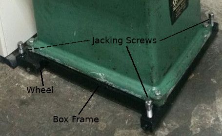

                    #326399
                    Piero Franchi
                      @pierofranchi37209
                      The little time I have spent on my mills has been stripping it down, cleaning and putting it all back together (the major, as it was very dirty when I collected it, the M1 was very clean and needed very little doing)
                      actual milling time is more a case of doing something that,s needed as in fixing something.
                      I have not done a project on the mill and the jobs I have done, were more a matter of what works!!!!
                      I don't have a set of rules that I follow as such, I just go on what I think is wright.
                      So I wont look up feeds and speeds and depth of cut, I cant say what I have been doing either !!!!!! sorry
                      I know this does not help.
                      I do know I lock the table in what ever axis is not moving, I hand feed at a rate that does not give problems,
                      My base that I have built is very ridged, it is a thick wall box section square with these adjustable feet on it,
                      Ill have a look on my phone and see if I have photos of it that I can up load.
                      My only concern with the stand was it sits on the adjustable feet that have a very small footprint contacting the concrete floor
                      Edited By Piero Franchi on 10/11/2017 10:38:11
                      #326404
                      Piero Franchi
                        @pierofranchi37209
                        Just added two photos in my blog
                        as you can see the stand should be up for the job, but like I say, the bolts sit directly onto the floor (not on any type of pad)

                            #326446
                            Bazyle
                              @bazyle
                              The photo in your album of the major looks like it is sitting in mid air on dinky little bolts about 4 inches long. probably not the main problem but take those out and lower it onto bits of paving or paving bricks (but not soft house bricks).
                              If you are using a 4 flute endmill don't try to push it full width sideways into a block of metal. You have to run along the side of the block no more than 1/3 of the width of the cutter at a time. For testing only go down 1/2 cutter width.

                                  Alan Waddington 2
                                    @alanwaddington2
                                    The thing with smaller lightweight mills is, any deficiencies in technique, wear in the machine, loose gibs, blunt cutters etc etc tend to be massively amplified.
                                    I had a Tom Senior for years and although they are a capable machine, it was possible to get it dancing around the floor if everything was not spot on and locked down prior to taking a decent cut.
                                    You tend to get away with a bit of sloppy technique when the machine weighs a couple of tons. smile p
                                    #326490

                                      #326495
                                      Alan Waddington 2
                                        @alanwaddington2
                                        Having now looked at your photo's i don't think the stand is in any way causing your issues……..stick a sharp cutter in and have another go wink 2  I never had my TS bolted to the floor in over 10 years.
                                        Edited By Alan Waddington 2 on 10/11/2017 17:23:34

                                          #326501
                                            Posted by Piero Franchi on 10/11/2017 17:13:13:
                                            Do you think its ok with it just sitting on the four bolts???
                                            The stand was made so I can move the mill around if need be, you can just see to solid wheels at the back and on the front there is two lugs that stick out where a separate set of wheels lock in when moving.
                                            I had thought about drilling some bolts into the floor, and locking it down with a set of strap clamps type thing.
                                            do you think it needs it????
                                            I still think blunt cutters are the most likely cause but here's a picture of Piero's stand.
                                            Looks good to me and is similar to what I plan to do with my lathe if I reorganise my workshop. I had no intention of strapping it down.
                                            Assuming all four jacking screws take their full share of the weight and the wheels are off the floor, the only thing worrying me is the possibility that loose fitting screws might wobble where they go through the box frame. I've never tried anything like this and am guessing wildly; what do the experts think?
                                            #326511
                                            Piero Franchi
                                              @pierofranchi37209
                                              Thanks for blowing up the photo
                                              Yes the rear wheels are off the ground,
                                              The bolts go through a all threaded sleave (the full width of the box section)
                                              you can just make out the lugs on the left side of the front left adjusting bolt,
                                              as I said, there is a removable front part with two solid casters that aid moving the mill
                                              Edited By Piero Franchi on 10/11/2017 18:06:15

                                                    Mine sits on 4 " wheels – they don't move.
                                                    I would suspect that your gib strips are looser than you think. Try locking the cutting axis till you can't move it, then back it off till it just moves and see what happens to the cut.

                                                      I can take an 0.080"- 0.120" (2-3mm in new money) DOC with a 5/8" (16mm in new money) end mill or slot drill in steel all day long.
                                                      1973 M1 with the S quill feed head and a Vertex collet chuck. Machine sits on it's cabinet which sits on 4×2" box section steel to raise the height. Not bolted down. No vibration.
                                                      Those wheels, castors are not what milling machines are meant to live on.
