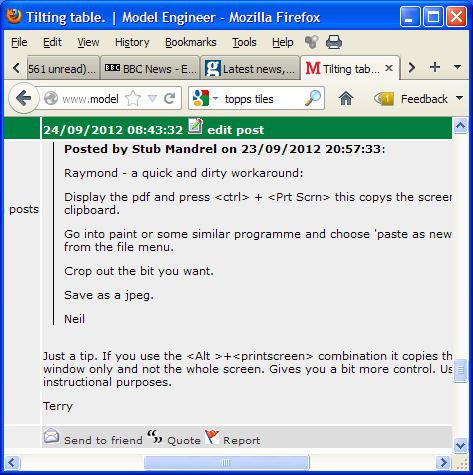

                #99228
                Sub Mandrel
                  @submandrel
                  Raymond – a quick and dirty workaround:
                  Display the pdf and press <ctrl> + <Prt Scrn> this copys the screen onto the clipboard.
                  Go into paint or some similar programme and choose 'paste as new image' from the file menu.
                  Crop out the bit you want.
                  Save as a jpeg.

                        #99251
                        Terryd
                          @terryd72465
                          Posted by Stub Mandrel on 23/09/2012 20:57:33:
                          Display the pdf and press + this copys the screen onto the clipboard.
                          Save as a jpeg.
                          Hi,
                          Just a simple tip. If you use the + combination it copies the open window only and not the whole screen. Gives you a bit more control and better resolution. Useful for instructional purposes.
                          E.G.
                          Regards
                          Terry
                          Edited By Terryd on 24/09/2012 08:49:42

                              #99261
                              Swarf, Mostly!
                                @swarfmostly
                                Hi there, all,
                                I've just tried the screen capture procedure and to capture just the open folder it's <alt> + <PrtSc>, NOT <ctrl>. That's using Win XP.
                                My wife has also tried it using Win 7 and <alt> + <PrtSc> is right there too.
                                Best regards,
                                Swarf, Mostly!
