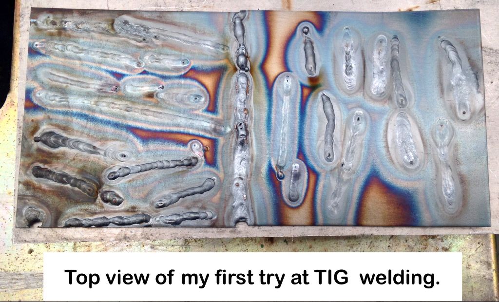

      Decided it was high time that I gave the TIG feature on my CT-312 machine a try as it would be needed to do repairs on the bodywork of my '35 Austin Seven.
      Spent yesterday messing up pieces of 1.9mm MS and was pleasantly surprised at how easy it was. Can hear people shouting at the screen in disagreement.
      OK I did have to regrind the electrode tip a number of times, but that appears to be quite normal for newbies.
      I do however, need to do a lot more practice as the last time I did any O/A welding was in the '80s.
      My gas welding experience has most definitely helped me as muscle memory allowes me to keep the electrode at a constant distance, sort off, and feeding the filler rod at the same time.
      If anyone has any tips, they would be appreciated.

                                Keep practising on thin plate. Don't try copper yet as it requires a great deal more control, but overall you have certainly started in the right way. Don't believe all that you hear about mig being very easy either. Its easy to spurt a weld down and make something stick but start welding up a steam boiler and you suddenly realise its a bit more complicated than it might appear!. Good luck by the way.

                                  Geoff – Like you I wanted to build a smidgeon of ability with TIG. For me it all goes well down to 1mm thickness then you need to start using heat sinks to stop the holes! My limit was 0.7mm thick stainless, and that was not pretty. I then wanted to repair rusty motorcycle mudguards and just failed using TIG. But, I went back to the cheaper MIG and was able to fill holes, build seams and so on. Several hours later with the grinder and the mudguards were strong and ready for the filling/painting stage.

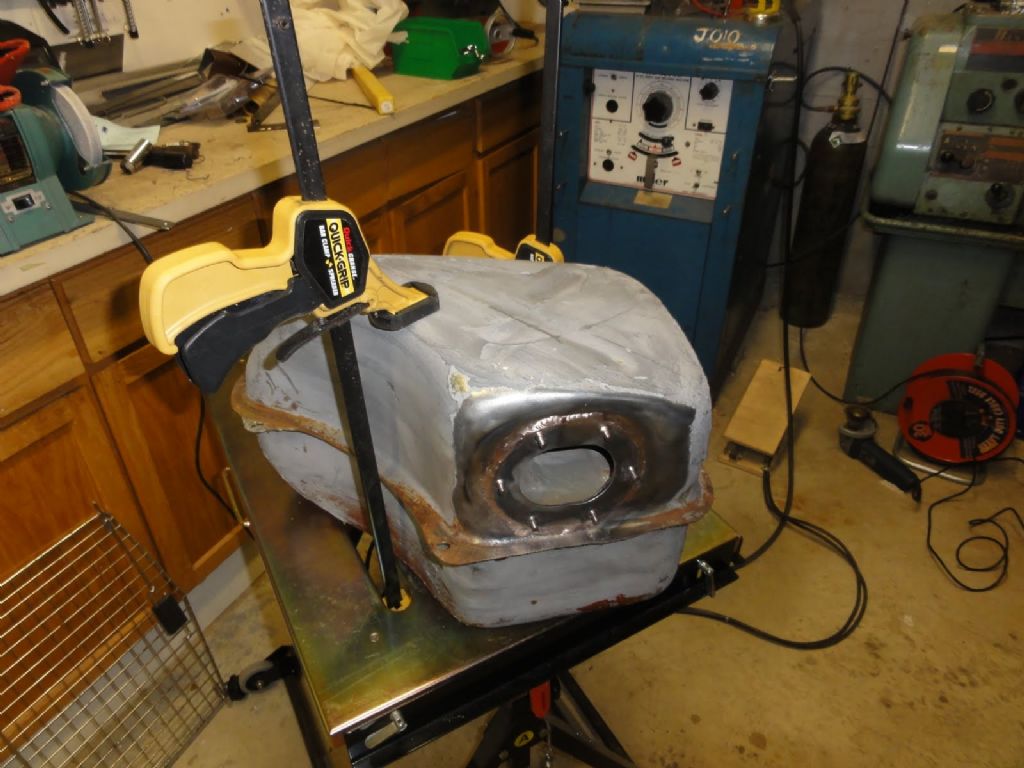

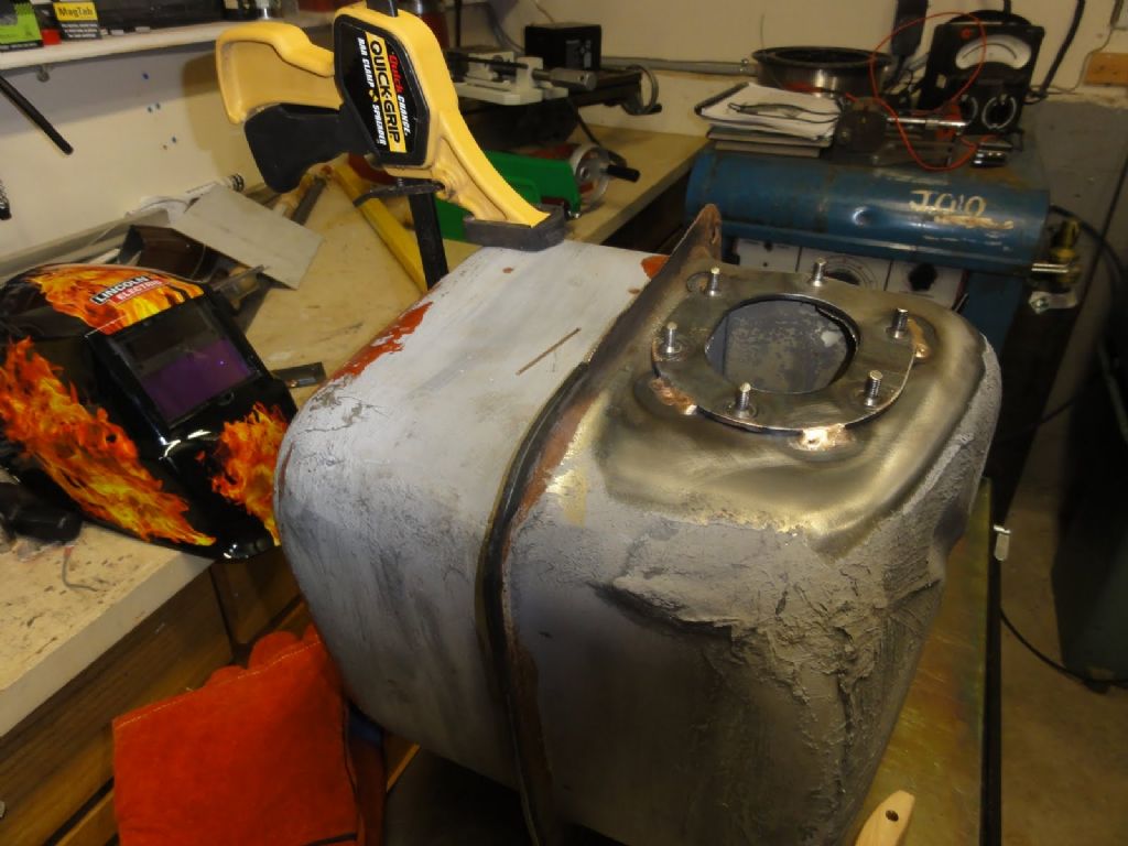

                                      Norm – it's a lot more controllable and clean than carbon arc. For one thing you don't need to apply flux or buy flux coated brazing rods and there's little cleaning up required. You can also control the arc easily with a TIG machine, especially if you have a foot pedal or torch-mounted control.
                                      Here's a flange plate I brazed to the bottom of an old fuel tank. I would have struggled to weld that. I needed a thick plate so that I had a flat surface for the fuel pump gasket and I needed to join that to the thin tank which was also partly rusted. The gap filling capability was quite impressive and handy!
                                      As you say, it's essentially copper with a trace of silicon. The term "brazing" can be applied to almost any copper alloy filler IIC.
                                      TIG brazed fuel tank
                                      Murray

                                          Posted by norm norton on 24/04/2015 10:37:19:
                                          With foot pedal control the upper power limit can be pre set and as you weld the power can be reduced it also works well at the start as more power is required initially to get the weld pool but less once welding and if more power is needed it is easy to increase the power. Welding in difficult positions means it is not always possible to use foot control and in some cases you may find it is next to impossible to get the TIG torch in and still feed the filler rod.

                                              I forget what electrode and current I used but looking at the pic, it was on the high range (up to around 300A), although I don't know what the actual max current setting (set by the big knob) was. You make sure the arc is landing in the copper not the steel and turn the current up and down to control the size of the pool. I don't recall the rod size but I suspect the smaller 1.2mm would be the safest choice.
                                              Generally you only use pure argon in TIG welding. MIG uses an argon and CO2 mixture for steels (in which case technically it should be called MAG ie metal active gas).
                                              I suspect that ideally for TIG brazing you'd use a mixture of argon and up to 10% hydrogen which would give a reducing atmosphere, turning any oxides to water vapour and giving a "bright" finish. Most of the industrial gas suppliers keep Ar/H mixtures but you need to be a serious trade customer to get it. At that concentration it is considered non combustible but still providing a useful reducing effect.
                                              In the old days, you would use hydrogen for induction brazing, or possibly water gas. Not something I'd want to mess about with although it never seemed to be a big concern.
