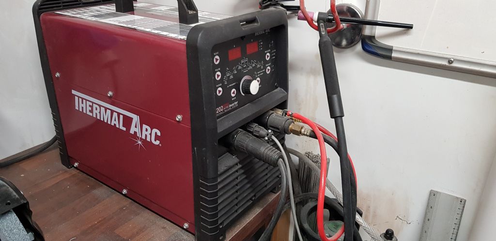

          Steviegtr
            @steviegtr

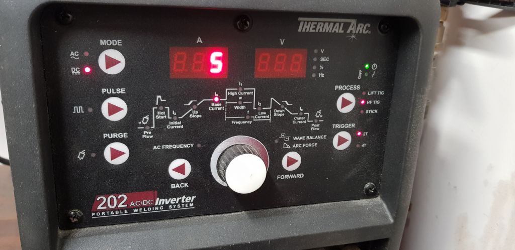

            I have the Thermal arc AC/DC Tig unit which is very good. I believe the Esab is the same unit. The cheaper ones i am afraid are made in the east like the Parweld, but seem to get good revues.
            It takes a little time to get used to using a foot controller but worth the time to learn. It gives you time to concentrate on the weld better.
            Steve.

                        I forgot to say, with Tig half the battle is to get the settings exact.
                        Gas flow pressure, Tungsten size & stickout, Gas cup size. Ramp up & down times. Flow pressure & pre flow purge. If welding tube then internal gas purge is required to stop oxidization on the inside. AC balance to get the oxidized layer to break away. Look on youtube it's all there. Good luck.
                        Steve.

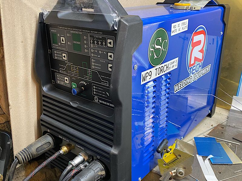

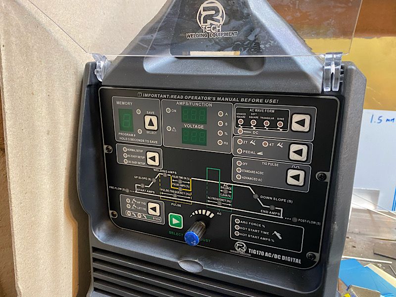

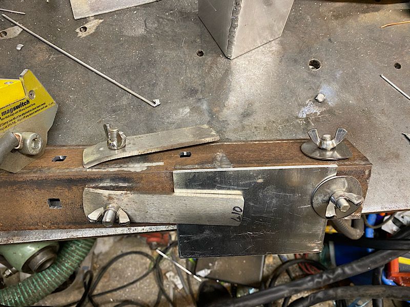

                              Ive had a dc esab tig welder for some time and i can do an acceptable weld on MS and stainless
                              but a few weeks ago bought a rtech welder as championed by doubleboost on YT
                              what a steep learning curve alloy is
                              I’ve used up a full 9 litre of argon and still not got acceptable welds
                              i can run beads all day long and they look great
                              i can butt weld now in 0.9mm up to 3mm thick
                              but outside and inside fillets no way yet
                              i’ve just gone and got a big argon bottle …much cheaper gas cost..
                              #508674
                              Ian Parkin
                                @ianparkin39383
                                d853609b-966d-4095-ac30-889b2f0c7110.jpeg3602c531-e913-4d6a-94d0-22d9a8cd463b.jpeg337d8fe1-4d83-4000-b180-dc092a317a3a.jpeg
                                #508693
                                Ian Parkin
                                  @ianparkin39383
                                  102.jpegWell tried again …..made a jig to hold my alloy at 90 degrees to each other fastened the earth clamp to the jig quick wire brush with a SS brush and success
                                  Well for me I’m pleased with the result

                                      How much duty cycle this welder offers? Ian

                                            Alex
                                            the book says 60% at 170 amps for tig
                                            mma output is 35% at 125 amps

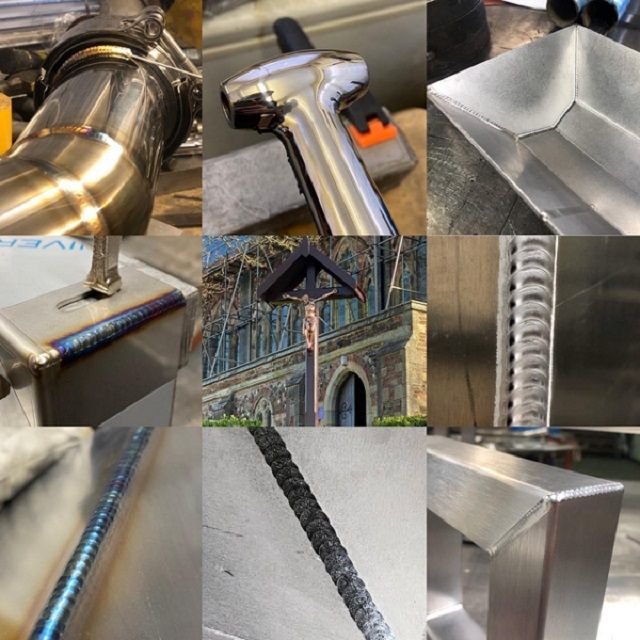

                                                I have a friend who is a professional tig welder doing marine and refrigeration tig welding. His welding is stunning. I'm sure he wont mind if I put up a picture showing some of his work.
                                                I can only dream of being able to weld like this.

                                                  Very nice. He must have a steady hand.

                                                      He really got some skills I mean tig requires a lot of skills and clean hand he is really a professional give him a thumbs up from my side!
                                                      stunning!
