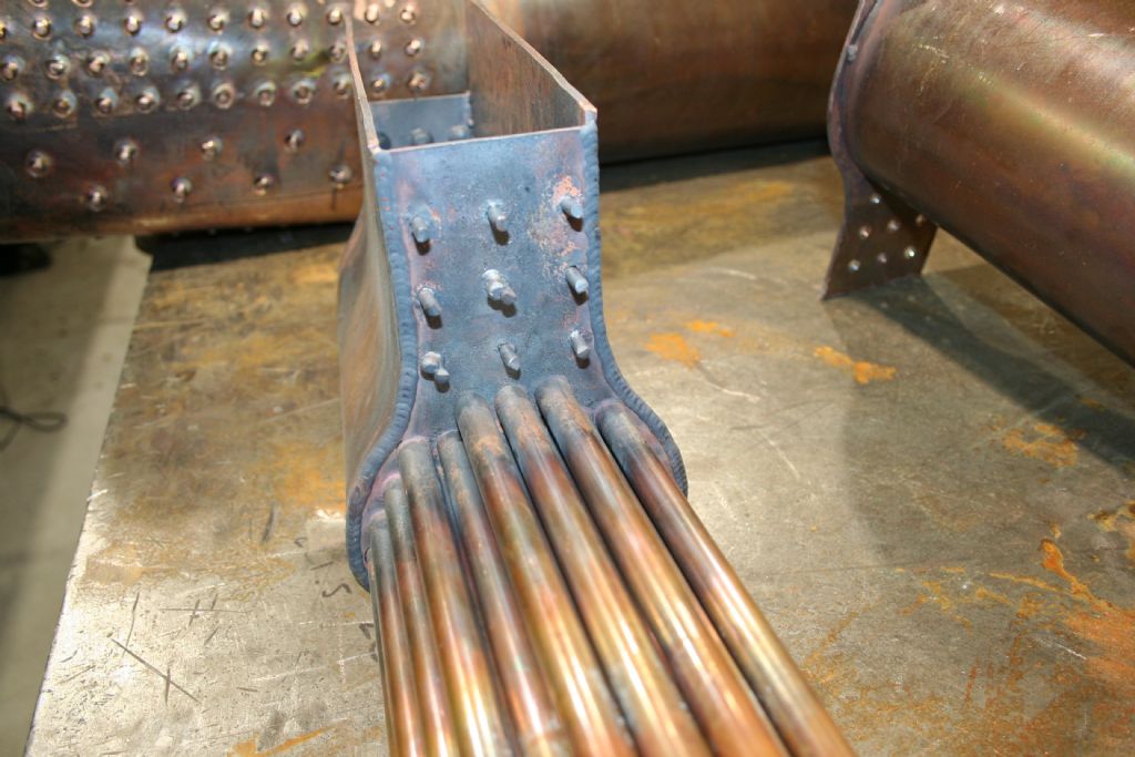

          Martin Kyte
            @martinkyte99762
            Cost mainly. Silver solder is expensive so a professionally made boiler TIG welded is cheaper in materials.
            Here is the firebox of my 5" King
            regards Martin
