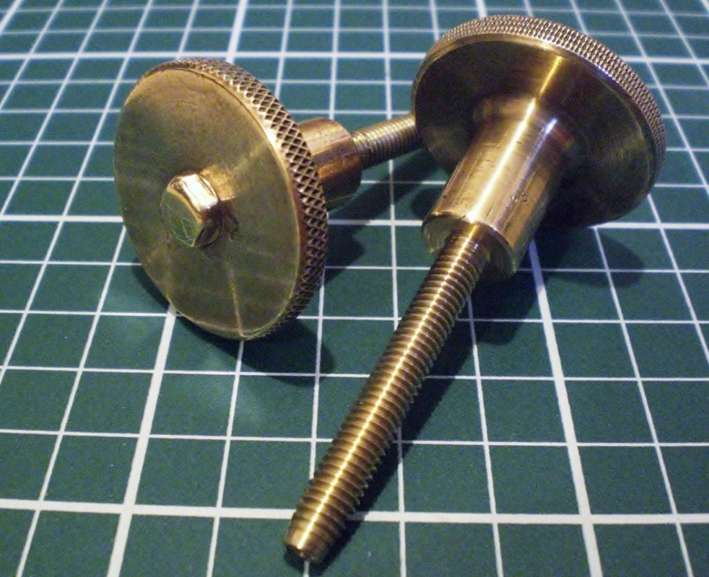

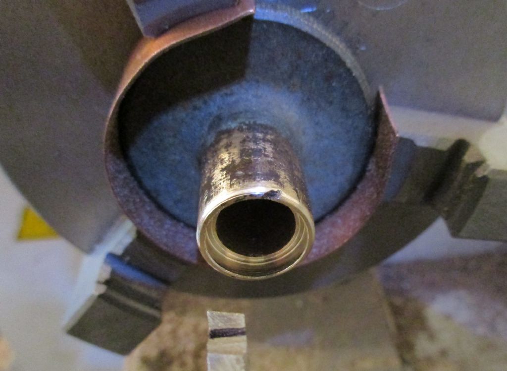

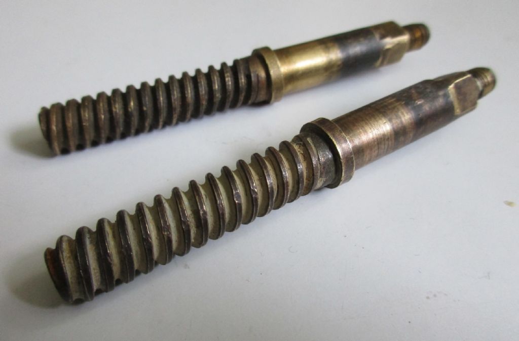

                                          Hi Derek, I made these adjusting screws in two parts, which saved on machining and material, both parts were made from used parts, which was a couple of old hand nuts and a couple of spindles from worn out gate valves which were Loctited into the nuts.
                                          These are used on my basic magnetic compass Compass which is virtually all made from used materials.
                                          Regards Nick.
                                          P.S. I hasten to say these are a lot larger than you need, but the principle is the same.

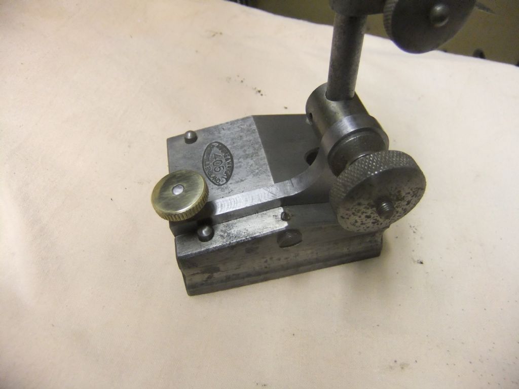

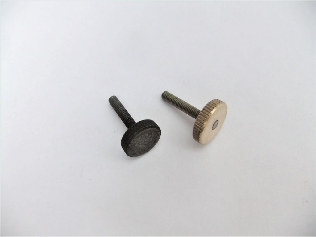

                                                OK I went for a two part construction I found a new bolt with the 4mm thread which was too long and I found a piece of brass rod about 2" long. I also had a single sided knurling tool which I only brought to add texture to some of my woodturning (I need to buy/make a better one).
                                                Picture of the old and new screw

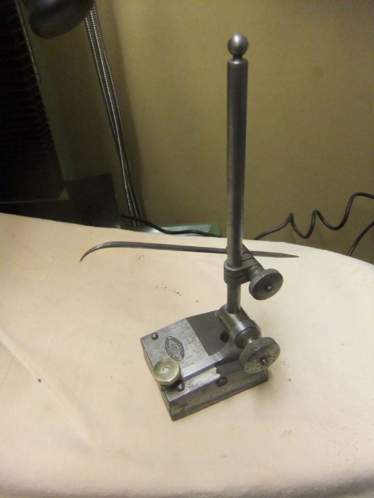

                                                      All complete and back in commission
