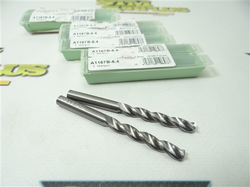

      I have just been given some engineering bits and pieces, which include a couple of three flute drills. In what way would these superior to standard two flute ones, or are they for some special application?

          Could be core drills.

            Being stiffer than 2 flute 3 flute drills provide rounder/straighter holes, provided of course like all drills they are ground correctly.

                Like Emgee, I'm of the opinion that three-flute drill make rounder holes.
                [ordinary 2-flute drills often make tri-lobed holes, especially in thin materials.]

                  As the name hints to they are used to open up cored holes in castings or holes that have previously been drilled undersize. Try Presto

                      The "Home Workshop Dictionary" goes with Michael's definition, but the author concedes that this sense of 'core drill' is unlikely to have preceded the one for drilling out castings.

                        I would not be so sure, as Maurice said they has 3 flutes a quick google for "3 flute core drill" will throw up quite a few other using this description. You may be getting confused with s "shell core drill" which in engineering terms is the one that leaves a slug in the middle similar to Rotabroach and Mag Drill bits. Guhring list the two types.
                        If this were a building forum then the generic term "core drill" would be taken to be as you describe, being either the old TCT ones that mount on a K taper and use A taper pilots or the more recent diamond edged ones that use a plain shank pilot that goes into a previously drilled hole.
                        Also as every good model engineer who has read and reread the works of Tubal Cain will know he used a 3 flute core drill to open up the cored cylinder casting on his "Hand Maiden" engine with a brace and bit before reaming itwink Think I would rather go by the words of TC rather than Stub mandrelsmile p

                          3-flute end-mills are a common item in most catalogues. My understanding is 3-flutes are a compromise. They cut metal faster than a two flute mill, and are better at removing swarf than a 4-flute. Swarf is removed well enough for them to be used to cut slots.
                          Most likely to be used where someone has traded off finish, power consumption, tool-life and job time to optimise production. In the right circumstances they reduce the number of tool-changes needed.

                            I have several three and four flute core drills. I use them in the lathe to open up smaller drilled holes but I don't think I'm getting (or needing) their full benefit.
                            Now, If I were machining a casting that had cored holes I think that would show their full benefit. A cored hole could, as cast, be slightly out of position but the lateral rigidity of the core drill will cope better with cutting more on one side than on the other – a common two-flute drill will try to follow the path of least resistance resulting in a hole of correct size but (slightly) in the wrong place! Of course, the context here is use in a machine that can position the drill axis in the right place by some means other than needing a centre punch mark.
                            The core drills I have do not have a point but have an almost flat business end.  They cannot start a hole on their own.

                              3 Flute will give a rounder hole.
                              There are 3 flute 'Drills' have a look at Titex absolutely awesome but expensive. Need to replace a few i use often.
