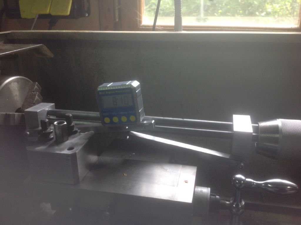

                                  John Hinkley
                                    @johnhinkley26699
                                    Mounted in the lathe
                                    I have only cut a few threads on the lathe, but used the set-over 29.5deg method when cutting the thread for the ER collet chuck for my tool post mounted spindle. I made a useful little tool to set the top slide to the required angle – it can be seen in my album "top slide angle setter". It also came in handy for setting the angle for grinding the taper of the collet holder – see picture, above. I didn't want to rely on the graduations marked on the cross slide to accurately align the top slide.
                                    Edited By John Hinkley on 20/05/2015 13:45:25
