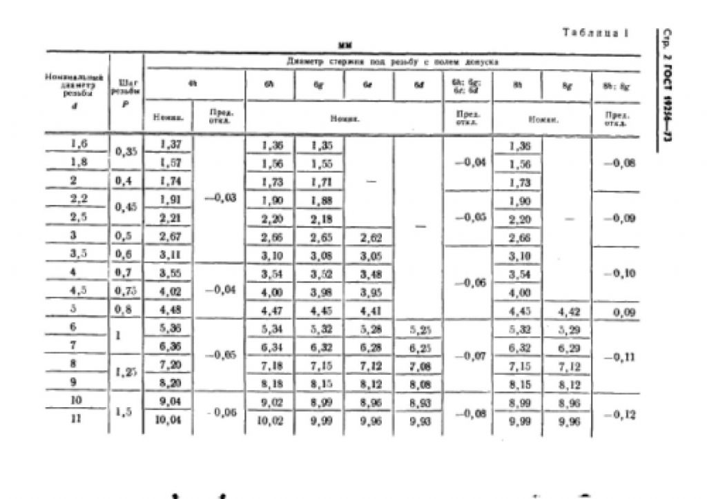

                              I've got the very same dies on the way from Russia!
                              I found this chart that shows diameters down to M1.6.
                              I suppose you could extrapolate the diameters for the smaller threads from the other sizes.
                              Sorry about the image quality, it is just about readable.
