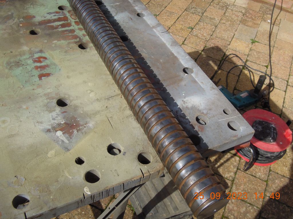

      I have an oldish Sigma gauge that needs to be come useable again after years of living in seclusion in the dark recesses of the back of the garage. I want to polish up the main support post and the challenge is the dirty/rusty grooves. They are about 4 to 5mm wide and about the same depth.
      Unfortunately the post is just an inch or two long for the centres on my lathe and its probably far too heavy to remove the tailstock and just 'chuck' it. My rotary wire brushes struggle to reach the bottom of the grooves, never mind the sides, and are more intent on rounding off the top edges.
      I could mess around with bits the string smeared with abrasive but before I waste a day or so doing this, just wondering if anyone has done this kind of job before and has a well proven, tried and tested, method that might get it done in an hour or two instead ?
      Gerry

          Hi gerry,
          Do you have a fixed steady you could use to support the work without the tailstock?
          #661546
          gerry madden
            @gerrymadden53711
            Bo'sun, no unfortunately not. I did think of a wooden block support but if its not perfect I can see the leverage mangling the chuck jaws and didn't want to risk this. …….But the idea is not 100% dead yet.

              Congratulations on having a high precision comparator! Well worth taking care of it.
              Maybe the way is the hard, manual, way with a hand held wire brush?
              The thread is there to adjust the head up and down the column,ratheyr than to provide a great axial thrust.
              So wire brush with regular visual inspection.
              Other than that, rwsort to chemical means of rust removal
              Howard

                      Clean the first couplr of turns manually. Bore out a block (tufnol, alloy, wood) to the OD of the post. drill two holw onf pitch apart 90 deg to the bore. fit a pin with diameter = groove width in one and a clean-up cutter in the other. run it up the thread with the guide pin behind the cutter.

                        Recently I've been to pick up a 36" vernier gauge in very good condition; the vendor gave me a 40" very rusty one as a freebee.
                        I didn't want to risk damaging the engraving, but I had some Evaporust in stock; there's lots of sources, many cheaper than this. I certainly paid less, maybe via eBay or Amazon.
                        https://www.toolstation.com/evapo-rust-rust-remover/p55677
                        Initially I brushed it on every day, and stored in a poly bag, but eventually found some plastic waste pipe (40mm maybe??)
                        A plug was made for the end, and the whole rule section suspended in the de-ruster for a couple of days.
                        It worked well, without damaging the parent metal at all.
                        Your round bar looks ideally shaped for a similar treatment, but make sure you do a thorough de-grease first.
                        Bill

                          In a similar situation I found the rotary wire brushes made for Dremel's, Multi-Tools et al were narrow enough to get down into the grooves. Life time was distressingly short and care was needed to start teh whole brush into teh groove without poking strands outside. I found putting the brush in stationary and winding up from minimum speed worked best but my slots were pretty much exactly brush width.

                                      You can get "Evaporust" in gel form: I have seen it used on Hand Tool Rescue on Youtube.
                                      Alternatively, the oxide removal solution supplied by the Allendale Group, for their ultrasonic cleaners seems to do a very similar job to Evaporust. I have used this solution by itself – to remove rust without the ultrasonic cleaner – and it is almost magical how you can place a rusted piece of metal in the solution, and a day later, it comes out completely rust free, and smooth, and in some cases as good as new.
                                      Much easier than laborious scraping, grinding, or brushing off the rust – wire brushing can simply polish rust rather than remove it, and you are going to have a very difficult job to get rust out of that thread manually without damaging the thread walls or profile, and introducing lots of random irregularities.
                                      Chemicals are the answer in this instance, I reckon.

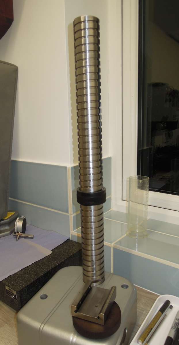

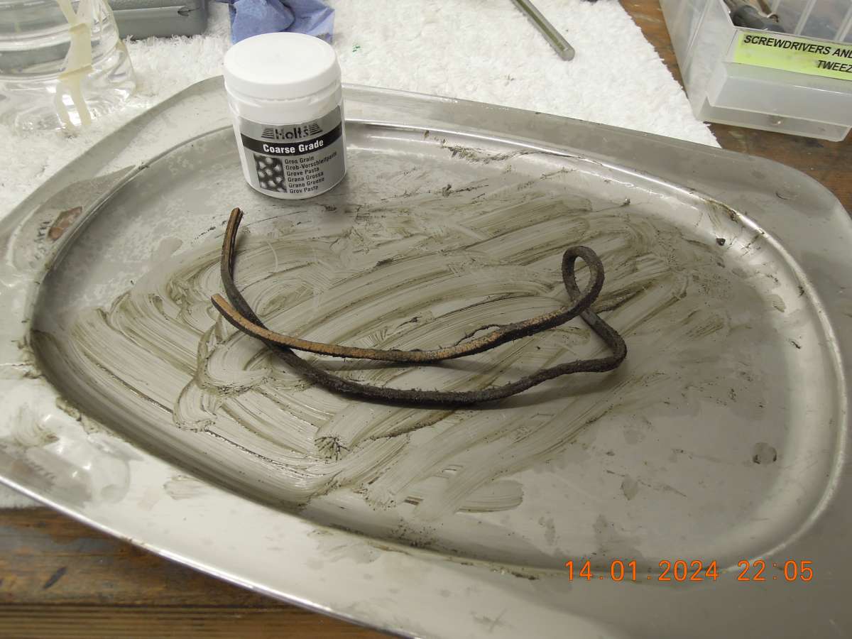

                                                Its been a while but the job is done!
                                                I couldn’t get Evapo-rust as everywhere seemed to be out of stock at the time so instead de-rusted a short section with citric acid to see what this would look like. The citric acid got rid of the obvious rust, but left the surfaces a dull grey. Unfortunately it didn’t shift the rust and dirt in the corners of the grooves. I then experimented with fine wire brushes in a Dremel to try to get into the crevices. Sadly this proved to be such a so slow and tedious job that I gave up, put the task on hold, and got on with something else more productive.
                                                After some time I decided to invest in a fixed steady. Mounting this very heavy bar was a challenge. Normally one would put the workpiece in a 3-jaw and arrange the steady to suit. Unfortunately I had to use the 4-jaw which meant a lot of juggling to ensure that the bar rotated parallel to, and concentric with, the spindle axis before I could call on the steady for help. (With such a heavy bar that wasn’t easy!) In the end, the steady enabled me to clean up the OD, but unfortunately didn’t really assist with the grooves.
                                                After another break I decided to try something I can considered at the outset but forgot about. I cut a 1/8″ strip of leather from an old belt and impregnated this with coarse valve grinding past to which I added some WD40. I put the bar in a vise then wrapped the strip around the shaft so that it filled half to threequarters of a turn of the helical thread. I proceeded to pull each end back and forth on the ends and was totally surprised by how low the friction was and how easy it was to do. Not only that, but with 10 or so pulls, both the sides and the base of the grooves were clean and shiny. It was then just a case of re-gritting the strip and repeating in the next groove. I thought I would have to do the whole thing again with the fine-grit paste but this wasn’t necessary. After a clean-up, the finish/texture with the coarse grit proved to be just what I was hoping to achieve.
                                                Here is the result and the ‘tool’.
                                                DSCN0512DSCN0514
                                                I hope this gives ideas to anyone else tackling a similar task. Thanks to all who provided food for thought.
