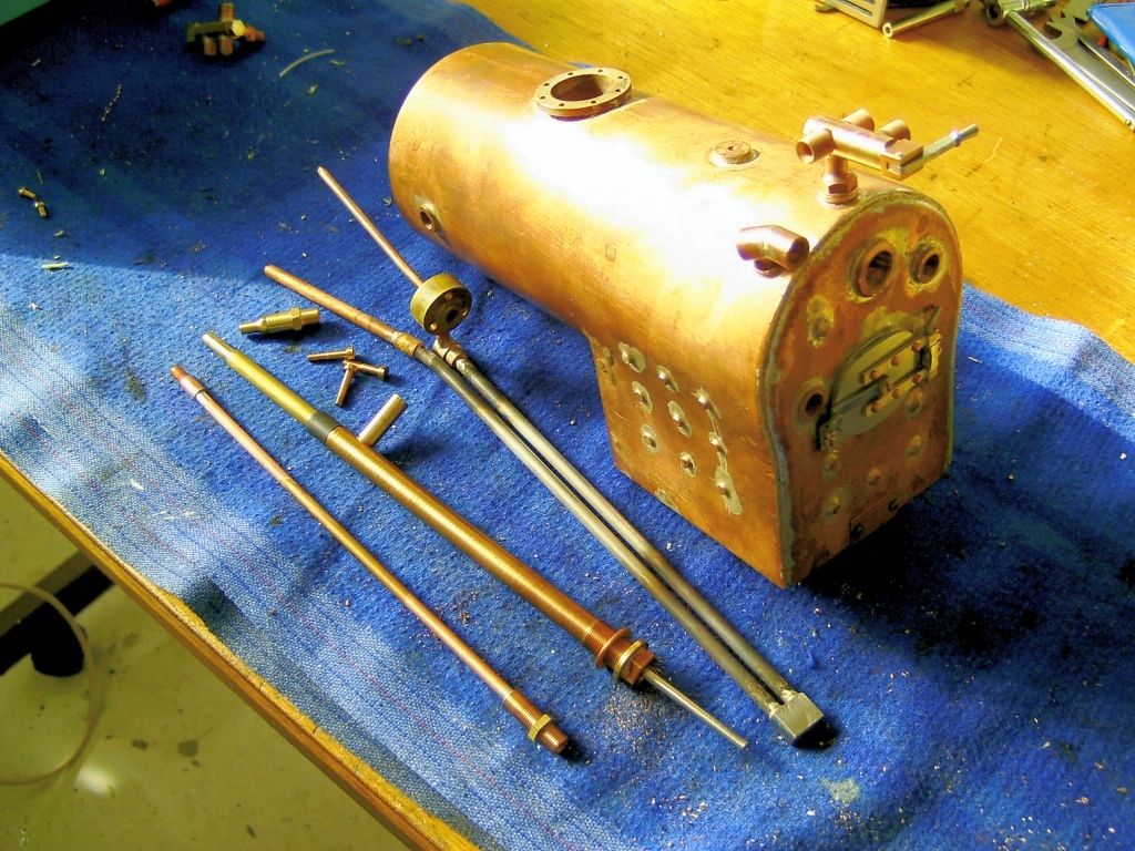

      Hi, I,m currently helping a friend progress with building a Tich loco he started 40yrs ago. We are close to assembling his boiler parts but have got stuck trying to source some thick walled (5/32 OD x aprox 1/16 ID) copper tube for the hollow stay. I can find some 22g but as this has to be threaded 5/32×40 it only leaves 12thou at the root — not good for a boiler stay
      I know it was available 'cos I have it in my own Tich boiler (which was not built by me)
      Any suggestions where I might get some would be much appreciated.
      Keith.

          As a different approach what about an external feed (between the frames??) to the blower and add an extra solid stay?

                Or consider using 3/16 x 16swg (= .064" or 1/16" wall thickness) which is commonly available? Adjust threads and fittings (bushes etc.) to suit 1/32 diameter increase.

                  I finished off a couple of Tich boilers for someone some years back and had the same problem. I just used ordinary thin wall copper tube and silver soldered bronze ferrules on the ends. One was threaded to screw into the blower valve and the other threaded 1/4 x 40 to screw into the bush in the front tube plate. You could also just silver solder the tube into the blower valve. I did that on my Helen Long boiler.
                  Not a good photo but you can see the blower stay at the bottom. You don't need the double threaded fitting on the smokebox end. The end of the ferrule is countersunk and the blower pipe just fits straight onto that.

                    3/16 16swg copper tube is available from Blackgates in short lengths delivery normally by return.
