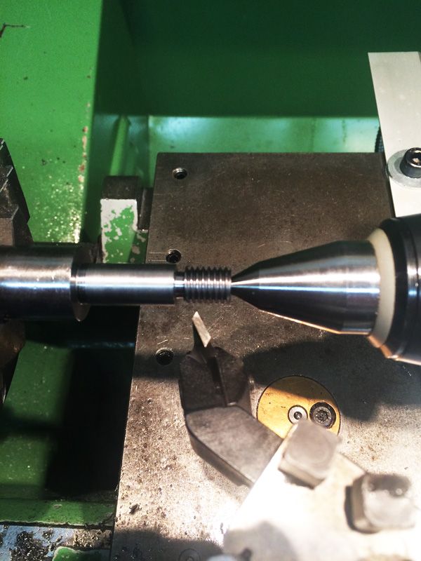

          Nick
          Chuck the stock, face off, then use the strap you have just made as a gauge for turning the outside dia. of the sheave to fit ( don't forget 1 1/8" first to fit the recess in the strap then 1 1/16" for the rest – easy to get it the wrong way round and produce a "scrapper!) . It's best to leave the 1 1/8" a little large at first and concentrate on getting the fit on the 1 1/16" good. Easy to take a bit more off the ridge later to get a good fit. Face off then remove from the lathe and, from the centre ( which will be apparent from the turning marks), scribe a line 9/64" below the centre and centre pop. Put back in the 4-jaw and adjust so that the centre mark runs true. Centre drill, drill and ream 7/16" then reduce the O/D of the boss to 11/16" dia. Lastly remove from the lathe and cross drill and tap for the grub screw.
          It worked for me- I've not made this one but I did make the "Real" , which uses the same parts, years ago.

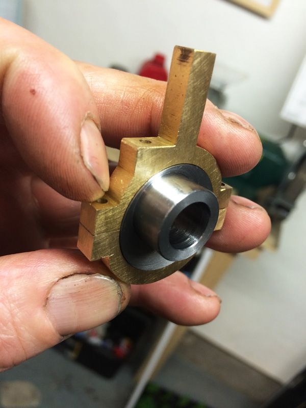

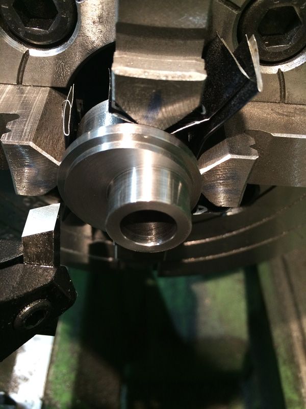

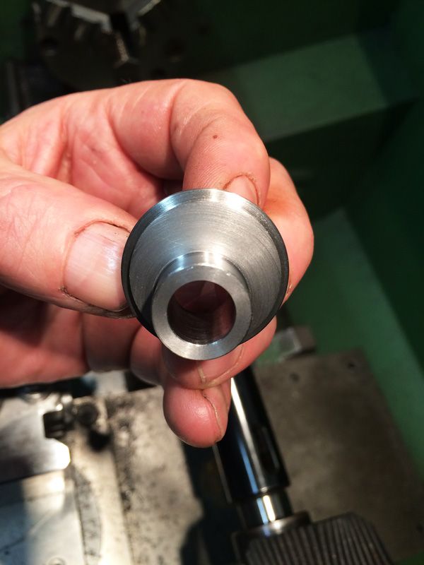

                  #172286
                  Nick_G
                    @nick_g

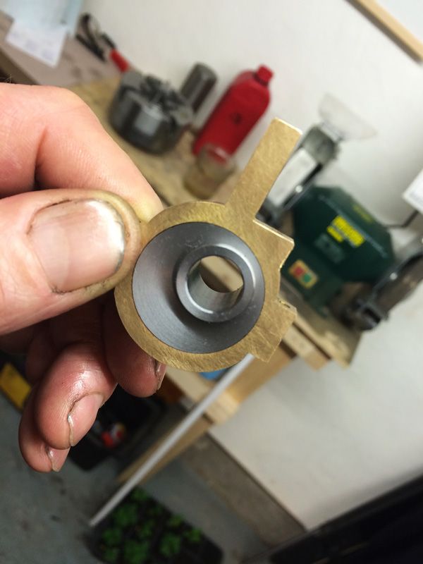

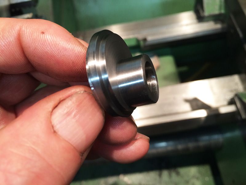

                    I managed to make a right 'dogs danglers' of the eccentric on my first effort. blush
                    So with some new steel I had another dabble with lessons learned and a clearer mind.
                    Think I will go over to the valve chest next during the weekend. yes
                    And especially for Jason perhaps even some PCD holes. wink
                    Nick

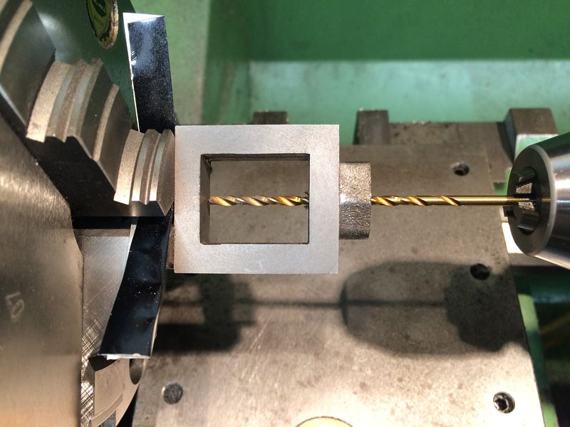

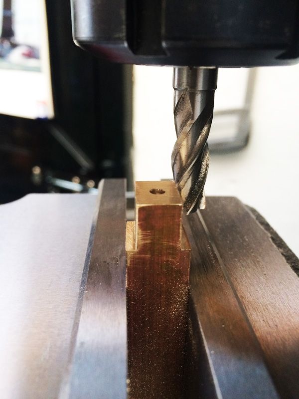

                        #172567
                        Nick_G
                          @nick_g

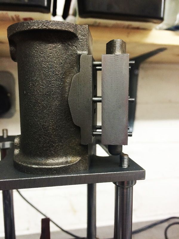

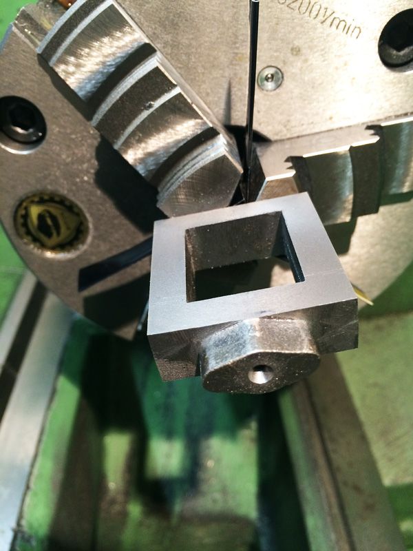

                          Valve chest has been today.
                          I faced off the sides in the 4 jaw on the lathe both the chest and it's cover.
                          Then into the 3 jaw to drill for the valve rod. There is a slight offset on to one side for this.!
                          A long series drill was needed to drill the valve rod guide pocket.
                          Advice was sought and excellently given to me on another thread about the use of super glue to keep the parts in the correct position for drilling the studs.
                          The tapping dia was run through the cover, valve chest and cylinder castings.
                          The guide holes were then opened out in the chest and cover.
                          This worked out very well so thanks for the super glue tip and to all the others who have assisted me thus far.! laugh
                          Nick
                          Edited By Nick_G on 14/12/2014 20:03:30

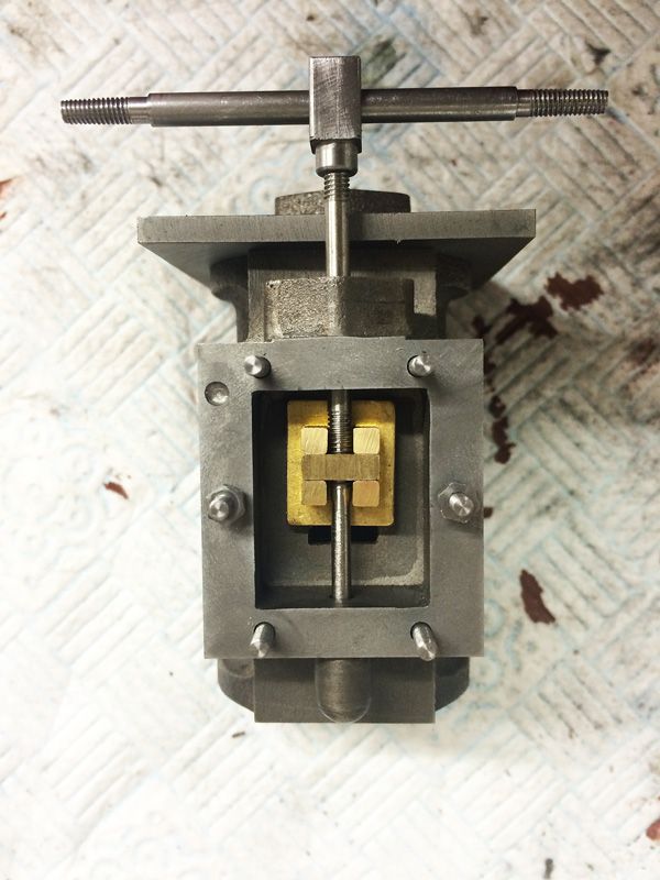

                          #172765
                          Nick_G
                            @nick_g

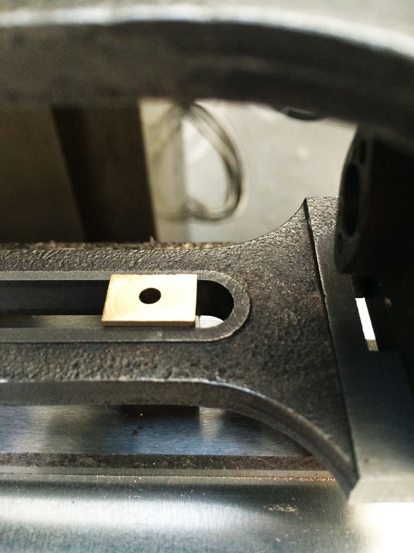

                            Have done some work this eve on the valve, it's rod, cross bar and the jointing piece.
                            But which way does the valve install. The way it is shown here or rotated 90 degrees.??
                            Cheers, Nick
                            #172780
                              The 9/16 is the width and the 21/32 the height so looks like you have it the right way round, though I would turn it 180 degrees as the slot should be closer to the top edge than the bottom.
                              #173063

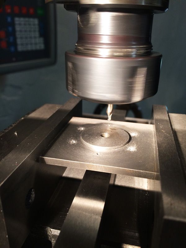

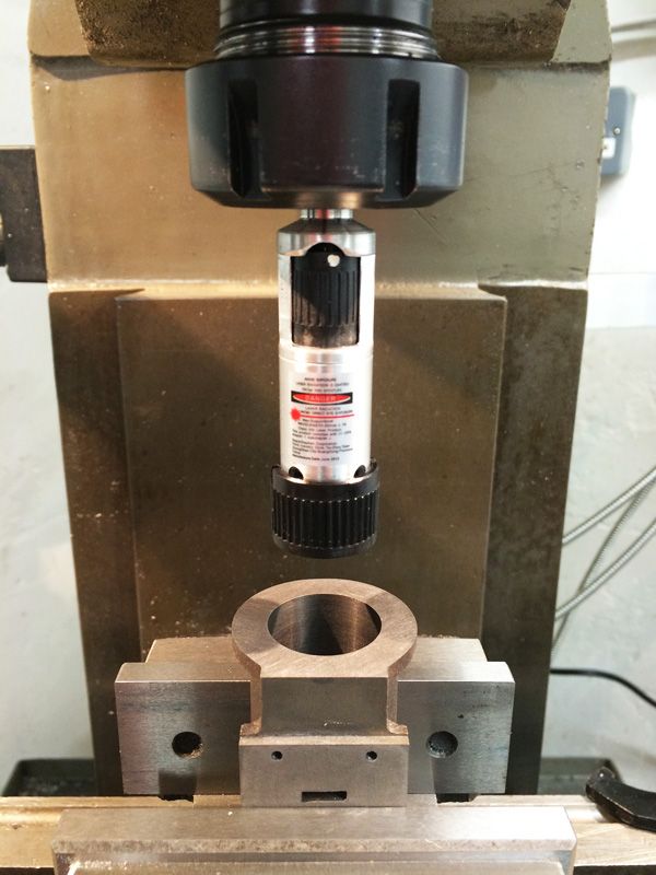

                                #177425
                                Nick_G
                                  @nick_g

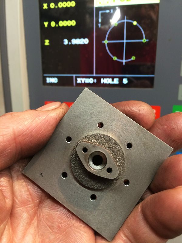

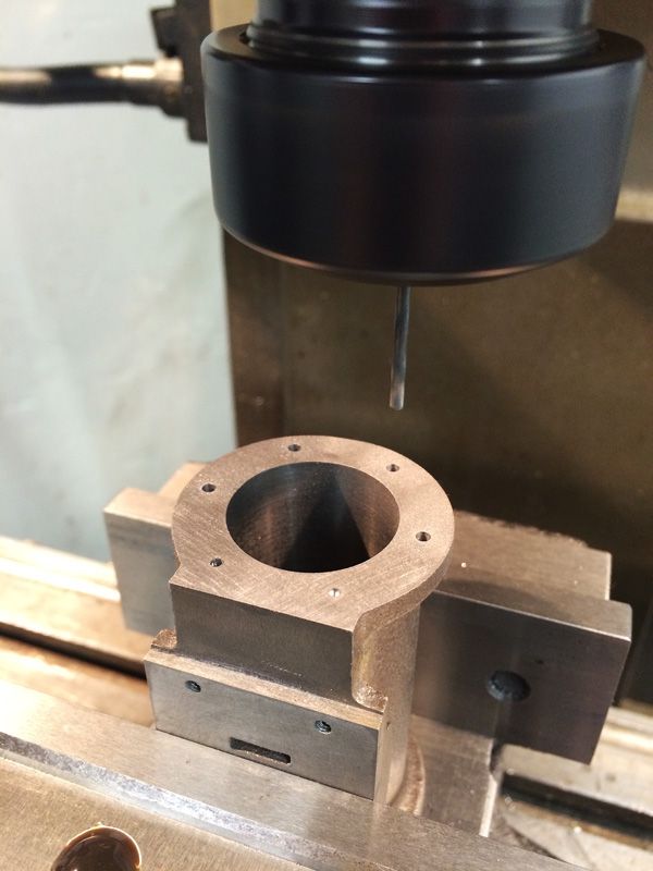

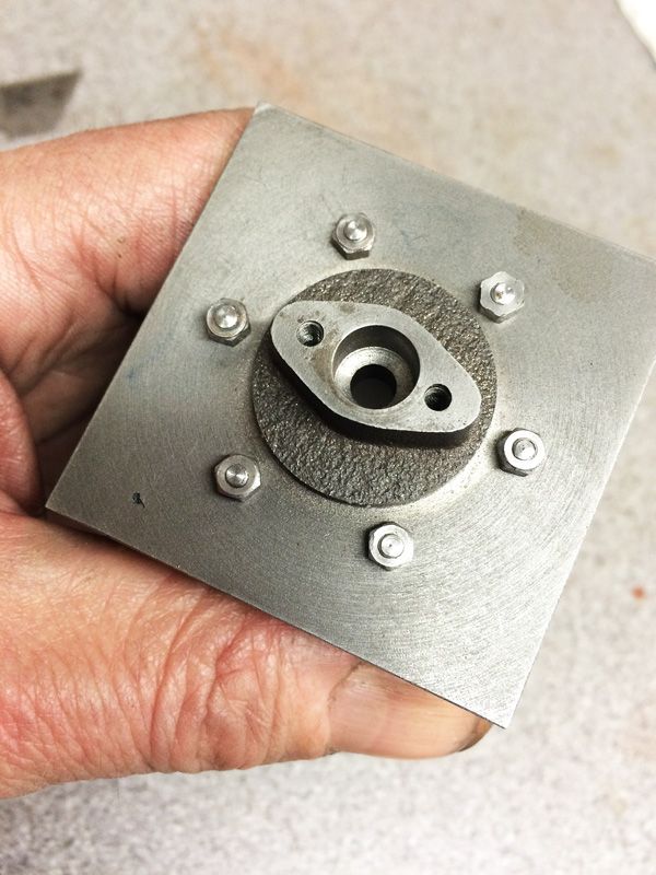

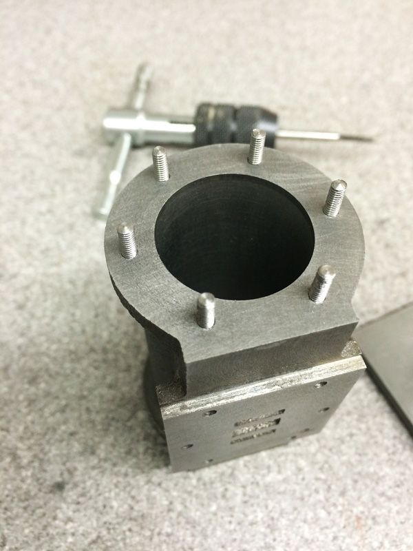

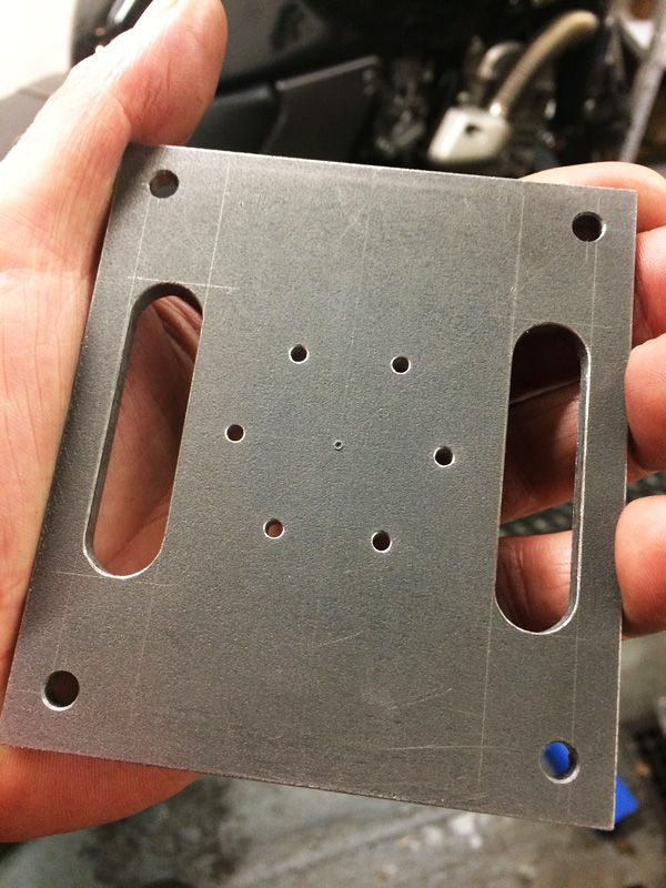

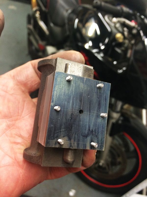

                                  OK guy's. Back on parade again now after a 'sabbatical' of decorating and tiling. angry

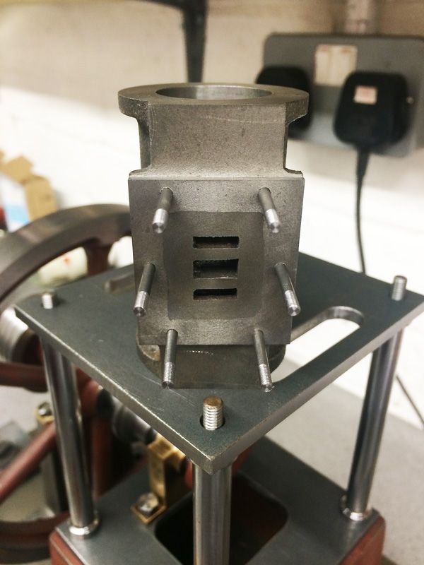

                                  So we jump onto the long awaited PCD holes associated with the cylinder and the ends that join onto it.
                                  I did a trial run on some scrap yesterday and this eve started with the most easily remade part if I made a dogs-danglers of it. So I first did the cylinder bottom / supporting plate.
                                  With that done seemingly OK I next did the cylinder head. First spotting with a small center drill and then 7BA clearance holes.
                                  I used a laser edge finder to find the center of each piece so that I could then punch the center into the DRO
                                  7BA tapping size drill was then used on the cylinder head. – Nearly dropped a clanger as originally picked up the 7BA clearance drill. Fortunately I realised before it was too late.! blush
                                  By this stage I am wondering if it will all fit.?
                                  It does. ………….. So no four letter words were required. ( not that they would have fixed it wink&nbsp
                                  So Nick goes to bed a happy-chappy tonight. smiley
                                  Nick
                                  #177431
                                    Looking good Nick and I like the way the hole positions are displayed as it gives you a visual check before you start drilling.
                                    #177432

                                      #177465
                                      Nick_G
                                        @nick_g
                                        Posted by JasonB on 27/01/2015 07:35:29:
                                        Yes. I found that very helpful. I could see that I had originally entered the wrong start and end angles.
                                        Taking that aside the menu on the unit is very intuitive. – I only had to read the manual once to do the PCD's
                                        Nick

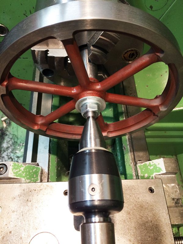

                                        #177801
                                        Nick_G
                                          @nick_g
                                          I know I am jumping ahead of the game here as the engine is not finished. But just thinking for the future.
                                          Would this **LINK** boiler be OK to run the James Coombes.
                                          Thanks, Nick
                                          #177913
                                          Nick_G
                                            @nick_g

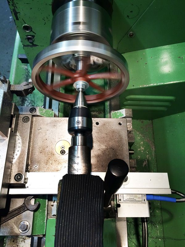

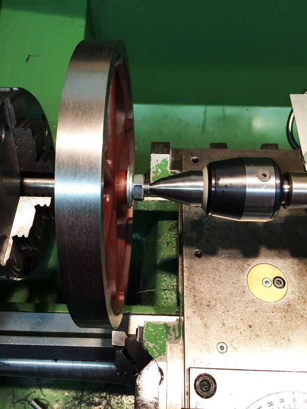

                                            I don't know if anybody else is the same when they return to a project. But after a month away from the engine I find I am having to get back into the swing and rhythm of what I was doing previously.
                                            I was never happy with the finish that I had upon the flywheel. It's accuracy I was happy with but I did not feel the surface was good enough to get a nice polish on. So I decided to reface it with the Eccentric engineering tool holder that I had purchased since the original machining.
                                            I did not fancy trying to dial in the 3/8" crankshaft bore back in on the faceplate so I decided to make a mandrill with a snug fit to the bore of the flywheel. I had some EN24 that I had liberated from a friends scrap bin so used that and cut a 10mm thread on the lathe to hold the flywheel secure.
                                            Cuts of about 5 tho to all sides with a freshly sharpened tool gave a much sweeter surface that I should now be able to polish.
                                            Hope to be able to make some more progress into fresh areas this week end.
                                            Nick

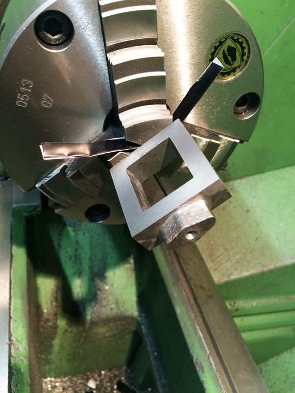

                                                    #178060
                                                    Nick_G
                                                      @nick_g
                                                      Hi Nick, you're sounding more like Guy Martin than Valentino Rossi but that's no bad thing!!wink
                                                      Martin.
                                                      My likeness to Rossi ends usually within 100 yards of me setting off and realising what speed I am doing. This is then followed by me chopping the throttle well before the first corner so I can go round it at the same speed my grandmother would have. blush
                                                      Anyway, back to the build.

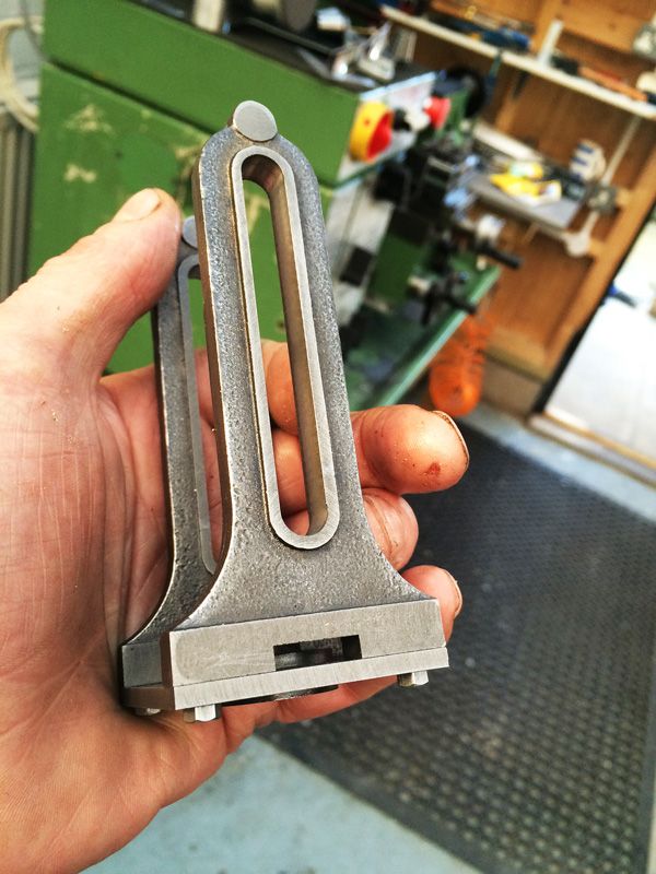

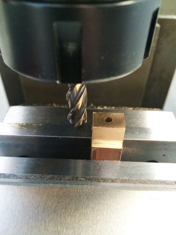

                                                      Today I drilled and fitted the crosshead guides.
                                                      I then have made a start on the cross heads.
                                                      After I finish the cross heads I will move onto the con rod. On the James Coombes this is a 'Y' shaped affair. This by the look of it will probably be a none too easy exercise for a newbie like me so any tips will be welcome.
