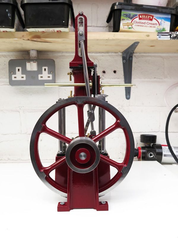

      Looking beautiful, that shade of red really sets it off
      #182875
      Nick_G
        @nick_g
        Posted by Nick Grant on 10/03/2015 15:03:58:
        It's Humbrol Crimson No.20 if you are interested.
        I wanted something different from Brunswick green. It's a great colour but it seems 95% of Stuart engines get painted with it. laugh

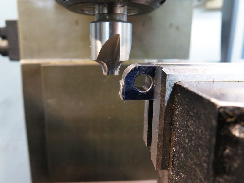

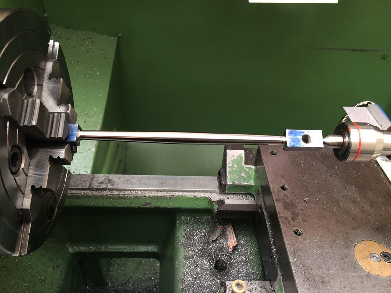

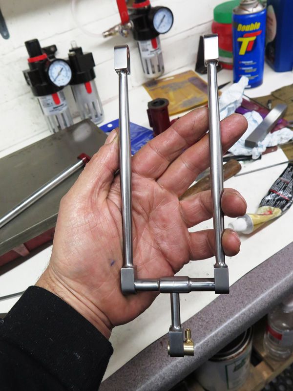

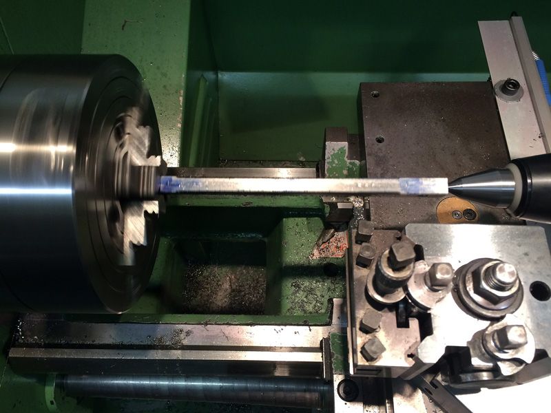

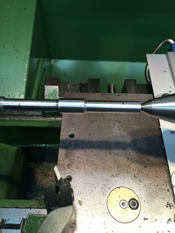

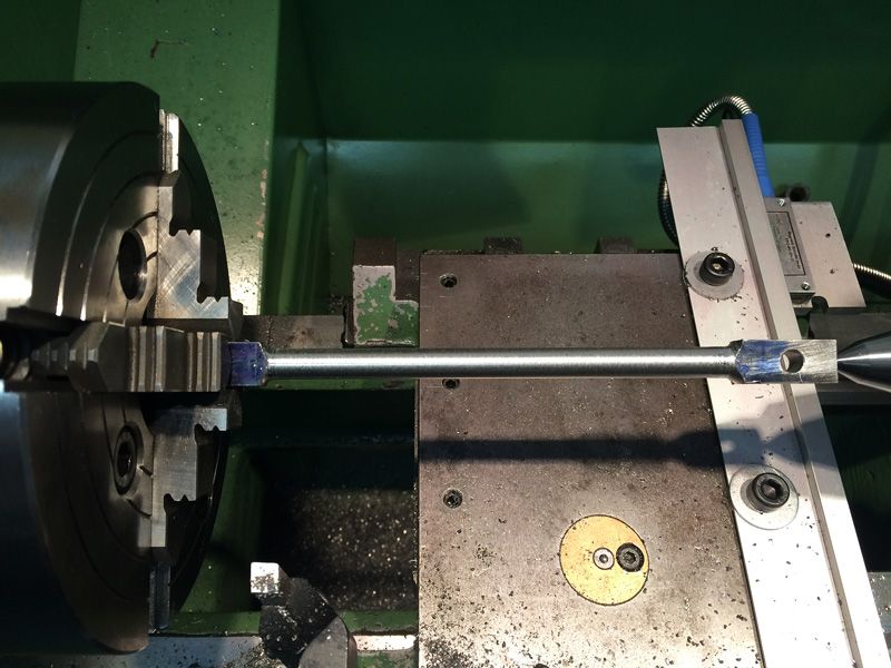

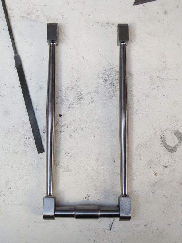

          Last weekend I started the Y shaped conrod. Did not get as far as I would have liked. But what I did manage to get done I was happy with.
          Managed to get a bit more done today and it's progressing. smiley
          I first made the center / cross piece of the conrod. (with the center 'beefed' up a bit from the drawing) The ends have to be dropped to 1/4" to locate into the rods risers.
          Next was the 2 risers. These are made from 1/2 x 5/16 bar. The center section of each is turned round and then a 'fish belly' taper to each end.
          A short video of the interrupted cut can be seen here :- **LINK** (sounds like an old motorboat)
          As recommended by the ever informative Jason the holes at each end of the bar was done before the turning.
          Then the 'fish bellies' were done with the compound set at 1 degree and blended in with a file and emery paper.
          Ends were trimmed to remove the center drill and live center pockets and milled on each side.

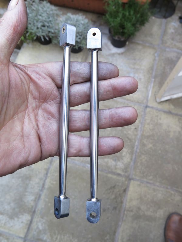

          A bit of dressing with a file and they are starting to look the part.

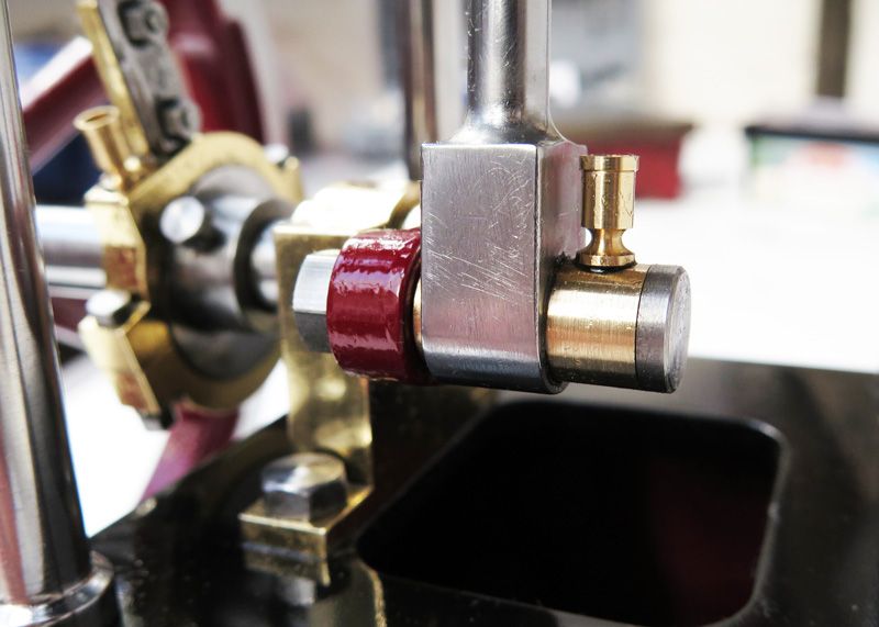

          I also decided to add a small brass bushing that has the 1/8th hole in to the top.
          So just some polishing and the bottom center riser made and I will then be close to blast off. Unless we have a Houston type 'problem'.! sadwink

            Looking Good, Nick
            #184091
              Have you deviated from the drawing re the bottom ends for a good reason or chickened out of making them roundsmile p
              Look good all the same and the fish bellies turned out well
              J

              Nick_G
                @nick_g
                Posted by JasonB on 21/03/2015 21:01:41:
                I think Moused out would be a better description. blush indecisionblush
                Nick laugh
                #184095
                  I hadn't even noticed blush
                  … presumably they should look like the ones pictured here.
                  #184099

                        Actually thats a nice little feature on the one Michael linked to, the oil cup and through bolt to make it look a bit more like a split bearing with strap, wedge and cotter which would only have been on teh ends where there is rotation, the goint to the cross piece being static
                        Now if you would like me to tell you how to make ends like this just askdevil

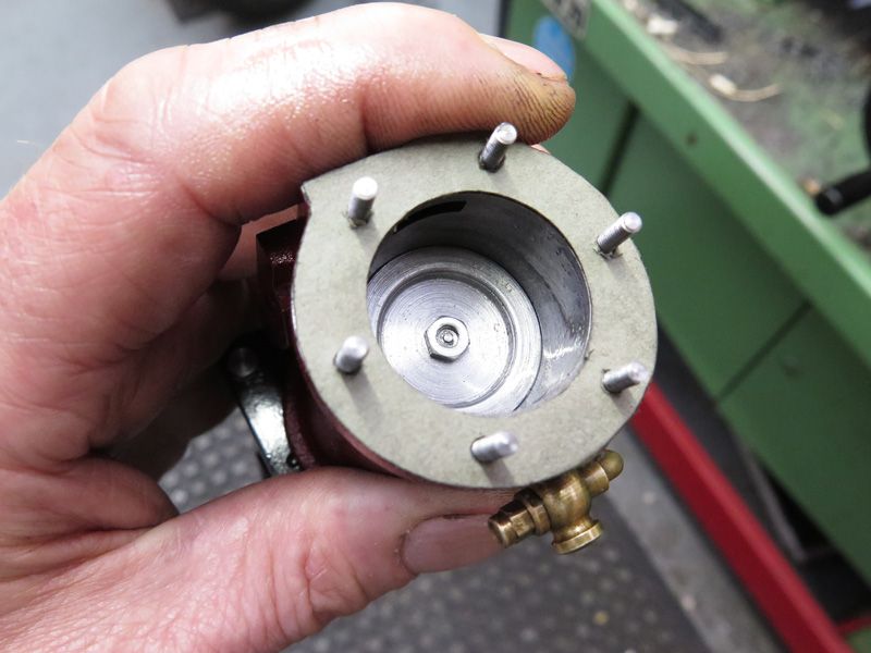

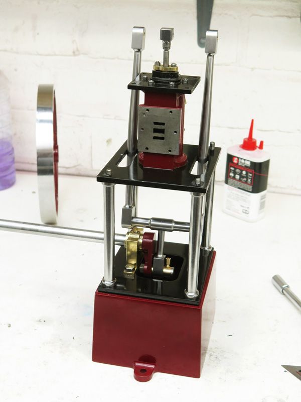

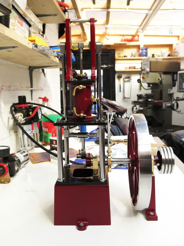

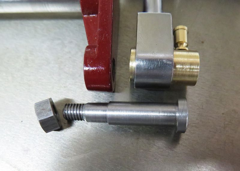

                                The conrod Was assembled with loctite and pinned through the joints with silver steel.

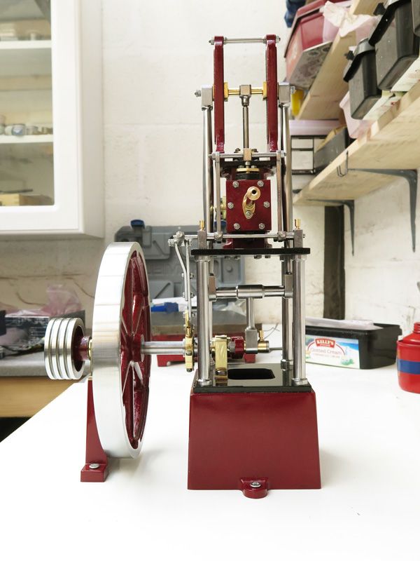

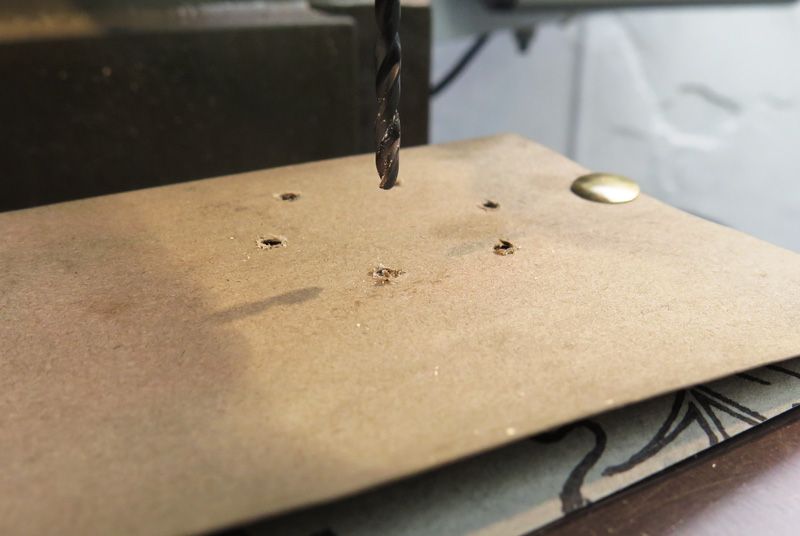

                                Getting serious now! Gaskets were made and the ones for the cylinder ends were assisted with the use of the PCD function of the mill DRO.
                                The crank pin was made out of EN24 – The last piece.! smiley
                                Final assembly began. devil yes
                                And here she is. …………….. Finito.!!!!!!!! smileylaugh
                                So that's my first build done. smiley
                                Need to put it on a nice base and build or buy a boiler so that it is actually a steam engine and not a compressed air engine. wink
                                What to build next.???? Decisions, decisions, decisions eh.
                                I would also like to thank the members of this forum that have assisted me in getting this far. Both those that have contributed directly to this thread and other information that I have picked up elsewhere on this site made by others. I would not have been at this stage without you. ………. Cheers guy's.! smiley
                                Best regards, Nick

                                  Very nicely done Nick, look forward to the video of it running on air.
                                  Nice touch adding the oiler and extended bearing to the big end
