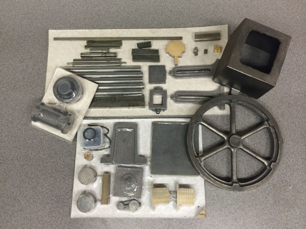

      Nick_G
        @nick_g
        With a box of bits :-
        So in the famous words of Captain Lawrence Oats. " I may be gone some time."

            Good luck with the build Nick. One thing I found with the S50 kit was that some of the stock supplied is only just slightly larger than the part to be made, a bit mean considering the cost of the kits. I found it useful to have some spare stock in the appropriate sizes to give a bit more room for manoeuvre and also if I made a mistake I could have another go immediately without waiting a few days for metal to arrive.
            Gary

            Nick_G
              @nick_g
              Posted by GaryM on 28/10/2014 21:58:56:
              Gary
              I have just noticed this.!

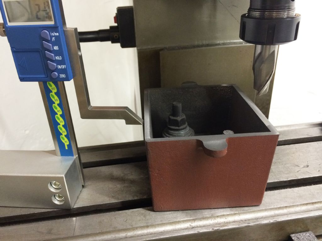

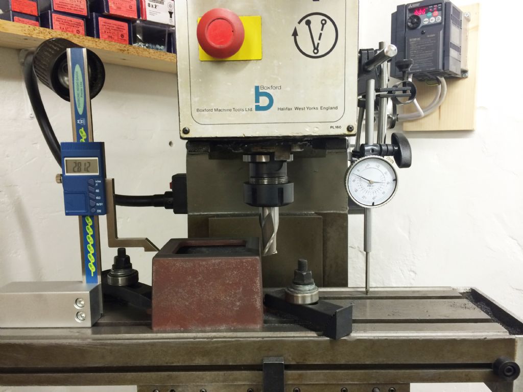

              On the James Coombes there are 2 plates. The supplied stock is slightly smaller than the specified size on the drawing before I even start to square them up.
              These are not critical parts so long as they are both the same. But that is not the point now is it.??? – The parts and their placement that go onto these plates however are critical.
              Anyway. I have squared them up and this gave me a good excuse to have a play with the new mill and its associated sundries I have purchased. smiley
              Bad news is I have come to the conclusion I need to buy a height guage. sad
              Nick

              Ed Duffner
                @edduffner79357
                Is it finished yet? smiley
                Would a scribing block give you the accuracy Nick?

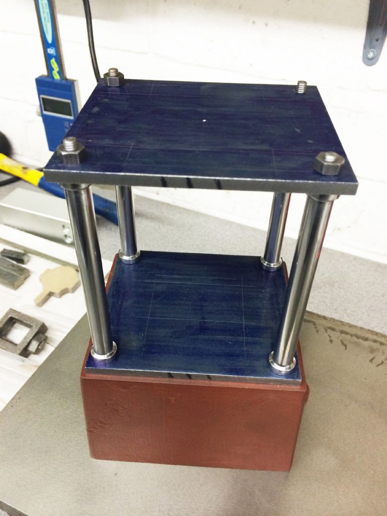

                  #168206
                  Nick_G
                    @nick_g
                    Painted over a few castings yesterday with a preliminary coat of red oxide and this evening I sized up the pedistal / base.
                    Nick

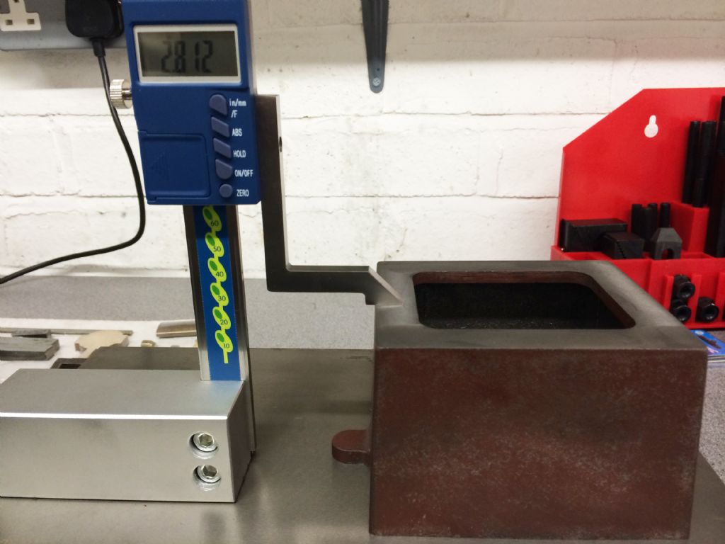

                    #168260
                    Nick_G
                      @nick_g

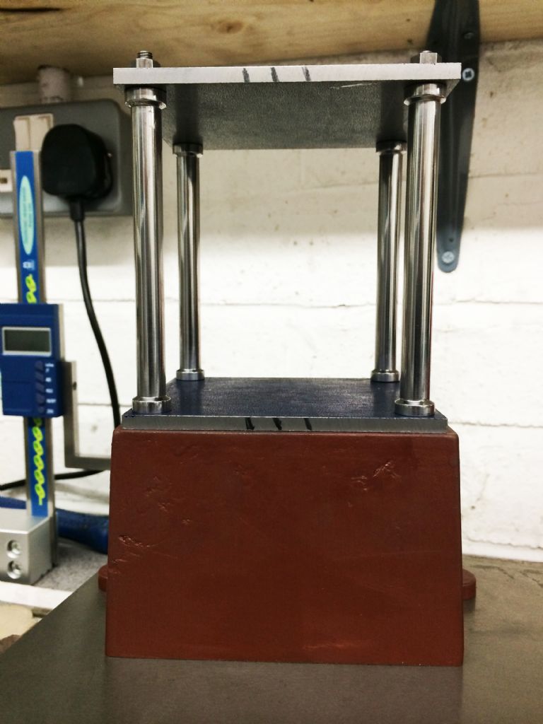

                      It's getting taller.!
                      I will trim the studs that go through the top plate to make them all the same length.
                      Also on examination there is a casting that provides a pedistal for one of the main bearings. This is a bit banana shaped. So I rang Stuart's today and they are putting a replacement in the post.
                      Nick

                        Wow, you don't waste time, looking good keep the pics coming.
                        It looks like your getting to grips with the new milling machine.

                        #168264
                          That's comming on well, don't polish those columns up too much, the paint won't sticksmile p

                              #168323
                              Nick_G
                                @nick_g

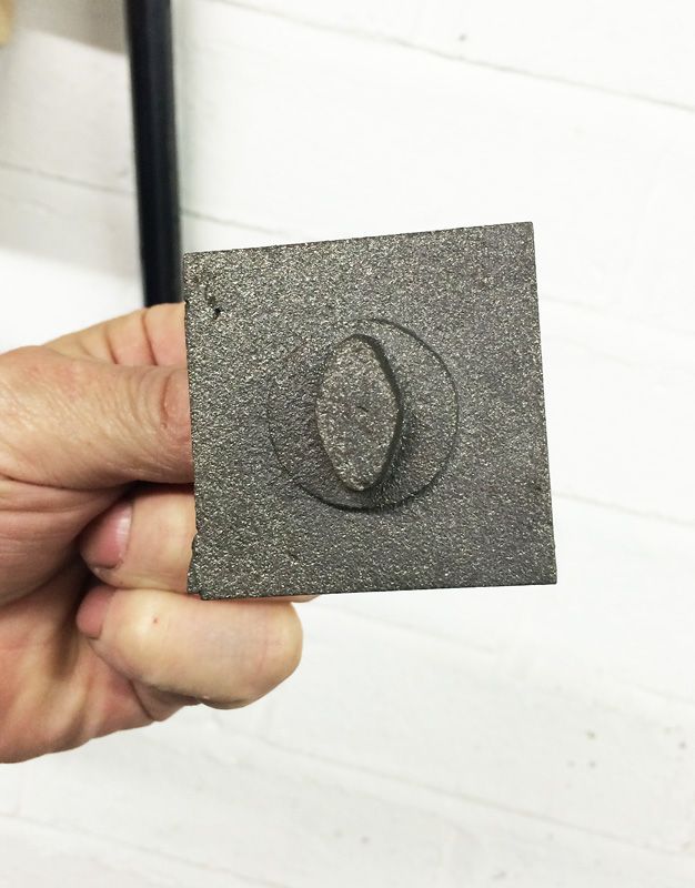

                                Posted by Nick_G on 31/10/2014 19:08:46:
                                Nick
                                It gives me pleasure to report that less than 24 hours later from the phone call a replacement casting has arrived from Stuart. (a straight one. wink)
                                Nick

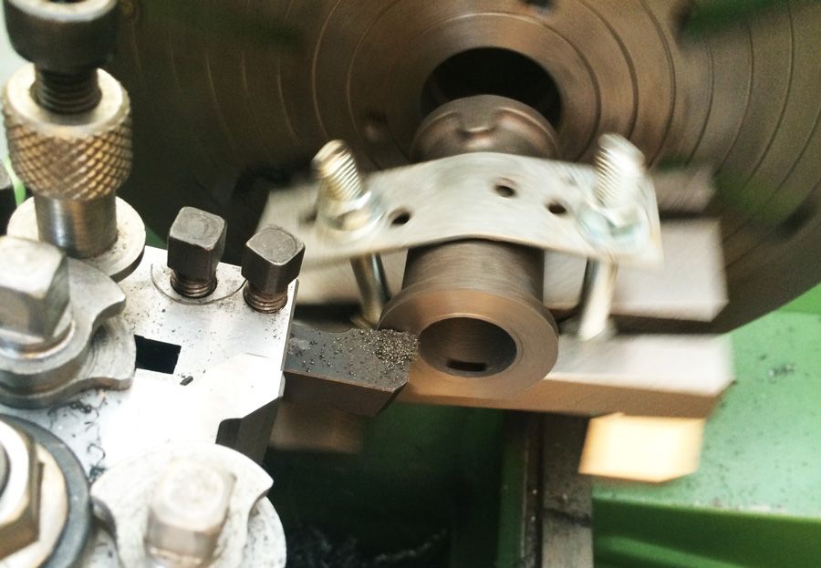

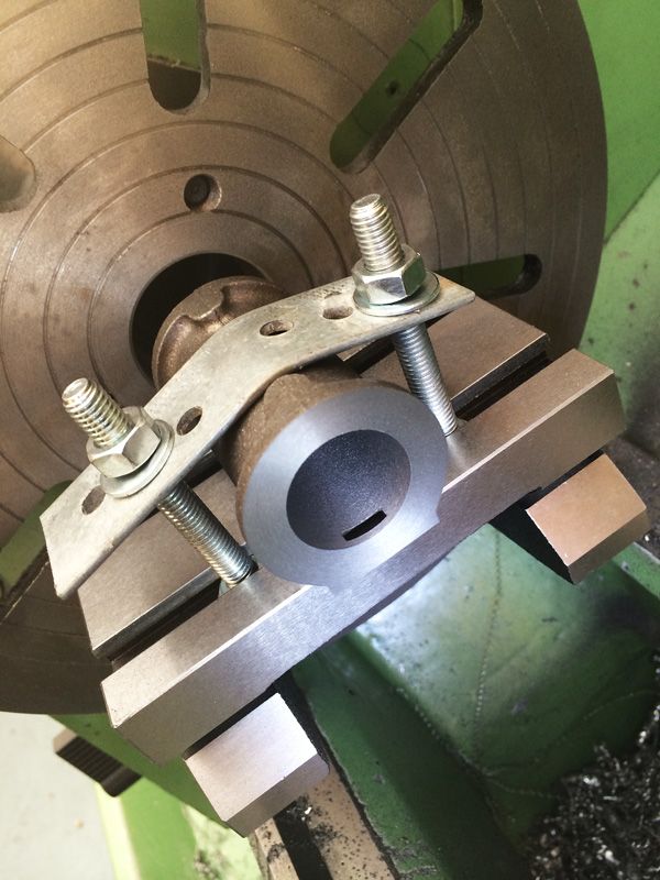

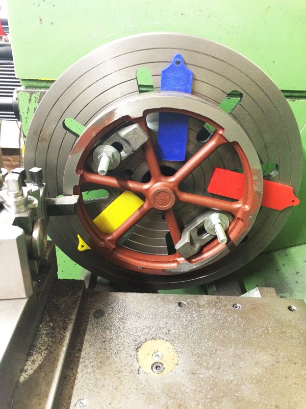

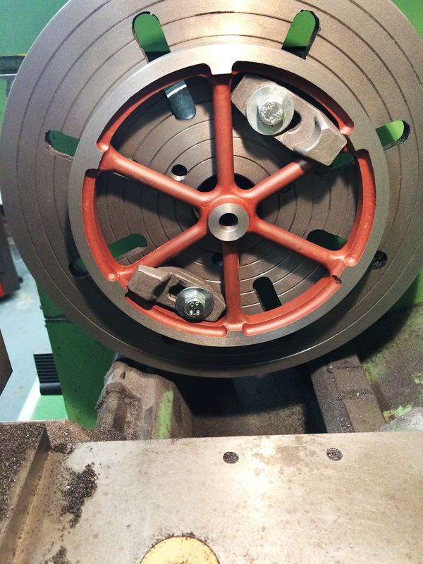

                                      Hi folks, back on parade with a little bit more construction. I did intend to spend the entire of last Sunday in the workshop but due to my own stupidity wink Sunday was a total write off due to the mother of all hangovers and I spent it lay on the sofa feeling sorry for myself while cursing myself. crying
                                      Anyway, the cylinder has been attacked.
                                      The port face had been milled prior to the boring and facing operations.
                                      The flywheel has also had some disciplinary corrective treatment issued. The first side was faced and turned. Also at this setting the bore was drilled and reamed. (not shown)
                                      Video can be seen here :- **LINK**
                                      The flywheel was then flipped over and centered so the other side could be faced.
                                      Nick

                                        Hi Nick. All looking good. Just a bit worried about those clamps. I thought you had to have a packing under the lower edge to make them clamp properly?
                                        Bri

                                        Boiler Bri
                                          @boilerbri
                                          Just watched the vid. What's the coloured packings ?
                                          Bri

                                          Nick_G
                                            @nick_g
                                            Posted by Boiler Bri on 05/11/2014 22:03:12:
                                            Bri
                                            Do I.? ………….. Ooops. blush
                                            It does seem however that I 'got away with it' ………… This time.!
                                            Thanks for the info. I shall know better next time.
                                            Nick
                                            #168745
                                              Looks like the clamps actually wedged themselves between two spokes rather than just the cranked end holding things down. Also make sure the bolt is near the work end not the support end like you have them.
                                              Oh and hold your phone the other way round when doing a video, thought a photographer whould know thatsmile p
                                              Comming on wel though

                                                #168764
                                                Ian S C
                                                  @iansc
                                                  Nick, on the flywheel casting there should be packing under the spokes, so that the clamp presses down on the spoke and the packing against the face plate. To get adequate clamping without the intervening packing risks breaking the spoke, or if like most of my flywheels the spokes will bend as they are made of hot rolled plate.
                                                  Ian S C

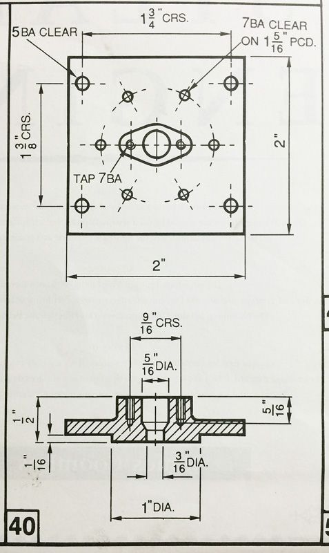

                                                  #169608

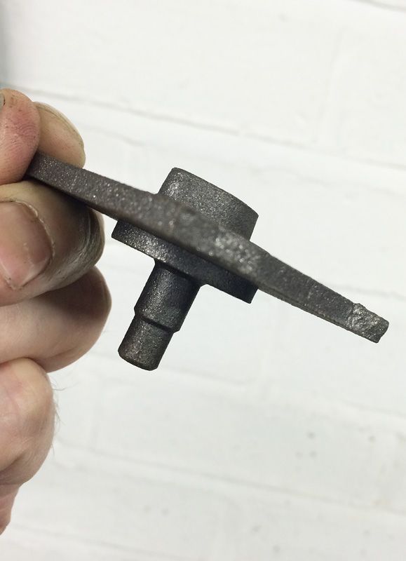

                                                  Nick_G
                                                    @nick_g
                                                    Bit of help please guy's. laugh
                                                    Whats the best machining process / order to turn this rascal :-
                                                    Into this :-
                                                    I presume the spigot in the bottom of the casting is to assist in holding during the process.
                                                    Many thanks, Nick
                                                    #169620
                                                    Paul Lousick
                                                      @paullousick59116
                                                      Nick,
                                                      I would center it in the lathe chuck, face the back and turn the boss first which will give you a datum face and location diameter to machine the opposite sides and remove the location spiggot.
                                                      The drawing does not show any surface finish or tolerance for dimensions. Check it they are required before you start machining.
                                                      Paul.
