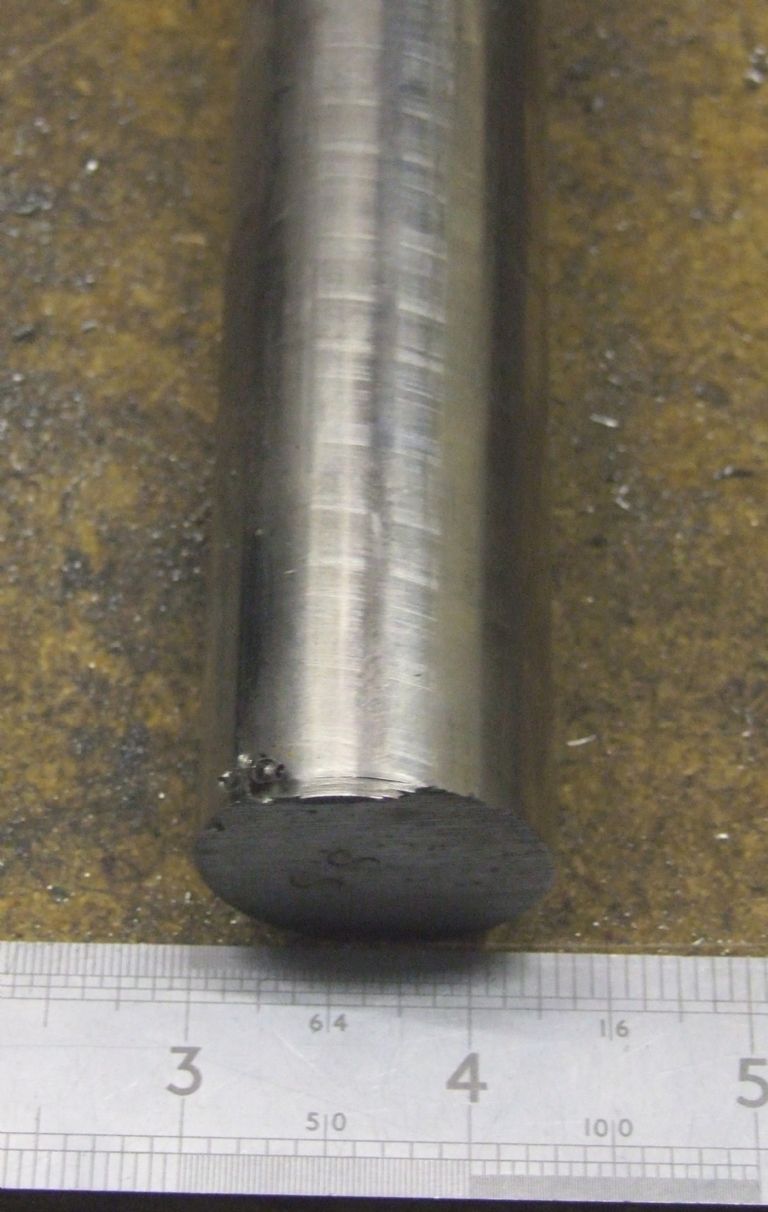

        To pick up on a post I made earlier in the thread on ‘Travelling Steady’, I’ve dug out the material that has a helical finish on it:
        Rather stupidly I’ve stamped it only with ‘SS’, so I don’t know exactly what grade of stainless steel. However I suspect it would be 303, as that is the grade I normally buy for general turning. Interestingly the pitch of the helix is quite fine. It is the only material on which I’ve seen such a finish.
        Measurements around the circumference show a maximum variation in diameter of 0.02mm, a bit under 1 thou in old money.
        Regards,
        Andrew

          I’ve had the coarser pitch like Graham’s on some MS bar. As I wanted it for a traction engine back axle I had to resign it to the stock pile and source the bar elsewhere.
          J
          #65504
          mgj
            @mgj
            Having had a look at all my stock, its only the bigger stuff that has the helix.
            Pure guess but there probably comes a point where direct drawing through a die becomes uneconomic or needs an awful lot of horsepower, and they use a roller to form?
            Andrew’s stainless look a bit lumpier than one would expect?

                When Graham first mentioned this characteristic it rung a bell as I was sure I had seen it before on material used at work. I was not sure however this would be on all ‘Cold Drawn Steel’ as I could not remember ever having a problem with basic Bright bar. I can’t recall being bothered by it at home either.
                That is not to say it’s roundness and dimensional tolerance can be taken as gospel – if you want that then you have to go to PGMS – but merely that it’s much better suited to popping straight in a three jaw than ever black ‘Hot Rolled Bar’ is.
                Looking at Andrews image this is exactly what I can remember so have been out to the workshop tonight and had a real good ‘root’ in the metal stock to see if I could find something similar.
                About six weeks ago I purchased from my last company several lengths of En1a in varying diameters. Taking a close look at them there is no real indication of this helical characteristic. To me they look as I expected for ‘Cold Drawn’ . Going through the ‘stash’ however, I find that it is reasonably pronounced on some pieces of EN8 and EN34. What stainless I have though shows none.
                My recollection (and that is becoming a struggle these days) is that this was most prevalent on bars of ‘tougher’ steels. For example we used to order B01 Arne tool steel both in black and bright finish and I’m sure that this (the bright) was where this helix was most prominent almost as if it had been ‘coarsely’ ground though that’s not implying that it was!
                Macreadys handbook gives a good description of the proccesses – I see Graham they denote ‘Cold Rolled’ as an incorrect term but that may, as you say, be an Americanism.
                Some time back I was given some EN24T offcuts by an ex work colleague whose entire works is CNC out put. All the EN24T that I had used todate had been as I would have described as cold drawn but this had a very bright – almost highly polished finish. I haven’t examined it close enough to say whether it is ground or turned but it is extremely smooth. When I asked about this I was told that the material came in as such for use in the automatic barfeeders.
                Could it be then that the ‘helical marked’ material is as described in Macreadys as Centreless Turned as opposed to cold drawn? possibly with this kind of operation in mind. I don’t ever recall specifically asking for it as opposed to black, bright or PGMS
                Whatever I certainly concur with Graham et al that as supplied none of it is really suitable for use for other than the most basic of shafting if it has to go in any kind of a bearing.
                As said however PGMS is very close toleranced and is a pleasure to machine – of which, regretably, my ‘stash’ contains such a limited (very) supply

                  #65516
                  Anonymous
                    Ok, to pick up on some points. I’ve dug out the original invoice for the stainless steel. Turns out it is grade 1.4307, ie, 304L. It certainly isn’t ‘coppery’ in appearance, more kitchen sink! I’ll have to stamp 304L on it tomorrow evening before I put it back on the rack.
                    It definitely isn’t an offcut; I bought the standard 3m length from Parkersteel, based in Canterbury, but they have a big warehouse near Cambridge. Probably a bit late to complain now if it isn’t up to scratch, as I bought it in 2008. I’ve got two 1m lengths on the rack, so I must have used the other 1m. I haven’t got any recollection of what I made with it though.
                    While having a bit of a re-arrangement in the kitchen this evening to move the boilers for my traction engines I noticed, for the first time, that the material I’ve used for the rear axles has a very faint helix, just like Grahams picture. Any out of roundness is better than 0.01mm though, ie, I can’t for certain detect it with an ordinary 25-50mm micrometer. Strangely, in view of Ramon’s comment, the axle material is EN8.

                      I beleive the product shown is what is referred to as peeled bar See here It is smoother than black bar but not as smooth as drawn bar or ground bar.

                        Peeled Bar – You see, I said recall is a struggle at times. I do believe that was the term used by Uddeholm’s for ‘bright’ as opposed to ‘black’ finish tool steel. Most of our tool steel though not all came from them and it’s a term I do remember.
                        Looking at the Macreadys text again (BTW sorry about the poor reproduction – I can scan it again if needs be) and their comments on machinability of Cold Drawn compared with Hot Rolled.
                        Their description of Centreless Turning of hot rolled bar and subsquent final polishing through rotating rollers clearly states a high surface finish to close tolerances.
                        Looks like you have chosen wisely Andrew
                        Could it be that most material is now finished in this way as opposed to basic ‘Cold Drawn’ Everything has moved on so much since my last foot in a machine shop perhaps this is now the norm.
