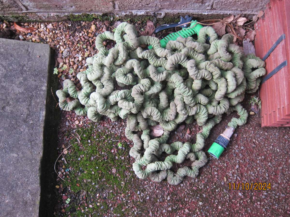

      The attached photo shows my incredible shrinking garden hose which when left to its own devices has the amazing ability to reshape itself into a space of minimum volume. Can anyone explain the mechanics behind this phenomenon and perhaps cite other examples of where this effect is exploited in both the natural world and in the field of engineering?

        It’s actually quite simple, a flexible rubber (silicone?) tube in a sleeve. When pressurized the tube expands until constrained by the outer sleeve. Your personal hose works in a similar manner I believe.

          It’s a cylindrical bellows (elastic corrugated tube) inside a woven cover. The cover prevents expansion in diameter but not length. Water pressue causes the inner tube to extend like the bellows in a pressure guage / switch etc.

            I’ve had one apart (inadvertantly, the end fell off) and it is indeed a silicone-looking tube, but not (on my one) corrugated.
