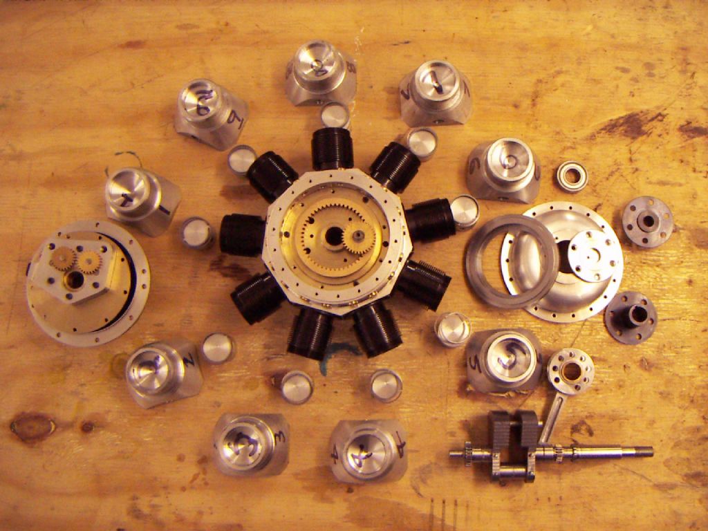

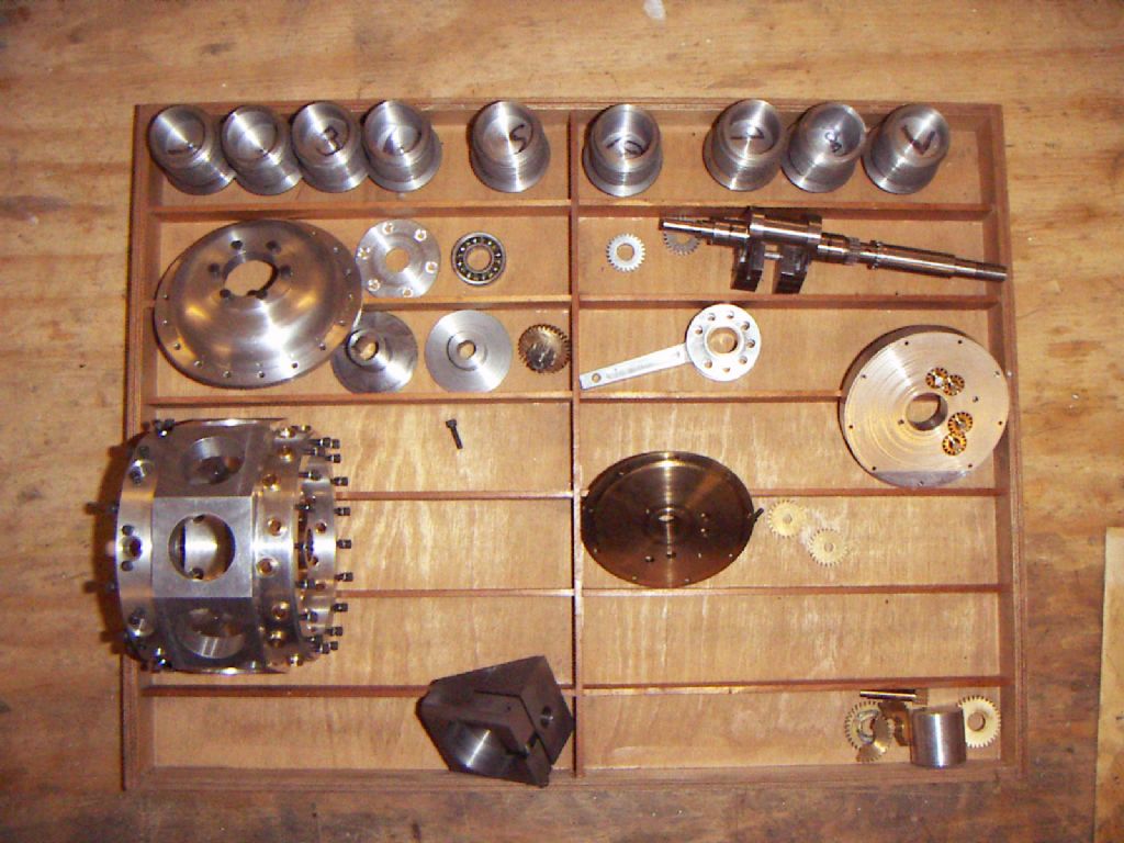

      When I joined this illustrious Forum, I mentioned that eventually I would be dusting off one or two of those projects that, err, aren't quite done yet, most of us have one or two or more. One such is a 9 cylinder spark ignition radial drawn up by Lee Hodgson of Ageless Engines, but ever since I bought the drawings in the last years of the last century, and every time that I rediscover the collection of pieces, materials and tooling, I have become somewhat older, the Management indoors refers to it as the Ageing Engine and suggests that by taking a 'selfie' alongside each picture, progress might have been quicker!!
      I had made the cylinders,pistons and rings; front cover, crank, most of the gears, a functioning oil pump, front and rear bearings, a 'practice set-up ' master rod and had done most of the work on the crankcase and made the fixture to machine the heads.
      The years up to 2010 saw little done and apart from the basic shaping, threading and finning of the cylinder heads on the fixture that I had made in 2004, not much progress had been made. The only other advance was the hot caustic blacking of the cylinders, which was quite successful, though I think that the kit which I used is not available now. The holes for the cylinder studs had been drilled but still needed tapping along with most of the others in the crankcase.
      And then life, and all that goes with it got in the way, as it does with most of us, suffice to say that not a lot happened in 8 years ………..until this week, when after making a couple of tapping jigs, buckets of cutting fluid and several fresh 4-40 UNC taps, I spent more than a couple of hours threading the front and rear bearing shoulders and the cylinder stud holes,all 72 of them. And so the crankcase, after about 15 years since first bolting a slab onto the faceplate, is finally finished!dscf8503.jpg
      Now that the ball is rolling, and the clock is definitely ticking, I'd better do something about the cylinder heads!

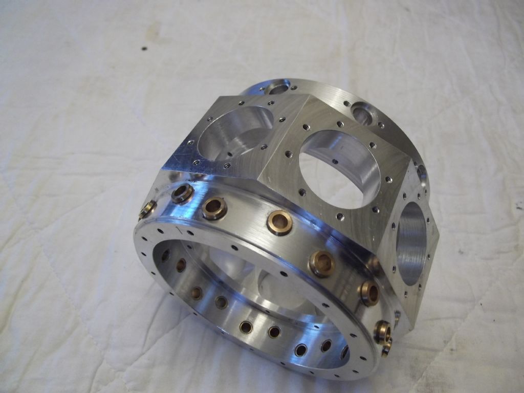

                      Please Neil praise once is quite sufficient, your duplicate post key is stuck….and I can find the imperfections in my work !. And that practice Master rod is most definitely only a practice item.
                      I don't think that there'll be much rushing Michael, it took me about 16 years to drill/bore/mill the 176 holes in that block alloy and then get 131 of them threaded. I am a bit extreme will my projects though,,,,,,,,,,100% attention or zero.

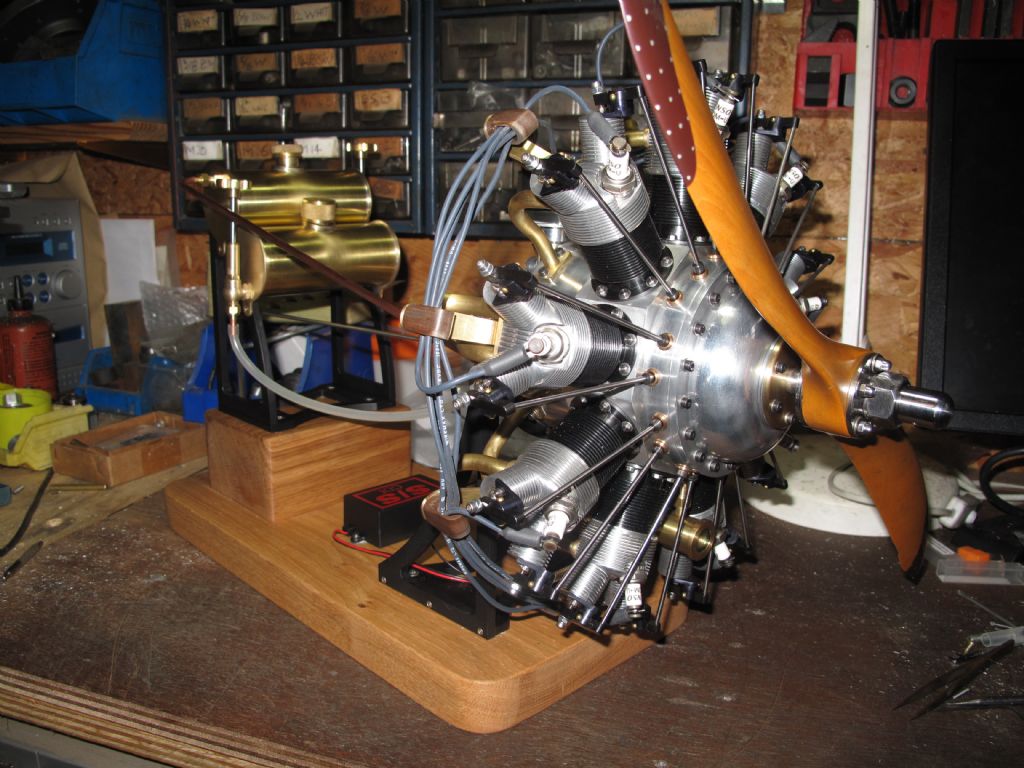

                                    fin 025.jpgHi. Trevor. Stick at it, its worth it. I've finally replied to your PM and I can suggest a less complicated method of machining the heads!!
                                    #348031
                                    Trevor Crossman 1
                                      @trevorcrossman1
                                      Nice piece of work mick ! Is it easy to start and run well ? Good to see a finished example to help keep the show on the road. I'd be interested in your method, bearing in mind that my heads are part machined up to page 126 operation #3 / 19 . So that means that I've cut and threaded the combustion chamber, finned the outer diameter and milled off the intake/exhaust manifold face on all 9 blanks…….did have 10 once! Looking at your picture, perhaps you have used 10mm plugs? They look bigger than my tiddly 1/4 unf ones. Pm me your suggestion, I like easy……too little time for aggravation and frustration.

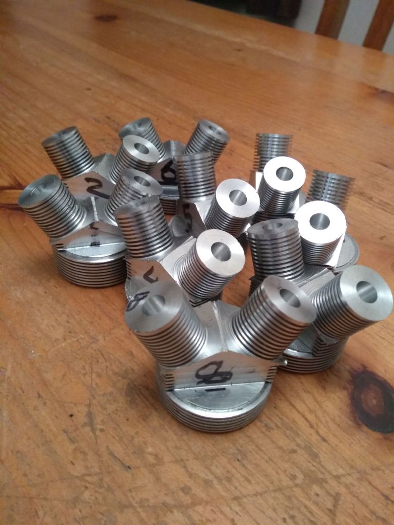

                                              Trevor Crossman 1
                                                @trevorcrossman1
                                                Well April has come and gone, along with the wind, rain and snow, I've aged a bit more and the engine has progressed a little more. I have turned all of the valve towers, counterbored the valve spring recesses and enjoyed endured the job of cutting the grooves to generate the cooling fins, all 198 of them! Only one near disaster along the way ( 2nd head ) when I forgot to open the flood coolant tap and the swarf jammed and broke the grooving tool tip, so that head has one of it's fins thinner than normal. Vertical learning curve!! Perhaps I've been a bit too​ ambitious attempting this as my first multi cylinder engine especially as it is drawn in imperial measures and I've an old metric lathe with well worn feedscrews, no DRO, and more backlash than should be seen in polite company. Next task is to make a split collet to fit the tower fins so that I can drill the valve guides and bore the recesses for the valve seats . On second thoughts, maybe sort out the machinery first! heads.jpg
