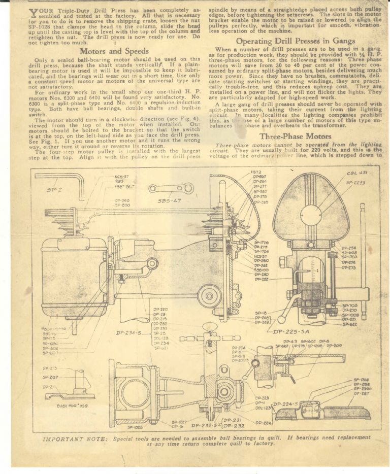

        saved this Tauco drill from the scrap man. Are they any good ? Worth restoring ?

                  The main spindle has a spline groove down most of its length, it might be two grooves, diametrically disposed, I can't remember. Then, inside the stepped pulley there's a rather odd-shaped bobbin sort of 'gizmo' that fits round the spindle – this has male spline(s) in its bore that engage with the spindle groove(s) to provide the sliding drive. This 'gizmo' is (on my Tauco) made of zinc-based die-casting alloy. When I got mine, the male splines had worn paper-thin and hadn't much life left.
                  After lots of research (no Internet in early 1970s) I found that Wilkinsons in Edinburgh had Tauco spares and supplied me with a replacement 'gizmo'. I did Google Wilkinsons a year or so ago and they were then still in business; I don't know if they still have any stock of Tauco spares.
                  Unless the 'gizmo' in your machine has healthy splines, I fear it is junk, unless you can procure a replacement or home-brew some substitute. So I suggest your first priority should be to strip off the stepped pulley and eye-ball what that reveals!
                  I believe that the Tauco drills came over to the UK from the USA during 1939-1945 WW2 as Marshall Aid or Lend-Lease. Mine has given very satisfactory service and one or two other members on this forum have them.
                  I made my own control box containing a MEMDOL single phase direct on-line starter and a forward-off-reverse switch; the box is bracketed off the motor mounting plate. I expect the starter in your photo is similarly mounted.
                  If you PM me with your email address, I may be able to find a .pdf of the illustrated parts list (aka 'exploded diagram' ).

                    An after-thought: when I was setting my Tauco to work, I turned up a couple of plastic rings bored to fit over the column and with a shallow groove on the outer surface. These are split and tightened onto the column with a Jubilee clip. One sits beneath the main casting as a safety measure and the other sits below the table knee bracket. I find this helps a lot when raising or lowering the table.

                            I've up-loaded the Tauco spares list to my album but it seems to have gone up as a microdot!
                            I hope that you can read it and that it helps.

                                    I've tweaked the gamma on the Tauco parts list to improve its readability. (Three cheers for MS Photo Editor! ) I've up-loaded this latest version to my album.
                                    It'd be nice to get some confirmation that other folks can read it.

                                      I can read it quite easily, thanks.

                                            I have stripped it down and had a look, the internal splines mentioned are in very good condition, and everything is tight, and unworn. The front belt guard is cast iron, the body casting is alluminium.
                                            Thanks for posting the parts list.
                                            All in all its a high quality tool that should give me years of service.
