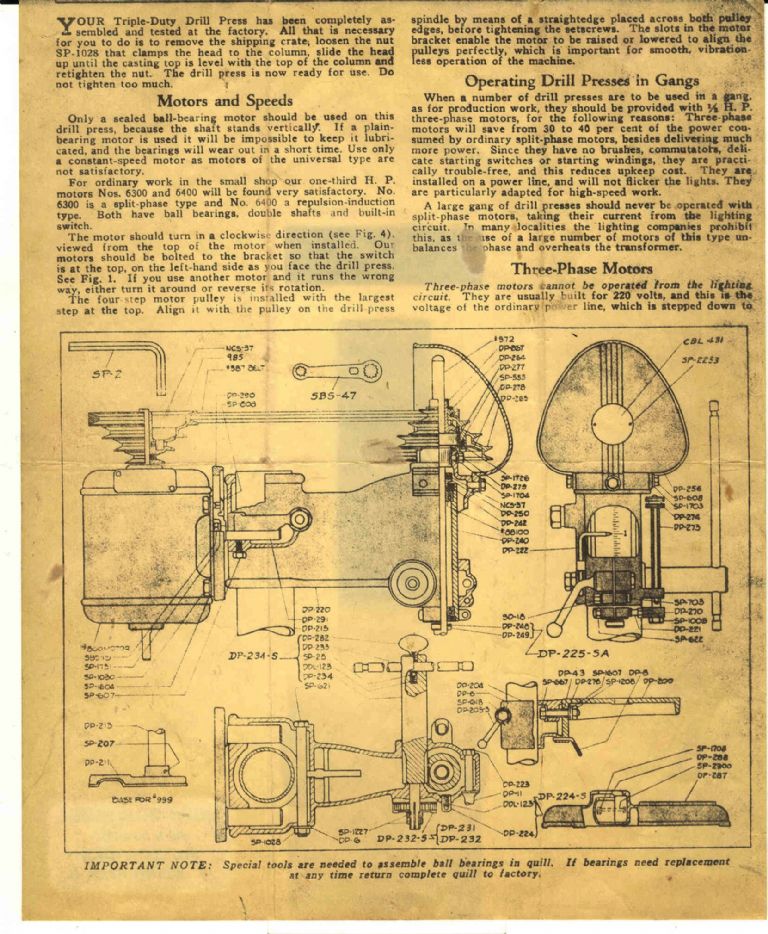

            I wonder if Wilkinsons provided you with a copy of this:
            My Tauco has a female spline in the upper spindle extension and a die-cast component with the male spline that sits within the pulley. This die-cast piece doesn't show very clearly in the diagram! When I acquired mine, the male spline had worn paper-thin but I was able to obtain a replacement from Wilkinsons.

                Thanks for that Swarf, the guy I was speaking to had a copy of that he thought on his PC but hasn’t been able to find it! My spline arrangement is obviously different to yours as my pulley assembly contains the female spline to mate with the male extension of the spindle.

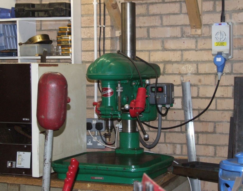

                        Posted by AJW on 07/02/2019 20:39:05:
                        I was traveling the web and found Wilkinson Machinery and Tools Ltd in Edinburgh, I contacted them and found that they still carry some spares
                        That is interesting, thanks for the info.
                        My Tauco pillar drill is a slightly different design:
                        Tauco
                        For a start it has no movable table. Instead the whole head has a rack and pinion on the side of the rear column, which can rotate around the column with the head. Given where I 'acquired' the drill I assume it was lend lease.

                            Andrew, that’s quite an adventure an unusual machine!
                            Is that a 1/2in chuck? looks smaller.
                            I guess Tauco must have produced quite a range, I know there were 2 models larger than mine.
