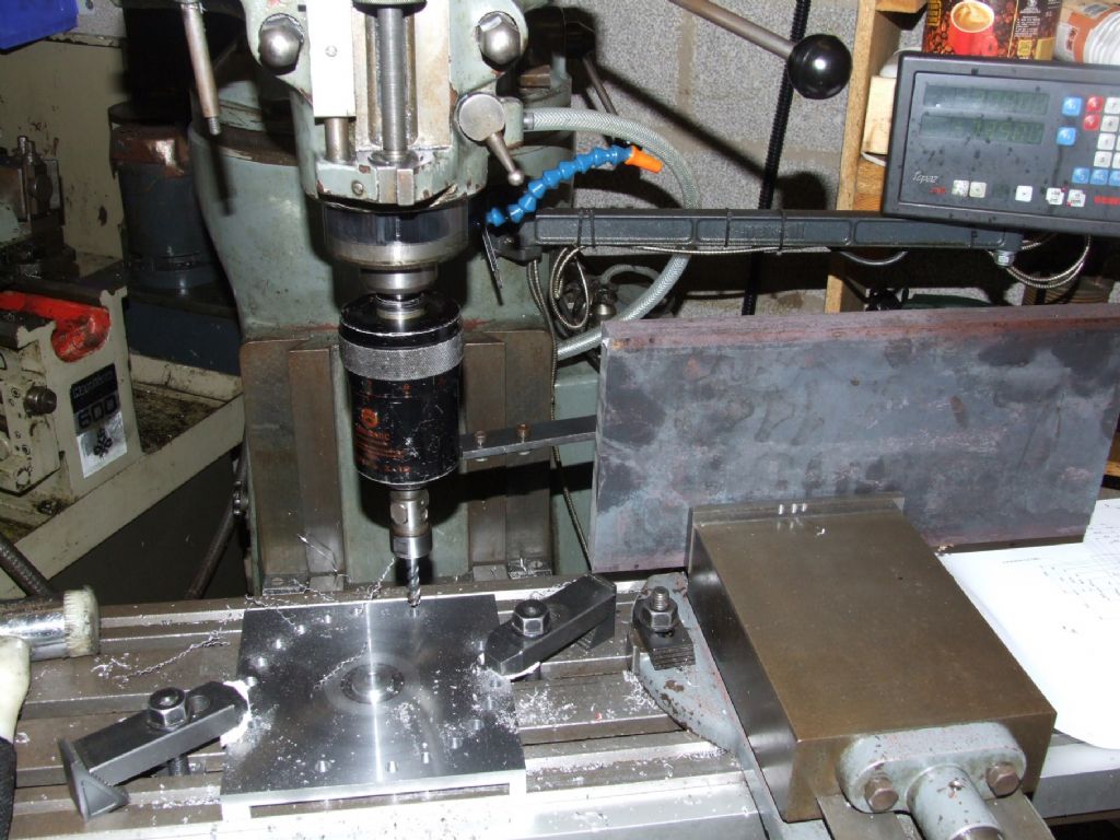

                  Now some notes from my experiences of using Tapmatic style tapping heads. The first thing you need for the Tapmatic is a stop bar; on the Bridgeport I either use a round bar in the hole in the convenient lug at the bottom of the quill housing on the right, or a convenient lump of metal bolted to the table. The stop bar counteracts the torque from the Tapmatic, it does not need to be attached to the stop arm at the bottom of the Tapmatic.
                  I set my depth in a similar way to Versaboss; through holes are less critical than blind holes. The important point is that you want the clutch in the Tapmatic to dis-engage before the tap gets to the bottom of the hole. You do not want to rely on the torque limit on the Tapmatic kicking in because the tap has hit the bottom of the hole.
                  Torque setting on the Tapmatic is a case of trial and error; think about the size of the tap relative to the range of the Tapmatic and the material to be tapped. Start low and try it out in a piece of scrap; if it slips up the torque a bit.
                  I tend to use speeds about half those recommended by Tapmatic; for M12 in EN1A I’d be running at about 250rpm.
                  The hole is tapped by using the quill feed handle, just like a pillar drill. The feed is fairly quick. The important point is that when the clutch has dis-engaged at the bottom of the hole you need to reverse the Tapmatic by moving the quill feed handle upwards sharply; don’t dilly-dally or in time you’ll wear out the clutches in the Tapmatic!
                  On low carbon steel I don’t tend to bother with cutting fluid, may be a little WD40.
                  You certainly don’t need fancy coatings on the tap for EN1A, HSS will be fine. It’s more a question of what you can buy, as a lot of machine taps will come with a coating anyway.
                  Here’s a picture of the Edelmatic unit tapping blind M10 threads on my Bridgeport. The machine vice and large lump of hot rolled steel was just a convenient stop bar; it doesn’t need to be that big!
                  Anything I’ve forgotten, just ask.

                    Andrew, from your photo, I assume that the Tapmatic unit will try and rotate in the same direction as the quill(clockwise from above), hence the position of the stop bar to prevent this. Does the unit spin around when you reverse direction to remove the tap? Or put it another way, do I need to take cover when I move the quill up smartly to start it coming out?

                      No, the torque arm stays in the same position, even when the tap runs backward!
