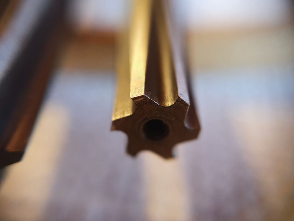

      Hi all.
      Needing a larger (10mm) taper pin reamer, I bought one from a supplier I've previously used, and who have thus far always supplied decent kit.
      It rubs, rather than cuts.

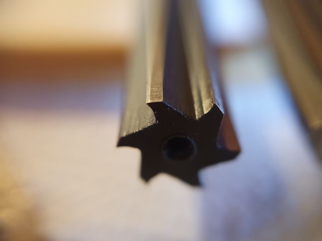

      Looking at the grind on the flutes, there is a flat that runs the entire length of each (straight) flute which is pretty well parallel to the cutting diameter. Looking at all my other taper pin reamers (all Dormer) this flat is absent.
      The new reamer:
      an older Dormer reamer:
      I also have some spiral flute reamers (not taper), and they all have this 'leading edge flat' geometry, but with the spiral shape, this falls away from the cutting edge and they perform just fine.
      I've already sent one back for this problem, and replacement came performing just as badly – I'm taking it up with the supplier again, but what should I expect to see at the leading edge?
      Cheers,
      Y.

          Does the geometry make it look like they took a parallel reamer and tried to regrind it to have a taper? Or just someone who had no idea how to set up the grinder for tapers. Probably who batch will be wrong, and now spread over 1000 vendors in 3 continents.

            No – other than that feature, it looks as I would expect – the root at the bottom of the flutes tapers along with the flutes, so I think this was meant to be a taper reamer from the start.

              It is possible that the grind was to provide both primary and secondary relief angles. On your reamer the primary relief was ground wrong.

                      Given that it's a taper pin reamer and its exact diameter is not as ctitical as a parallel reamer and given that it's a reasonably large one, I'd 'blue' the edge up with a mrker pen and then stone the flutes until the 'blue' almost disappears.

                          The flat you are looking at is called a margin and it should be 0.2mm to 0.4mm. Larger than this is probably too much and will increase the force needed to make it cut easily.

                              The supplier has agreed to a refund, including postage, so that's all good. Interestingly they say that they have sold around a dozen of that exact item and in the only one to have complained…
                              I've now found a NOS Dormer reamer, which I've bought and I'm sure will be just fine.
