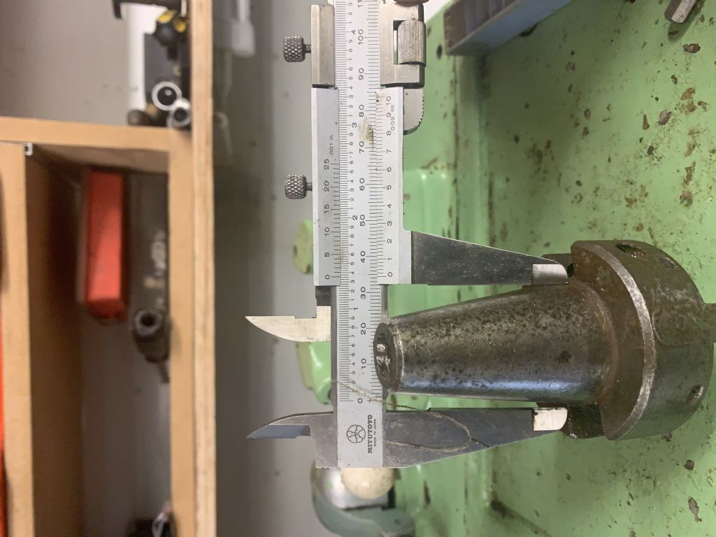

              #504121
              Alistair Robertson 1
                @alistairrobertson1
                That looks like BT30 taper. The thread in the top should be M12 i.e. 12mm x 1.75mm pitch.

                  Thanks _ i'm hoping it is, but when i look at the spec of the BT 30 it shows 31mm not 34mm as shown in my Pic.

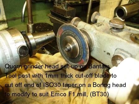

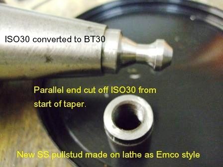

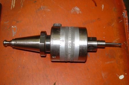

                                          You are correct Peter, ISO, INT, BT, SK all share the same taper angle, only the diameters change within 20, 30, 35, 40 and 50 types.
                                          The parallel portion on ISO and INT can be removed and replaced with a pull stud after tapping a bit deeper.
                                          Picture show an ISO30 having the portion removed and the modified part with pull stud.
                                          Emgee
