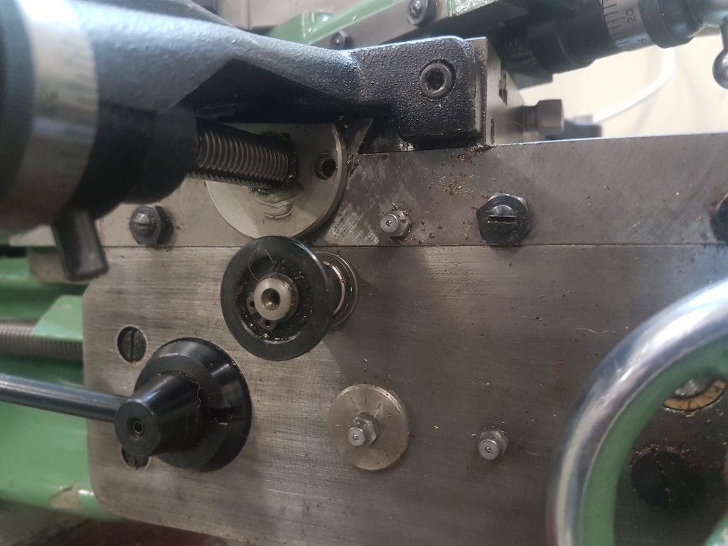

                                            I recently purchased just a standard issue Myford taper turning attachment for my Super 7 lathe and I have a general question that probably doesn't warrant its own thread. It is a power cross-feed model, and I am wondering what would be the best way to disengage the cross-slide to allow me to use the attachment?
                                            Would removing the cross-slide front bracket disengage it completely and free the cross-slide completely? Or do I need to also unscrew the feed-nut partially? I don't have the attachment yet, probably will work it out when I've got it but some advice would be appreciated if anyone could help.
                                            Myford Cross-slide

                                            #313750
                                            Tony Pratt 1
                                              @tonypratt1
                                              I just remove the 2 cap head screws holding the bracket onto the cross slide & wind the screw outwards if necessary to clear any movement of the cross slide when being driven by the attachment.
