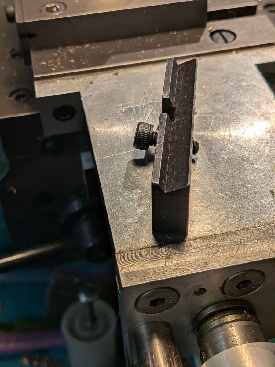

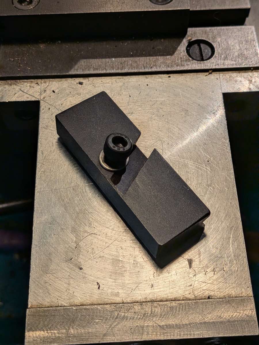

      #842241
      John Haine
        @johnhaine32865
        PXL_20260325_204651164PXL_20260325_204631297

          #842281
          Versaboss
            @versaboss
            Thanks John, if you could tell us the angles of the vee and the slot. Then a 3D-print would be easy.
            Kind regards,
            Hans

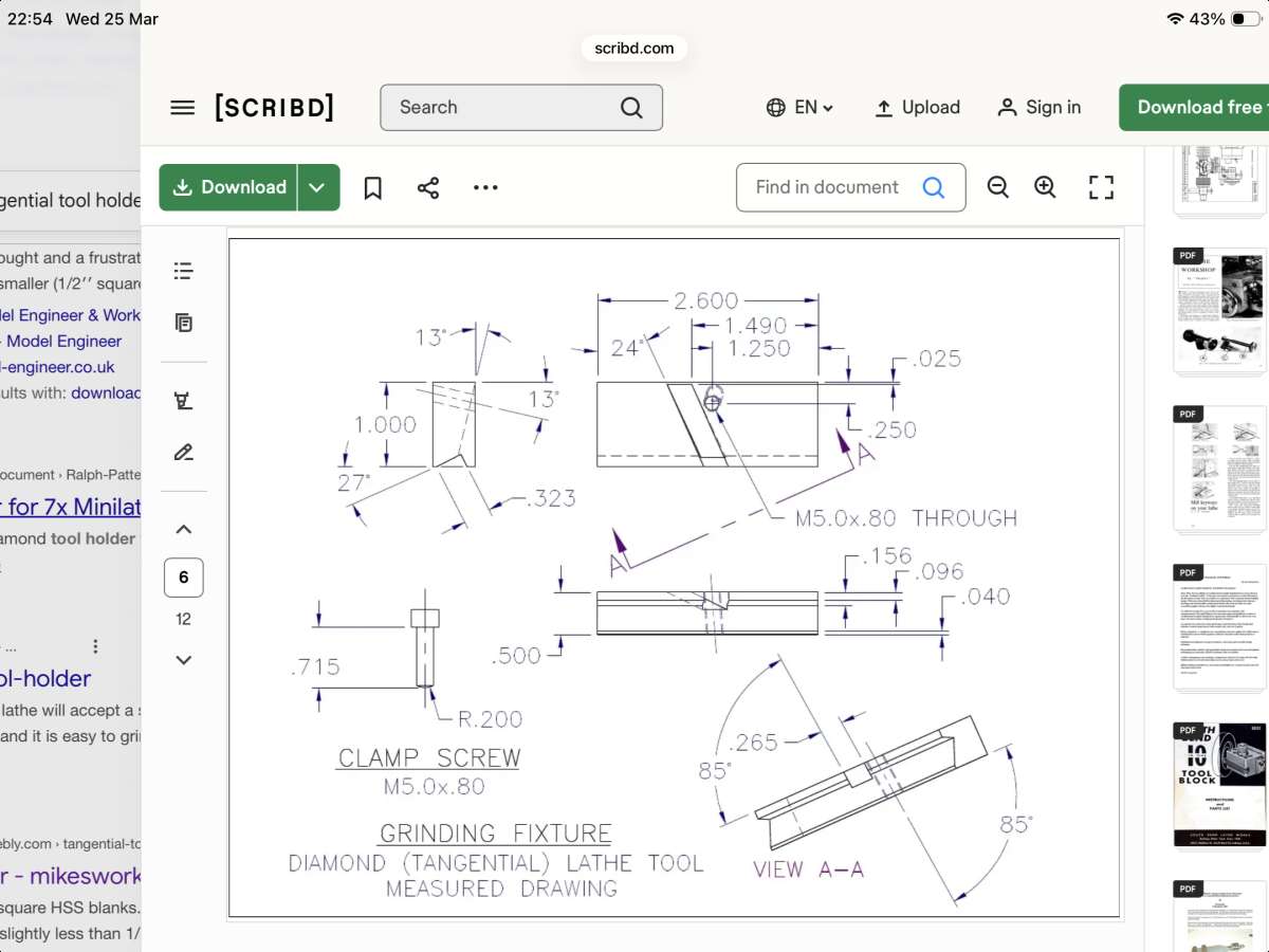

            #842283
            Dennis R
              @dennisr
              Found this drawing on the internet, hope it helps
              Dennis
              Diamond Tool Holder for 7x Minilathe  PDF  Screw  Crafts
              #842297
              Oldiron
                @oldiron
                Good find Dennis.  Thank you.

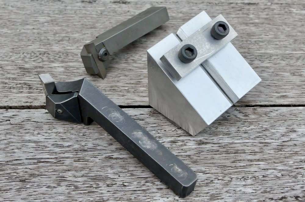

                  Vic
                    @vic
                    I never liked the Eccentric Jig. It seems to have been designed to be cheap & cheerful to manufacture? Luckily many have made their own jigs to use with shop made tools so I just copied the idea. Far nicer to use in my opinion.
                    Edit: I should have said I use it with a belt grinder. It could be used on the side of a wheel or a disc sander though.

                    #842305
                    duncan webster 1
                      @duncanwebster1
                      What’s the angle twixt vee notch and horizontal
                      #842317
                      Vic
                        @vic
                        It’s not too critical, about 30°. 😉
