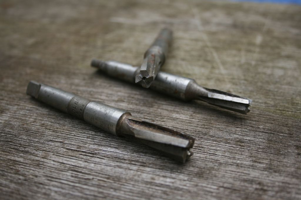

                              Hi Oliver, I think Michael Cox may be on the right track. Below is an avert from a 1963 George Hatch general catalogue, showing HSS MT counterbores with a tang, and a photo of three tanged 1 MT counterbores by F.B. TOOLS, that I aquired amoung some other cutters some while ago. You will notice the helix more akin to a reamer than an end mill.
                              I have never used these myself BTW.
                              Regards Nick.

                              #73383
                                I’d say the ones in your photo are machine reamers as they have a negative helix.unless the picture has been reversed.
                                The ones in Sparey’s book are definately mills as there is a picture of him using the vertical slide to mill a hornblock.
                                J

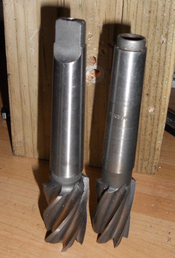

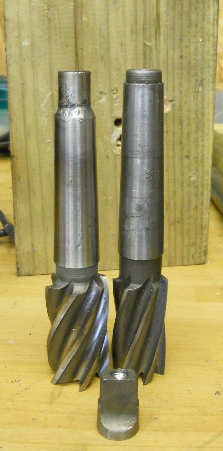

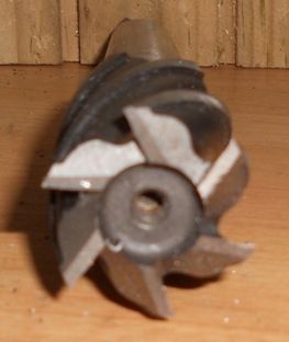

                                  thanks for all the comments. The cutter is definitely an end mill. I decided to chop the end off and weld on a bit of M10 tapped 1/2″ bar. Photos below for your enjoyment….
                                  The new and the old (in that order)
                                  end view of the mill (sorry for my poor photography skills)
                                  The modified mill next to the old one again, and the chopped off tang below

                                  Nicholas Farr
                                    @nicholasfarr14254
                                    Posted by JasonB on 14/08/2011 16:48:24:
                                    J
                                    Hi Jason, I think you may be correct about the ones in my photo. I must admit I didn’t pay any attention to the negative helix, as I’ve said I never used them.
                                    The one in the foreground is 7/16″ dia’ and the cutting edges are 15/16″ long and they all have speedicut H S. 18 stamped on them.
                                    Regards Nick.
                                    #73402
                                    Ian S C
                                      @iansc
                                      If the ones in Nicks photos are ramers there will be no cutting edges on the end . If they are end mills, they may be left hand cutting, or I just had a thought, with a reverse hellix, would that tendto push the cutter into the mandrel, rather than trying to pull it out as in a normal cutter? Ian S C
