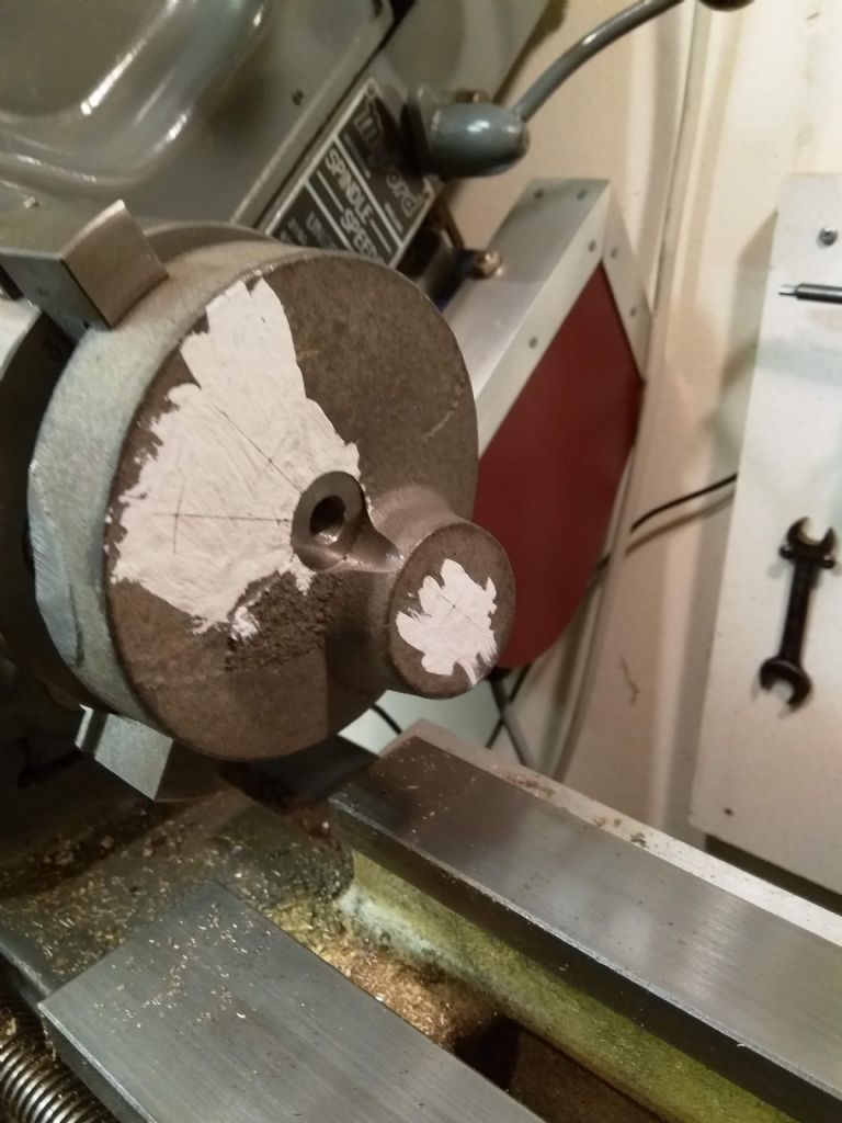

      As I'm going to build this i thought I might just as well document it as it may be of interest to others. I decided to start with the body casting as it is the trickiest then the rest must be easy! However, I've hit a snag before I've even started and that is how to hold the casting for machining. If you look at item 2 on the drawing the left hand face needs to be machined and a 2" register bored with a 3/8" tapped hole right through. I can't hold it in a chuck because of the spigot on the rhs is too large to allow the casting to sit in the jaws of the chuck.
      20170508_095508.jpgI could hold the casting in the chuck and drill and tap 3/8" from the spigot side of the casting and then mount it on a threaded mandrel, then carrying out the various machining in the lathe but I'm concerned as whether a 4" diameter casting hanging on a 3/8" mandrel is pushing my luck a it too far. It can be seen in the top left of the drawing is a suggested method of holding the casting for machining the spigot, but that's not much help for what I'm trying to do. Any advice and suggestions will be most welcome. Phil

            #524749
            Philip Rowe
              @philiprowe13116
              I hope this photo shows how the spigot is too large to allow the casting to be held in the chuck jaws.
              The photo is a posed shot with the tool holder holding the casting against the chuck.
              I am currently thinking that when this turret kit was designed and offered for sale very few ME workshops would have had milling machines and large lathes, so there must be a way of doing it using a typical 3 1/2" lathe but at the moment I can't see it, so any help very much appreciated.
              Phil
              #524765
              Jeff Dayman
                @jeffdayman43397
                Oh! I see the problem now, thanks for the photo. Very risky as shown. I hate to suggest it, as extreme care would be needed, but the casting could be clamped up to a faceplate with two parallels under the sides, each side of the spigot, to do step 1. Be sure the parallels can't slip out, and do run slow rpm. Clamps would have to be placed carefully on the outer face to allow the counterbore to be machined to full dia.
                It may be better to find a friend with a much bigger chuck to do the setup shown in the pic but in deeper jaws and with the jaws still fully in the chuck (if possible, with nearby friends and covid restrictions)

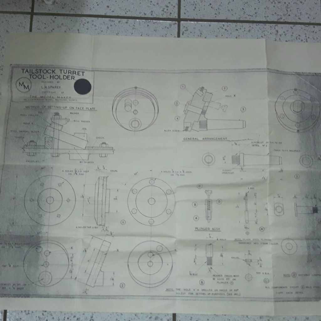

                        Posted by Philip Rowe on 04/02/2021 11:36:33:
                        Jeff, thanks for your input but the problem is with your step 1. Because of the size of the spigot it is impossible to mount the casting in a chuck, unless it is a very large one. Certainly l can't using my 3 or 4 jaw chucks (Myford sizes) l will post a photo later to illustrate the problem, when domestic tasks are finished!
                        Phil
                        It’s rather scary looking … but the solution is offered [top-left corner of the plan]

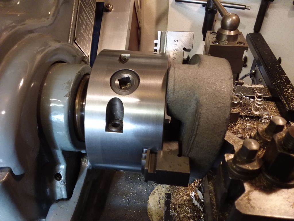

                                          #530294
                                          Philip Rowe
                                            @philiprowe13116

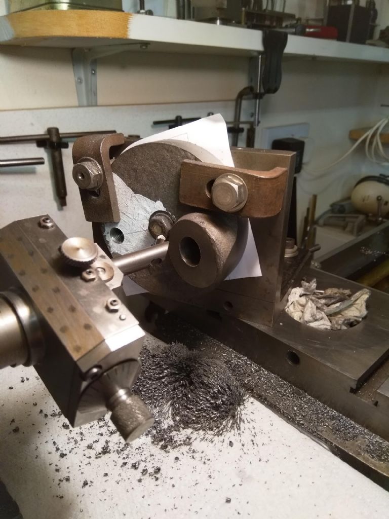

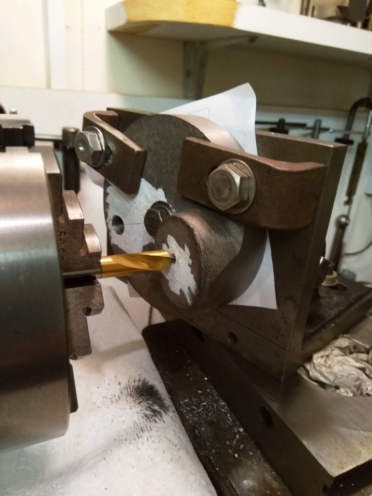

                                            The next step in machining the static casting. The casting was mounted on an small angle plate on the cross slide for drilling the tapping size for the 7/16"BSF hole but I've just found that I omitted to take a photo of that operation! Next I bolted the casting to a larger angle plate set at 20 degrees to give the required angle for MT2 arbor that whole assembly will eventually be mounted on and spotted the hole ready for drilling prior to boring. img_20210224_155232.jpg
                                            After opening out the hole with drills to about 1/2" the chuck was removed and replaced with my boring head, I used this with a suitably ground tool bit to act as a facing cutter. Because of the interrupted cut across the boss this was quite a delicate operation, but eventually I was happy with the surface finish. I'm afraid that I chickened out of screw cutting a blind hole in the boss and I've decided to secure the arbor to the casting using a high strength loctite, I'm quite confident that this will be satisfactory for the type of usage that I will be putting the tailstock turret to. Putting the boring head to it's more usual function the hole was opened up to the finish size of 5/8". Again i forgot to get a photo of the actual operation and the following is a posed shot taken later.img_20210225_161555.jpg

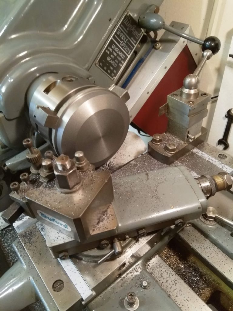

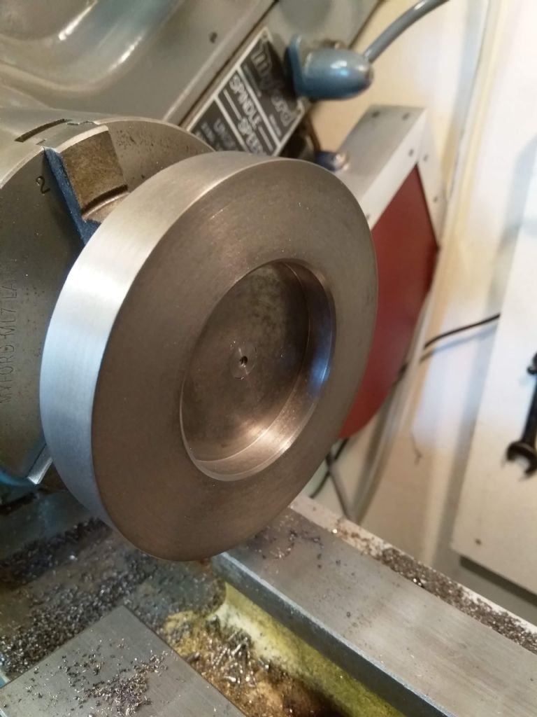

                                            #532357
                                            Philip Rowe
                                              @philiprowe13116

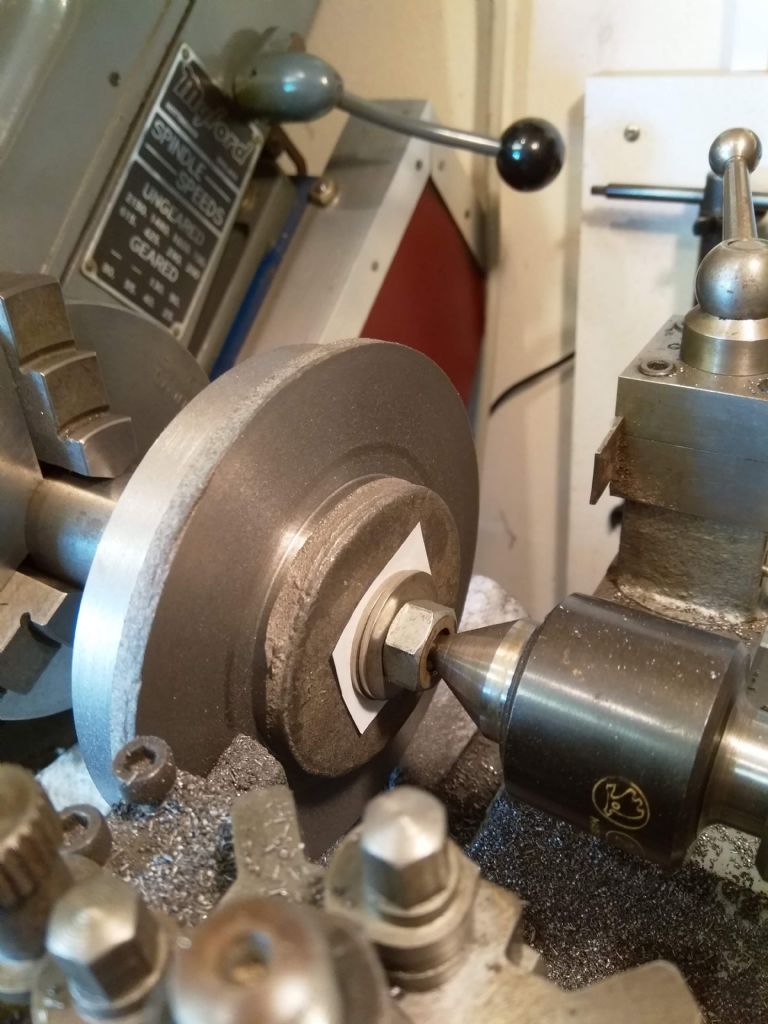

                                              So the next stage with this turret is machining the rotating casting, a great deal of head scratching and thought was required to enable me to machine this and maintain concentricity where it matters. The raw casting was mounted in the three jaw chuck using the outside jaws and the outer face of the casting was machined to size, the 20 degree tapered section was a minor problem as swinging the top slide round to achieve the angle meant the feed handle was fouling on the cross slide, so I had to remove the handle and replacing it with a convenient piece of scrap to enable me to rotate the feed screw. The part of the casting underneath the jaws that can't be machined at this stage will be removed later as concentricity is not important here as this area is just knurled to provide a finger grip. img_20210301_143016.jpg
                                              The next stage was reasonably easy, the casting was drilled about 10mm dia and then opened out to finished size with a boring bar, there was a lot of spring in the bar so multiple passes at each setting were required before finishing with a 1/2" reamer. img_20210301_155713.jpg
                                              The piece of paper towel has a weak magnet behind it to collect the worst of the iron dust but l won't be sorry when all the machining of the castings is finished it really is messy stuff!
                                              Phil

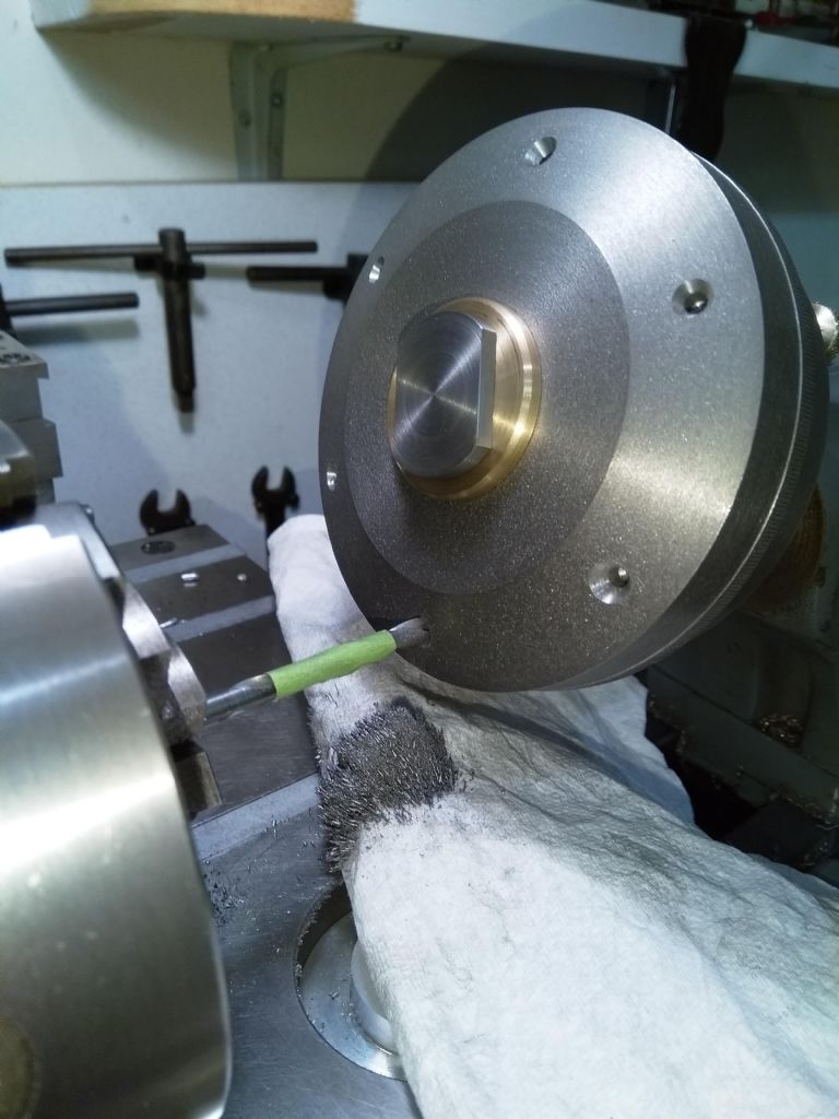

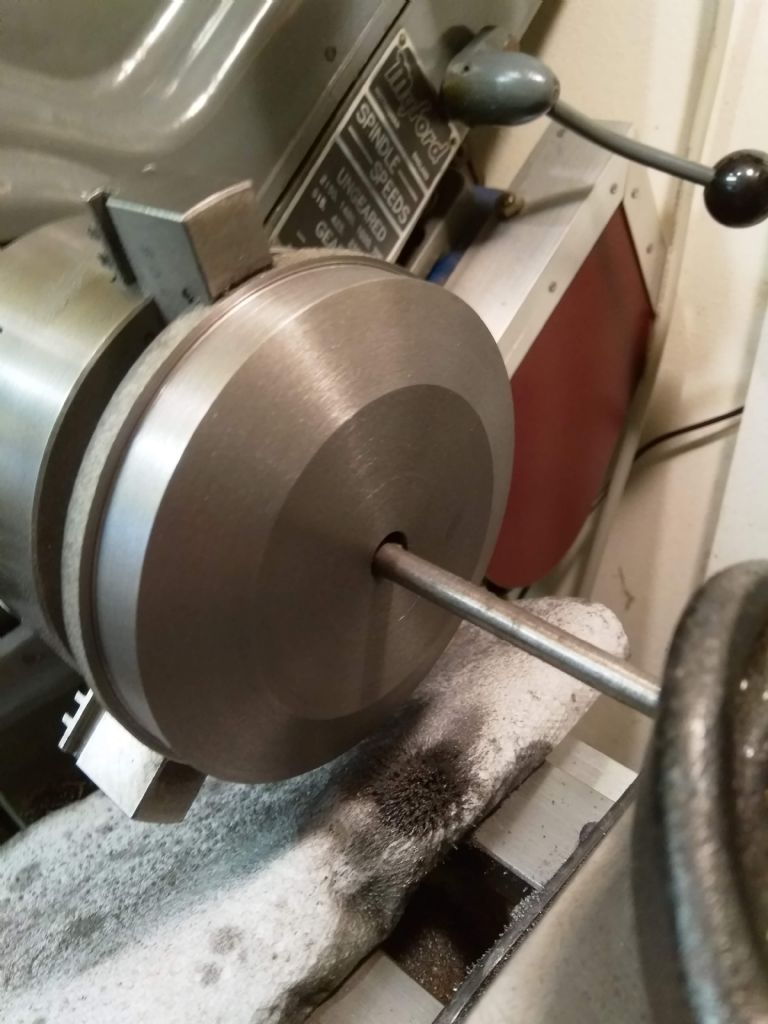

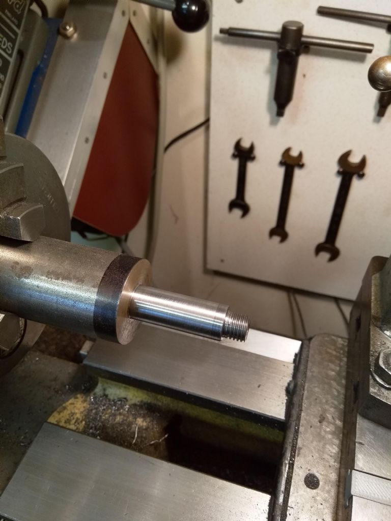

                                              #535015
                                              Philip Rowe
                                                @philiprowe13116
                                                The next stage was to make a mandrel to mount the rotating casting on to machine the reverse side. This was made from a chunk of 1 1/4" b.m.s. which when this duty is finished will be modified to become the securing bolt that holds the two castings together.
                                                img_20210308_144511.jpgAs I had turned the mandrel to be a very close fit in the bore of the casting i was more then pleased when I could not detect any runout of the casting when it was reversed to finish the machining.
                                                img_20210307_145937.jpgNext will be the drilling of the detent holes on the rotary table.
                                                Phil

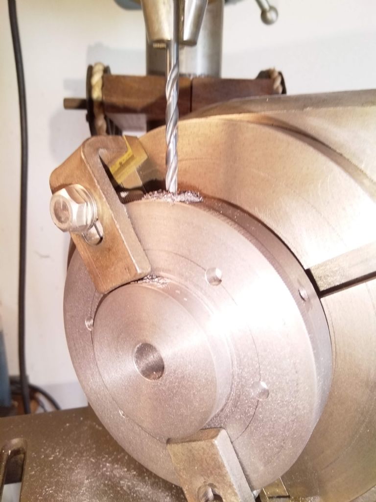

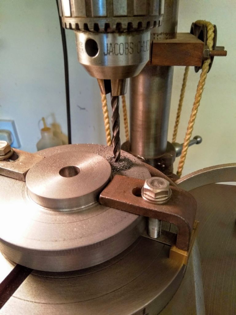

                                                #538680
                                                Philip Rowe
                                                  @philiprowe13116
                                                  Here you can see the rotating casting mounted on the rotary table on the drilling machine to have the six detent holes drilled. If anyone is wondering, the cords each side of the drill column is my crude method of counterbalancing the weight of the drill table. Its something that I rigged up in a hurry probably 30 + years ago and have never got round to improving but as they say "if it ain't broke don't fix it ". As you can probably imagine the drill table, rotary table and the casting being drilled all cast iron is quite a weighty lump to manoeuvre around, so I was quite glad of the counterbalance no matter what it looks like.

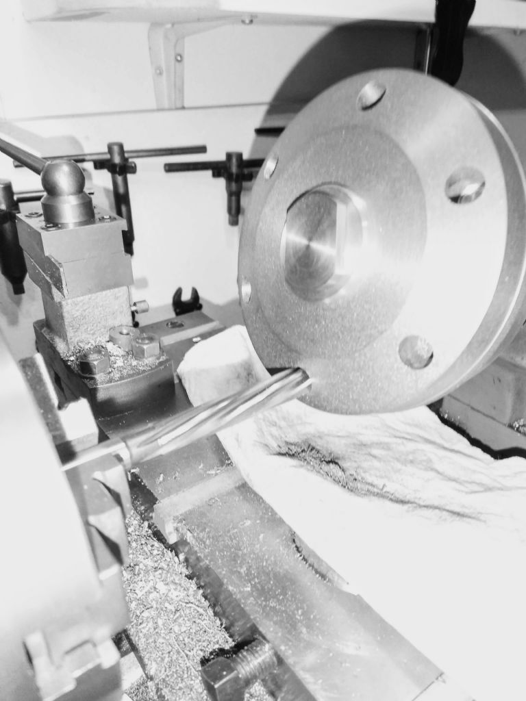

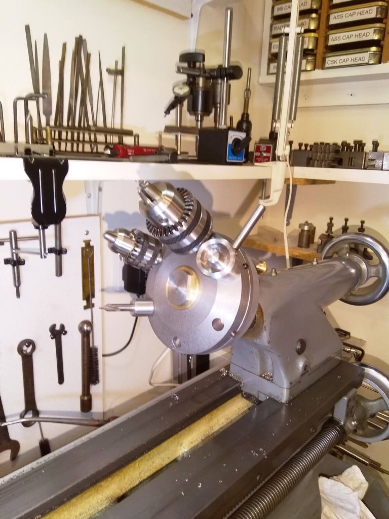

                                                  #539849
                                                  Philip Rowe
                                                    @philiprowe13116
                                                    Having finished the turret a few days ago I've realised that I've not been keeping this thread up to date, so to continue.
                                                    I assembled the turret and mounted it in the tailstock and utilising the spring detent l was then able to rotate the front casting to pilot drill the six holes required for the tool holders.
                                                    Having opened these holes up to 3/8" reaming size l discovered that my only machine reamer of that size was blunt on the tip, for a hole only 5/8" deep a sharp one was paramount, so I had to wait a few days whilst a new one was ordered. Note to self – check these things beforehand!
                                                    The final machining operation on the casting was to drill the six holes on the periphery for the locking screws that will retain the various adapters and toolholders. This was done with my rotary table mounted vertically on the drilling machine.
                                                    Having tapped the locking screws holes, the turret was then reassembled and fitted with some of the adapters/ tool holders that I'd previously made for the final photo.
                                                    Having spent all this time making this turret l really wonder how much use it's going to get, but that aside it has been a very interesting exercise although I'm not impressed by how much time I've had to spend since in stripping and cleaning the lathe to remove all the cast iron dust.
