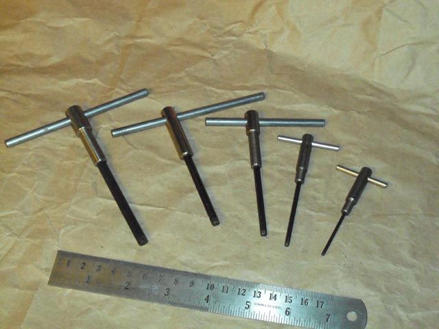

                                          That's a neat idea. How did you secure the hex key into the handle? Would make a good beginners project.

                                                  Beginners project is correct. I made them over 10 years ago when I first started. Handles are drilled with a hole the same size as the hex AF size and the key ( with the angled piece cut off) knocked or pressed into the hole. I wasn't sure at the time, how successful it would be, but they have lasted all this time. The 6mm one is used all the time on my mini-lathe tool post. A good exercise in basic turning and cross drilling.

                                                    I did a three afternoon workshop course as part of my Physics degree over 50 years ago. One of the exercises was to make a T-shaped Allen Key Holder on lathe. I think that I must still have it somewhere and my executors will find it when they clear the house!
